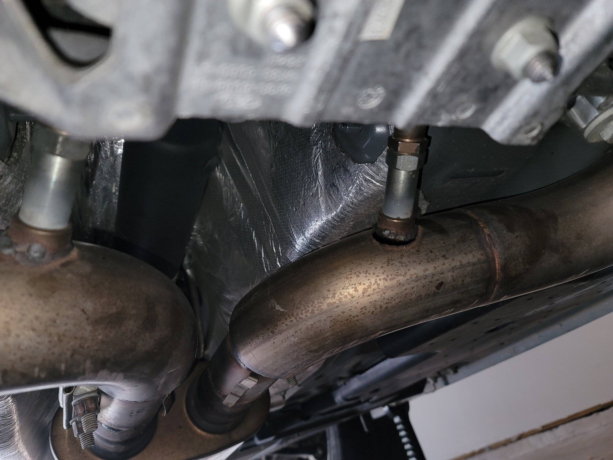

Currently making about 800 whp and my setup is:
1 7/8 catless headers (bottle resonators in place of cats) ➡ 2.25 factory connect ➡ magnaflow tru-x resonator ➡ custom 2.75 connecting pipes ➡ borla s-type mufflers
I had one of my welded rear O2 bungs blow out a couple months back during a pull and based off this thread I believe this was due to excessive pressure build up right before the factory connect neck-down (@engineermike, any thoughts on this?)

Hey Muffin, check out the Borla S-type with the 2.5" 60661 resonator. It's actually a very civilized system even without the big restriction (cats) and because it is dual 3" (besides the resonator) it flows so much better than the previous Magnaflow resonated X. When I removed it to install the new exhaust the body of the resonated x was heat checked, so much so that you could see where the exhaust gases were merging from the outside of the shell. That tells me that it was a huge restriction and that it was generating a lot of heat once I added the SC. I had it on my car from when it was NA and it never looked like that before I added boost.
