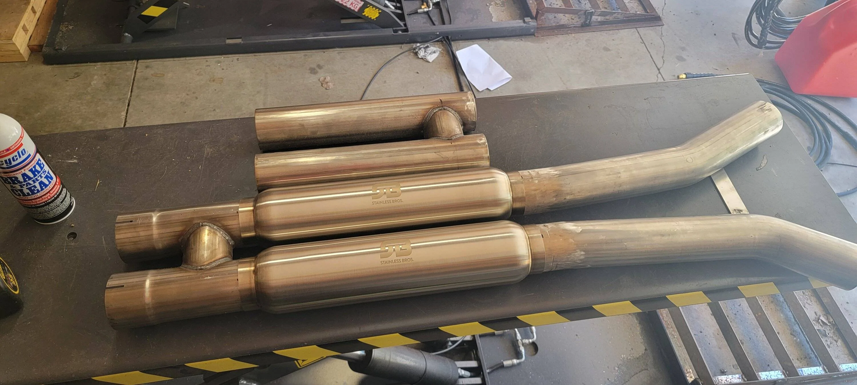

I was torn between the bottle style resonators and the stainless bro dual in dual out for my exhaust. I decided just for the simplicity of install on the bottle style. I ordered two stainless bro 3" x 18" resonators. I dont need a crazy amount of volume control with my active exhaust so im hoping its enough for me.

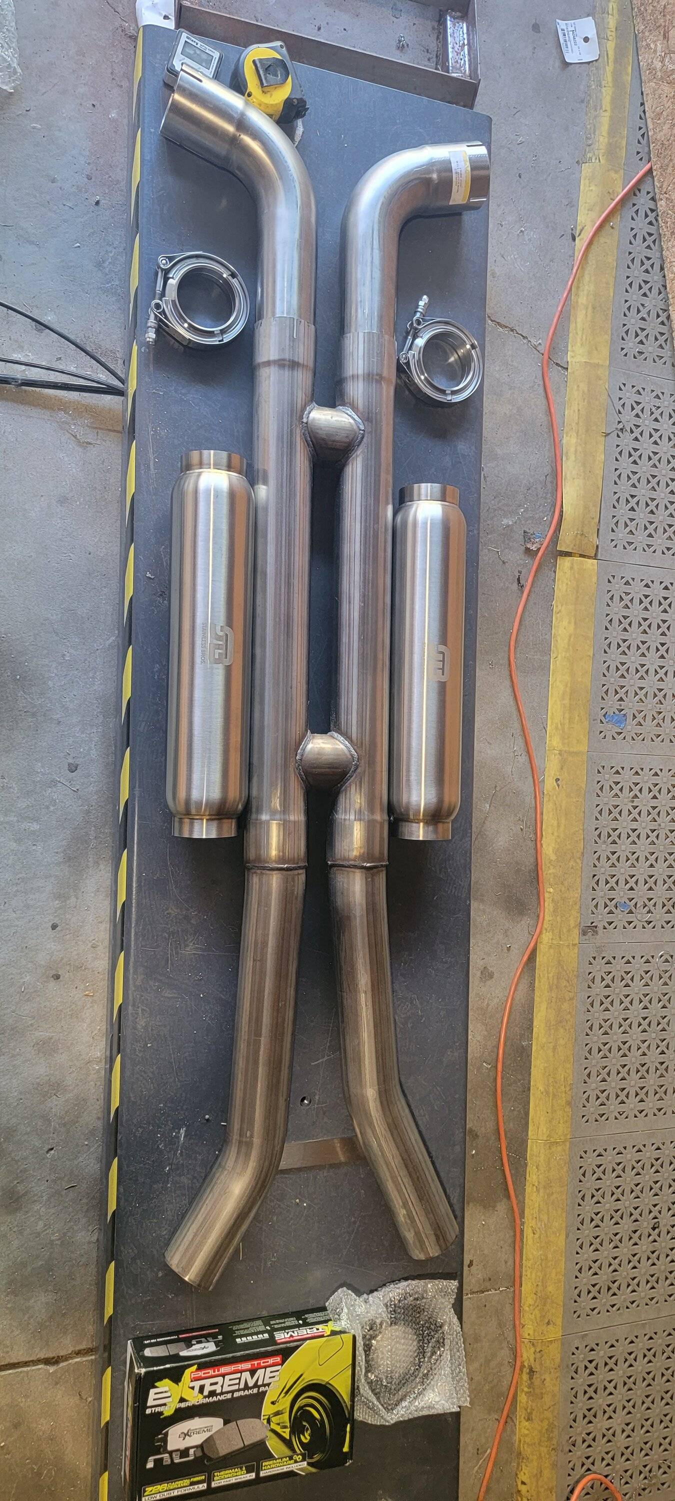

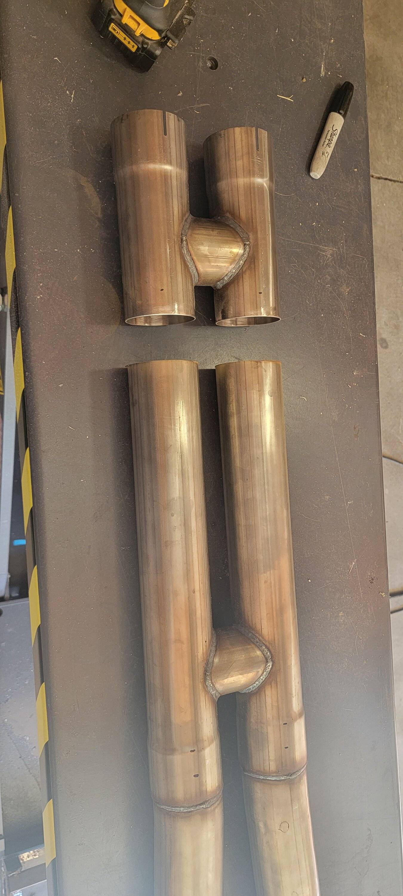

Provided my local guy has some free time saturday i hope to get this done and on
3" x 18" stainless bro resonators on a lethal double h pipe (deleting the rear h) and v banding the front connectors.

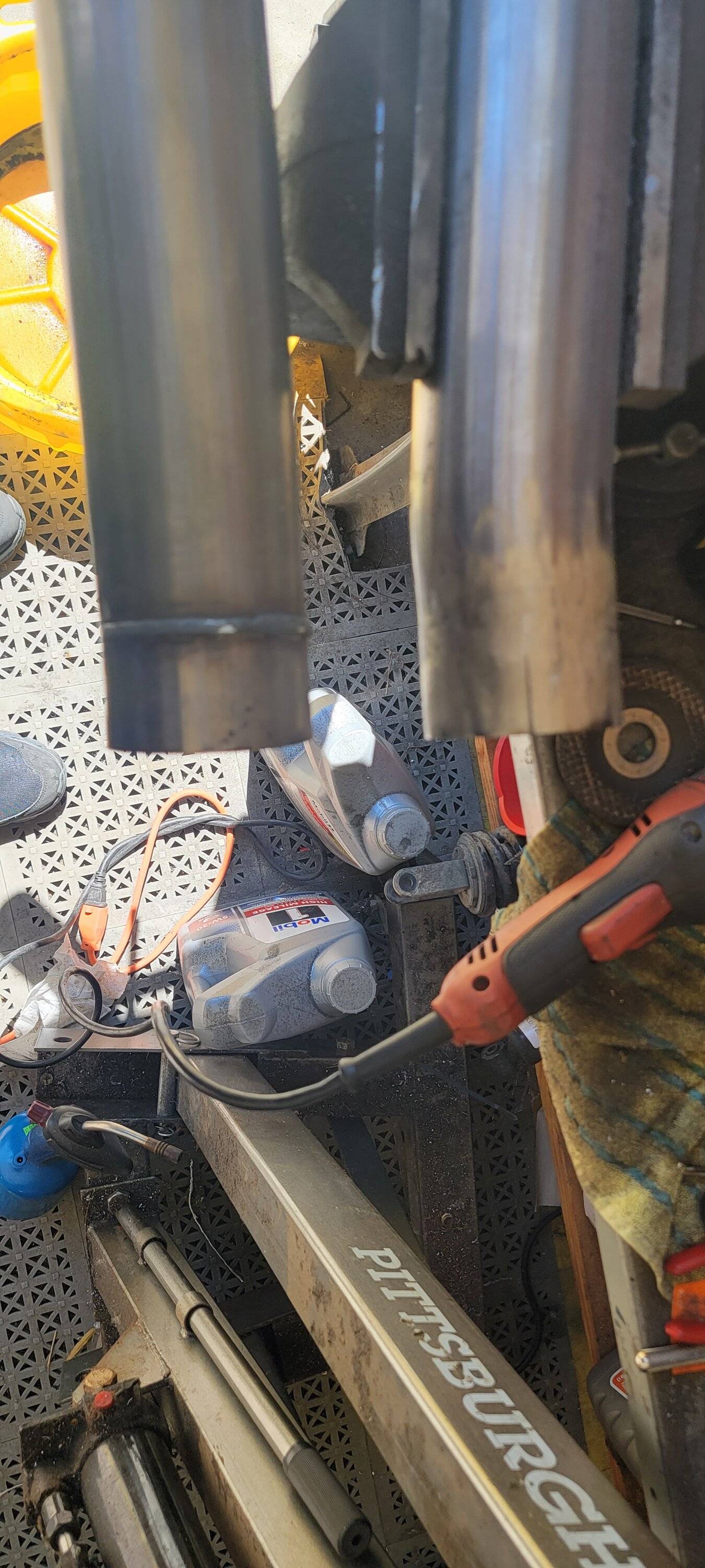

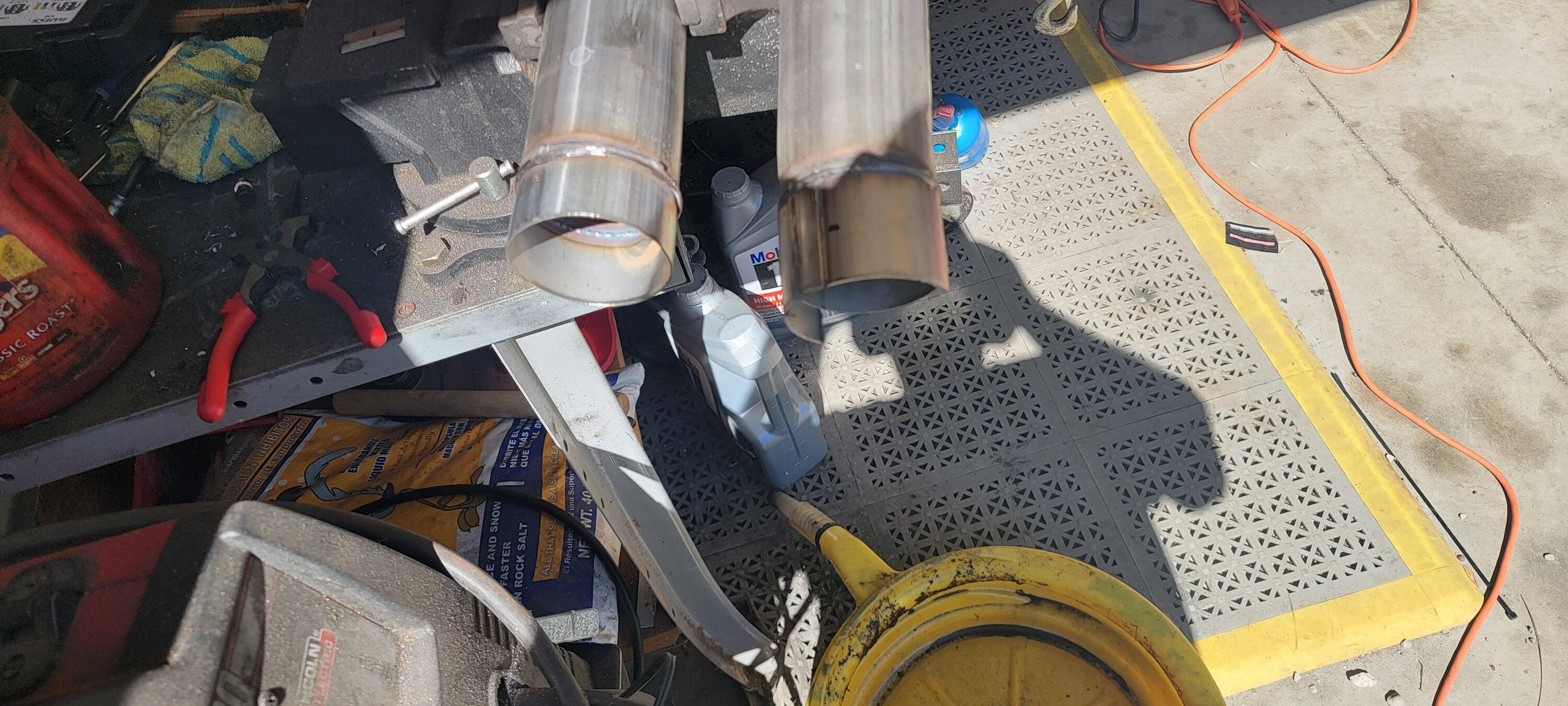

Got the resonators welded up however i kinda want to have the front of the system v banded. Need to get under the car to figure out how/if i am going to do it.
