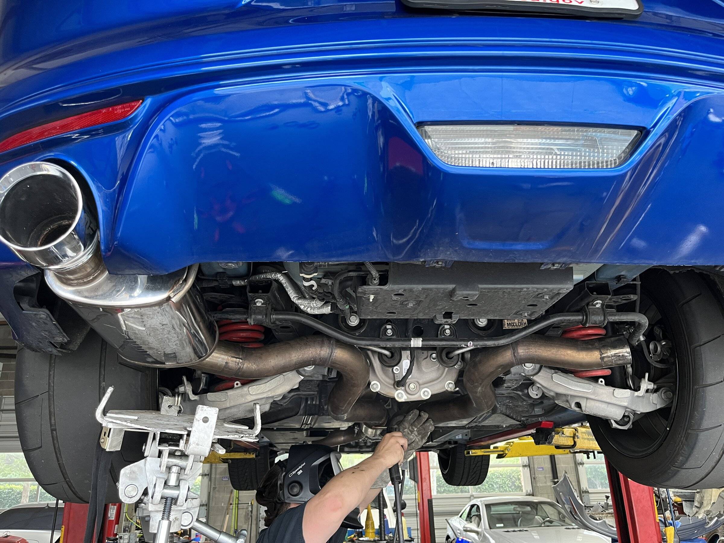

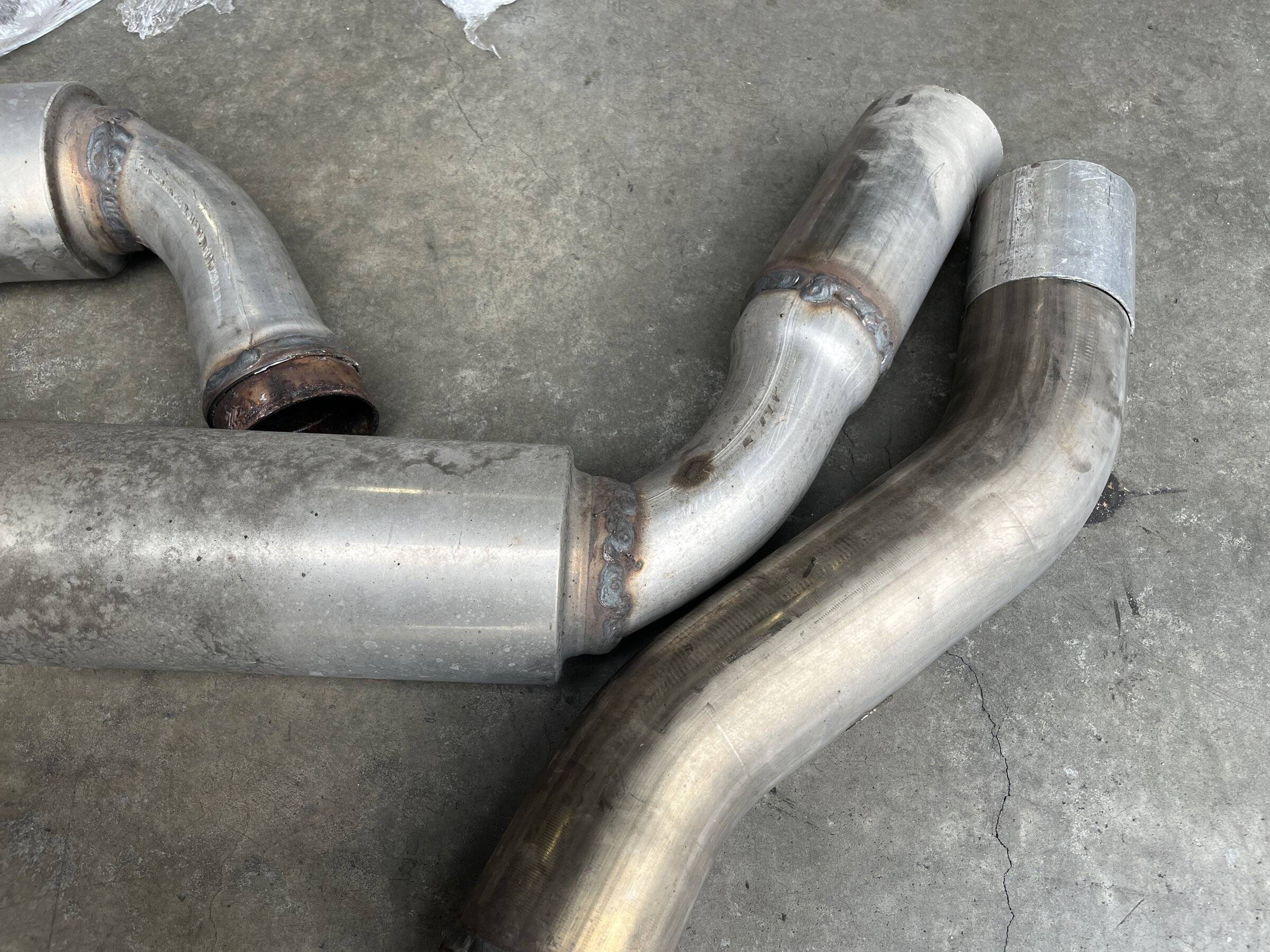

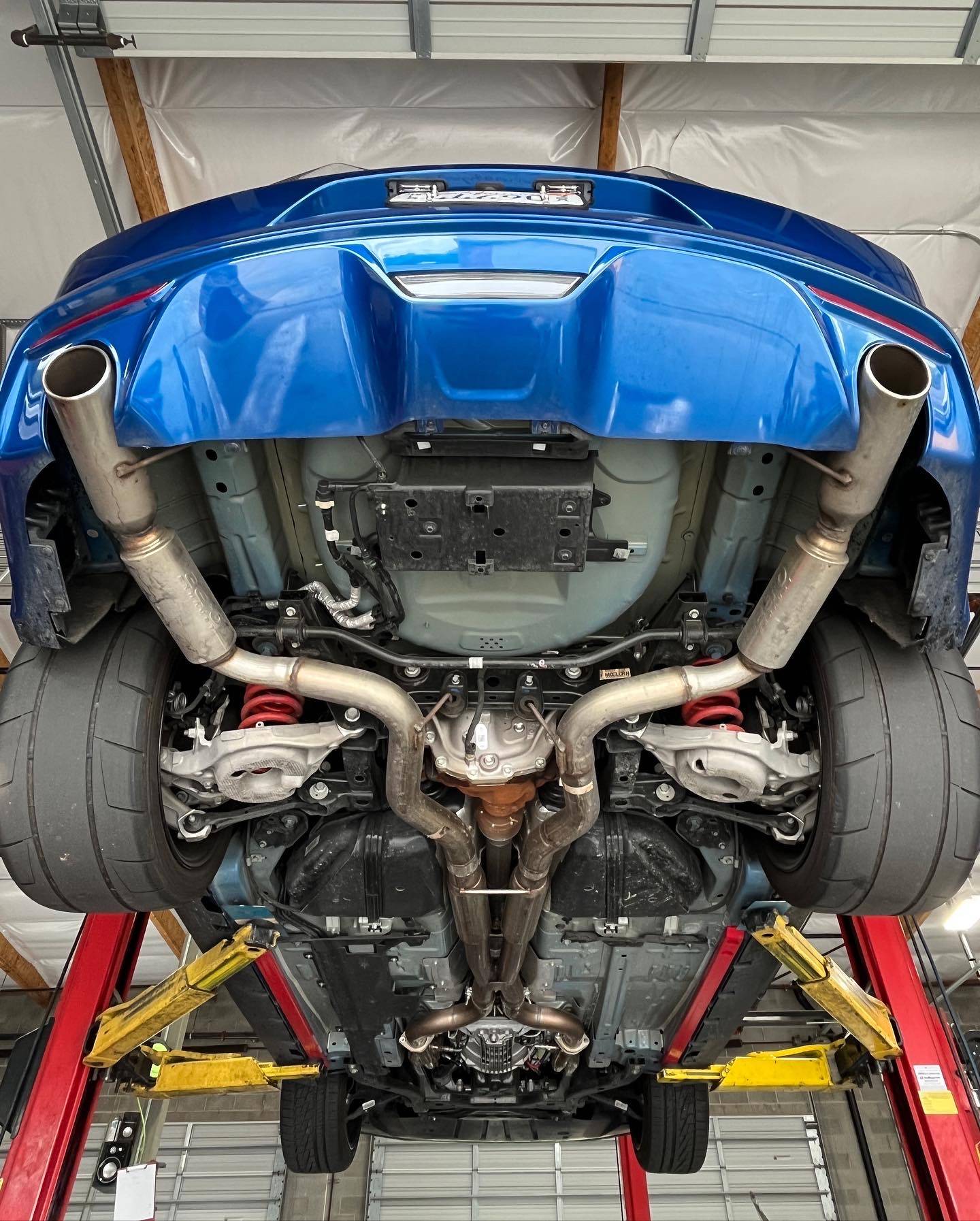

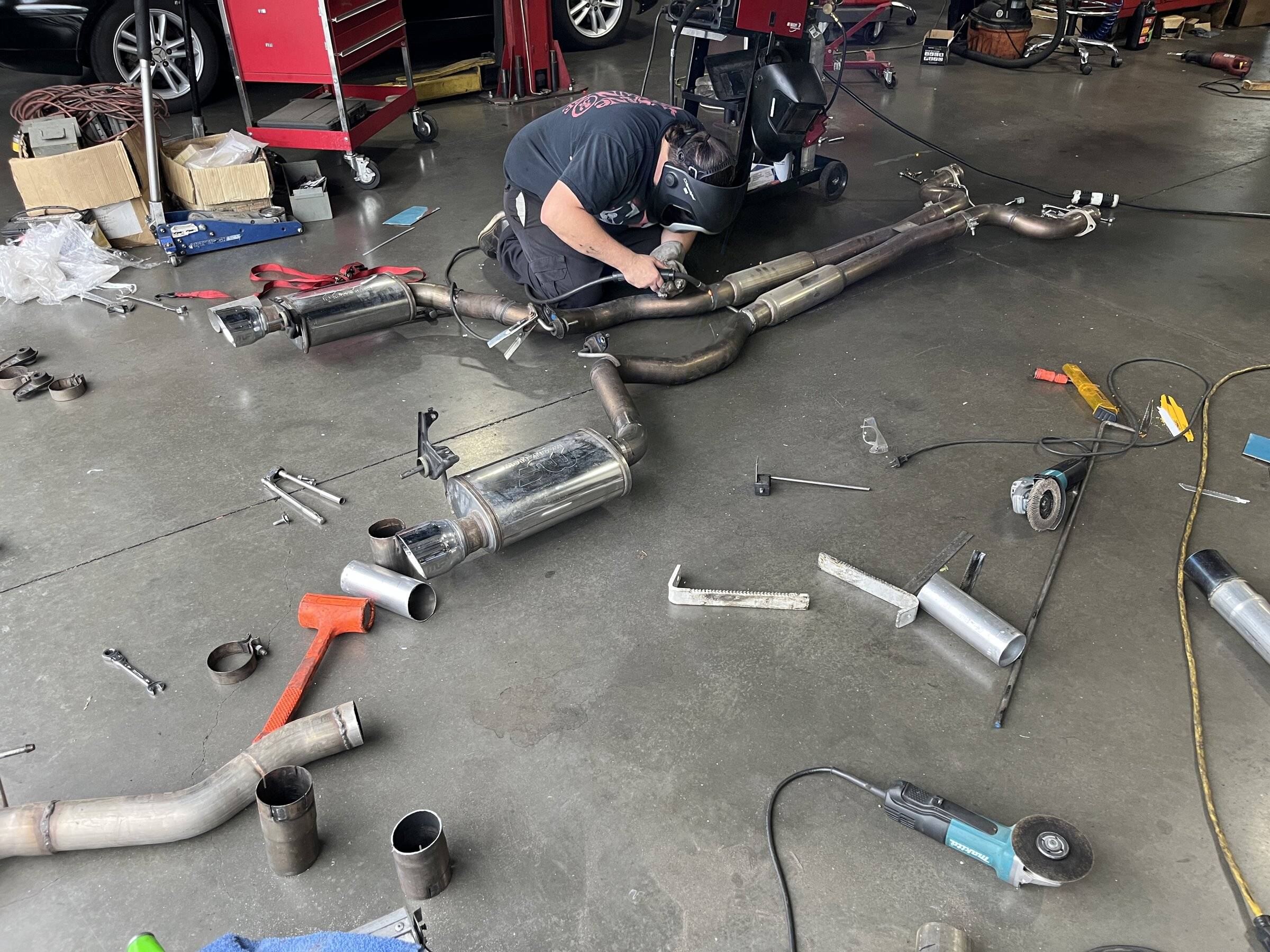

I finally fixed my exhaust per this thread. 100% 3" all the way now. the most amazing discovery after the fact was how much quieter it got with proper mufflers, despite eliminating two 2.5" bottlenecks. Proper mufflers >>> resonators, that's for sure.
Power testing to follow.

The resonators right after the x are different ones, full 3". Not re-using the 2.5" bullets
That’s right I forgot they were 2.5” before. I see the mufflers are MF what brand are the bullets?

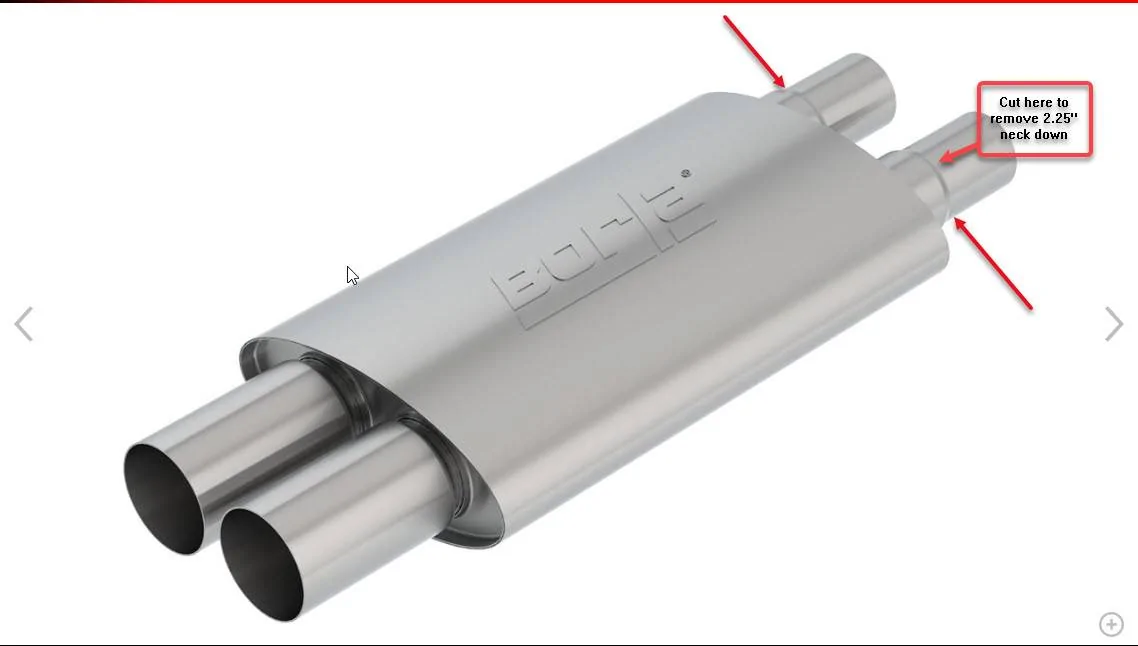

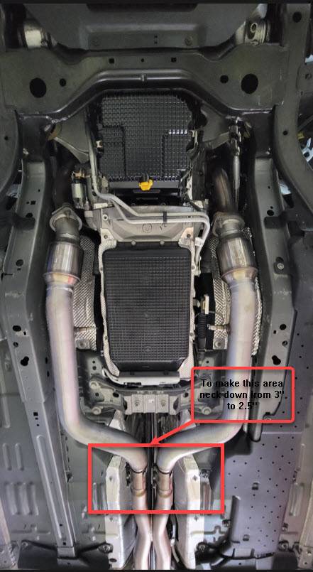

I just recently upgraded to a 3" Borla S-Type exhaust paired with the Borla resonator 60661, which has 2.25" dual inlet made to mate with the factory connect pipes with 3" dual outlet with an internal diameter of 2.5" with an integrated H-pipe. I currently run this in combination with the 3" MAK free flow pipes that neck down to 2.25" to mate with the factory exhaust.
My question for you good sir is this, do you think it would be enough of flow improvement to be worth the effort to remove the 2.25" connections and go straight from the 3" portion of the MAK pipes into each of the 2.5" inlet on the resonator using the 3" to 2.5" reducers shown?
Right now the biggest restriction is the 2.25", so if I change it the biggest restriction will be 2.5" going into and out of the resonator.
