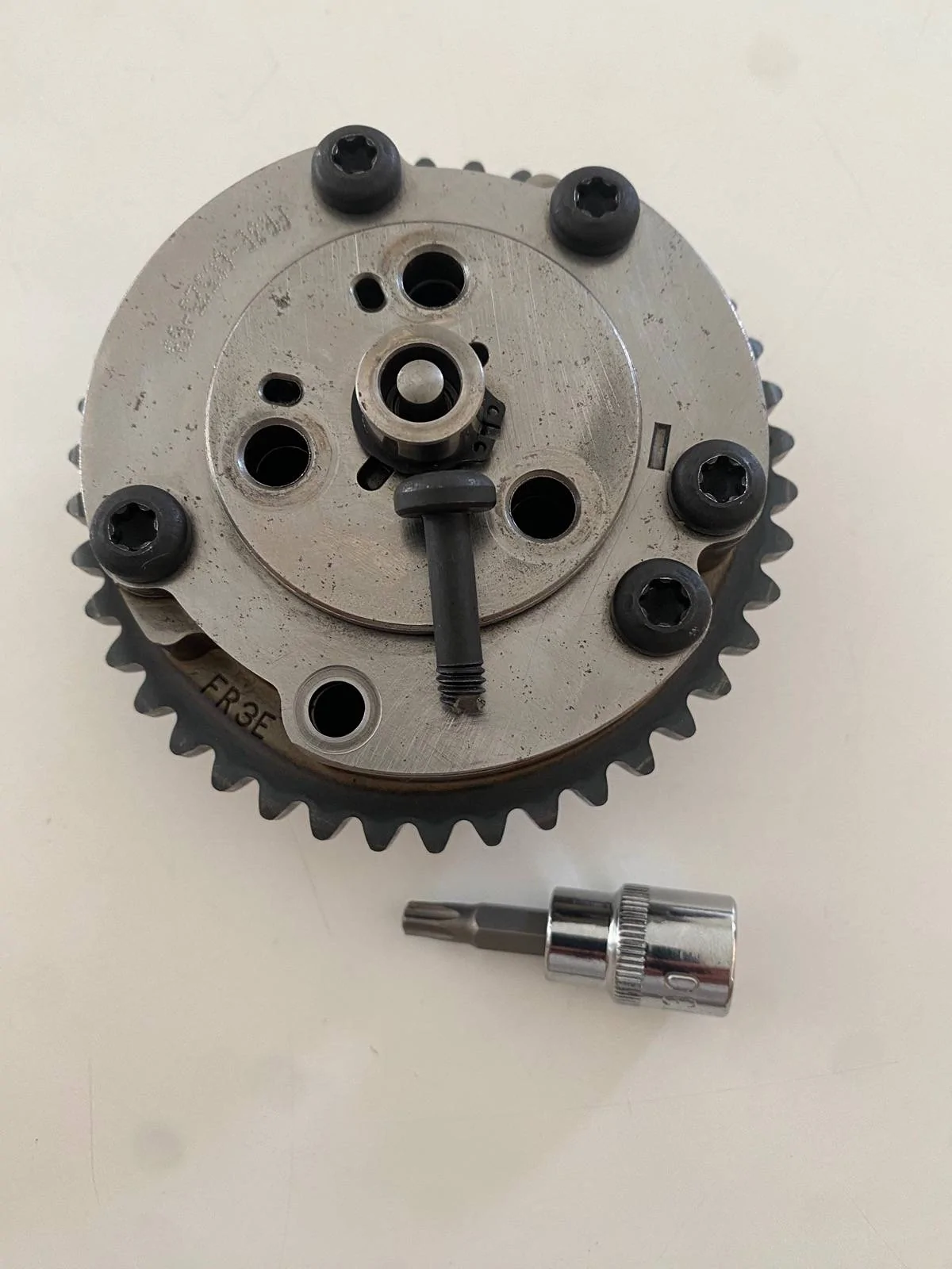

ive Run into this , brought new arp hardware that you only use half the packet. Due to the need of left hand thread on exaust phasers.
What’s the solution ??? Ford doesn’t sell the bolts…… Who sells the left hand thread ones ?? I just can not find anything.
EDIT. The 6 outer bolts. I removed the broken one after my brain fart.

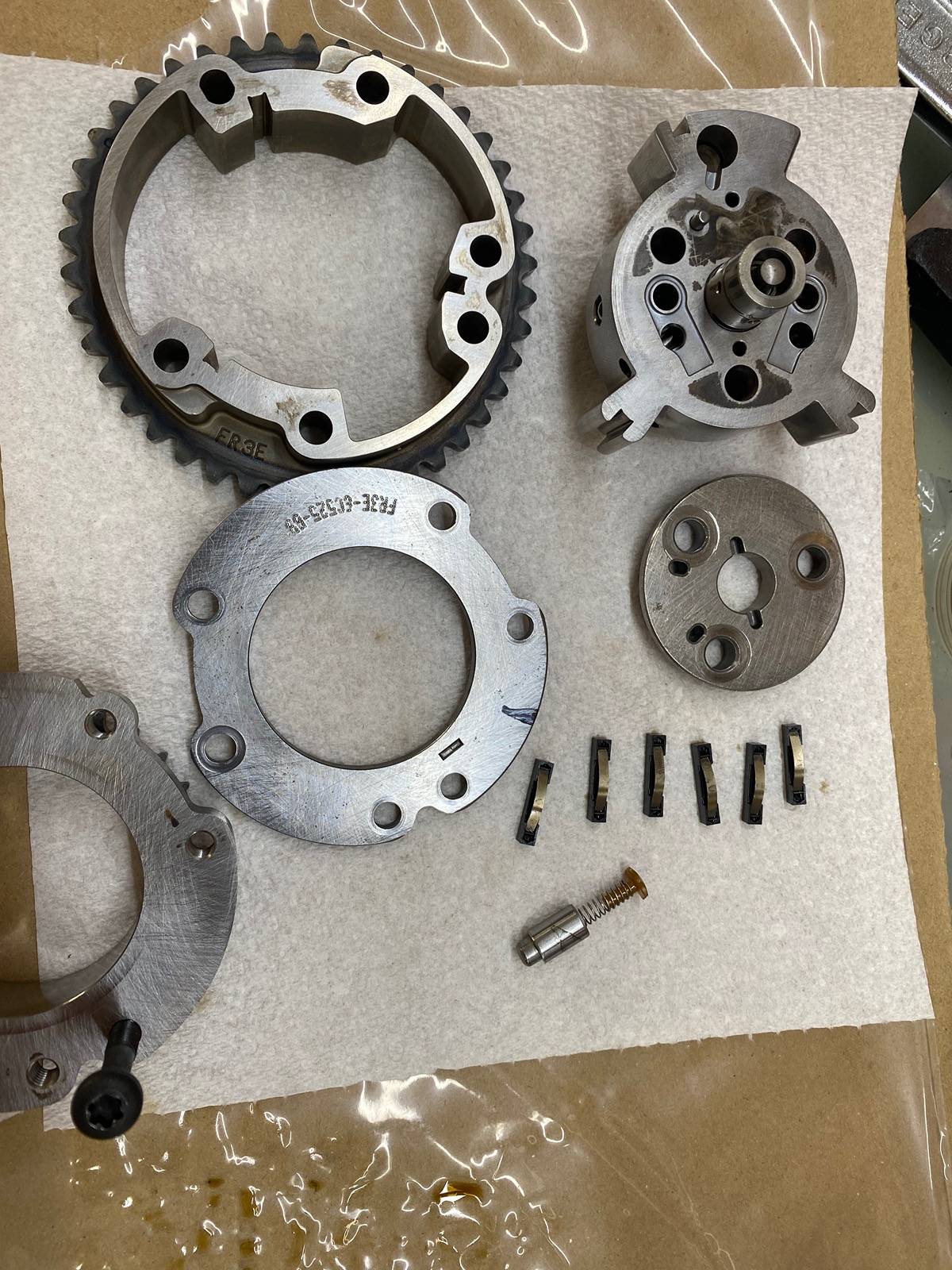

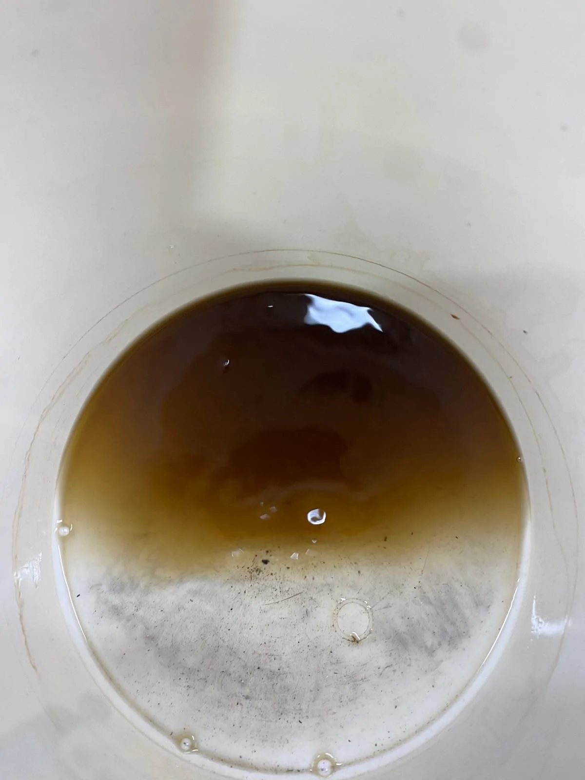

there not to complicated , and as you can see this is the result of cleaning one phaser. Plenty of carbon and powered metal from engine killing itself. The cam filters can only catch so much and i didnt want to run the risk of any crap getting into new sleeved , built motor.
so probably best to have new ones anyway.
