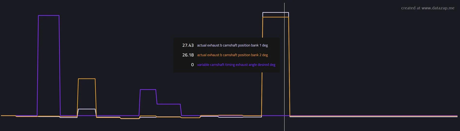

I logged pids for actual vs desired, and see weird stuff with exhaust cams, particularly on bank 2. This was just revving and i plan to do proper data log with real load, but oil pressure is good, oil levels are good... car is just all over the place. I've had engine die on me only once, but sometimes it runs incredibly, sometimes it runs not so great and the exhaust note sounds... different.

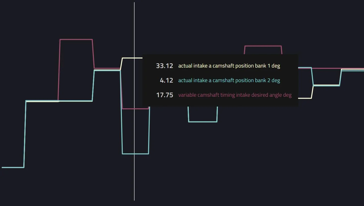

For intake desired vs actuals

i had bank 2 exhaust cam timing issues, replaced chains / VCTs / phasers and tensioners. Working ok now. Both inlet cams should be on similar timing to each other and both exhaust cams should be similar to each other. My mechanic did say the exhaust cam timing was more active and revving at standstill was easy to activate the timing whereas the inlet cam timing seemed to be further up the rev range (i dont have rpm ranges for examples)

The log seems to be missing engine rpm and exhaust phaser duty cycle, plus the data rate is pretty bad. But based on that, yes, the bank 2 cam angle appears to be not tracking well. Duty cycle and VCT schedule parameters would tell more to ensure the logic is actually is in the correct mode and trying to correct it.

If you focus on exhaust:
rpm
time
exhaust desired angle
exhaust actual angle bank 1
exhaust actual angle bank 2
exhaust phaser duty cycle bank 1
exhaust phaser duty cycle bank 2
vct schedule
oil pressure
Change it to 10 ms and see how it does. Maybe log it through a few revs and see what happens.

Also, for intake stuff... Can anyone explain why it almost seems like bank 1 in the graph is significantly above desired and bank 2 is below or vice versa? It almost seems like something is working the opposite way it should

To be honest, that dataset and format will be really hard to draw conclusions from. HPT VCMScanner is much better for this kind of thing. Based on the data, the intake didn't look that bad like the exhaust did.
