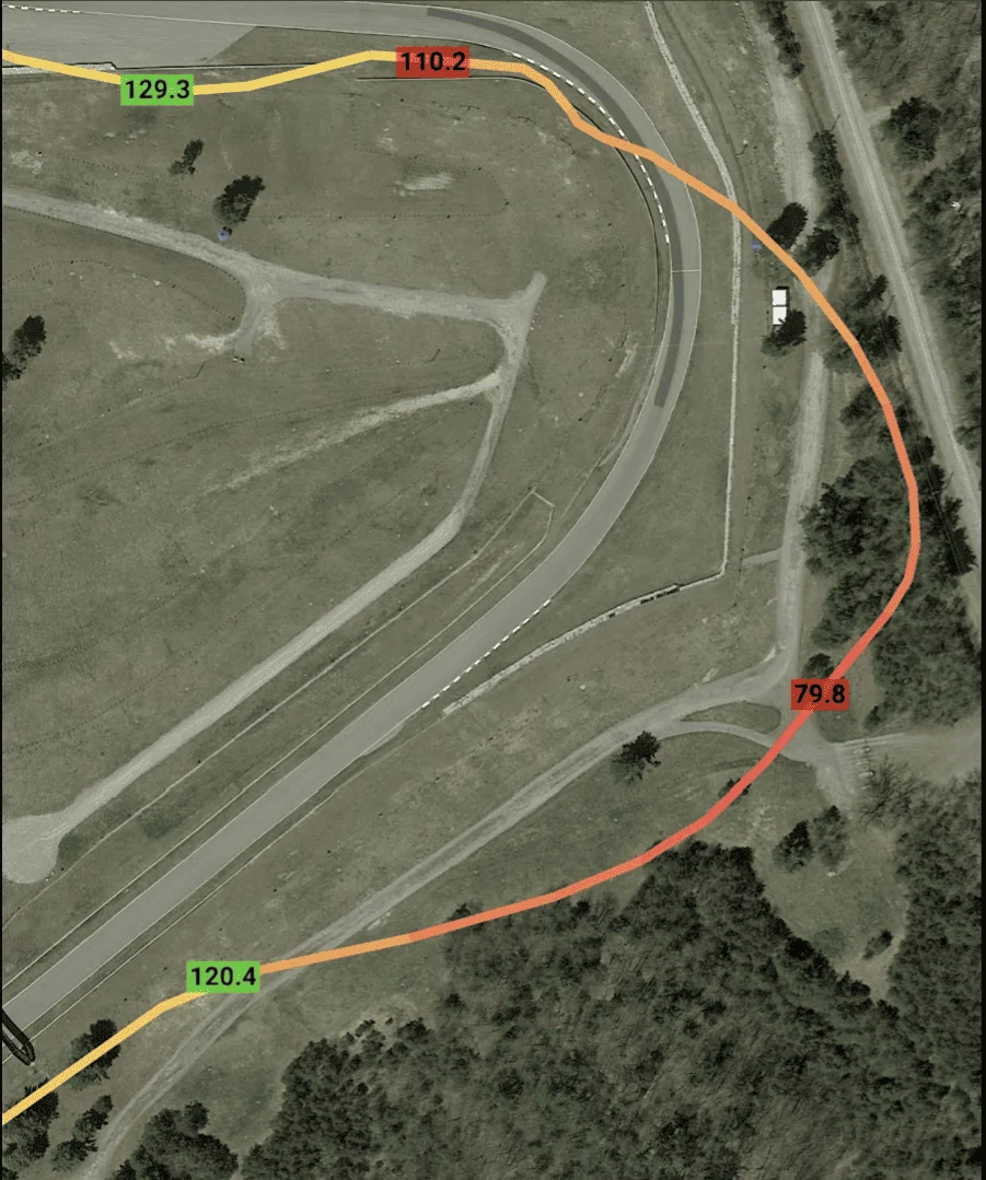

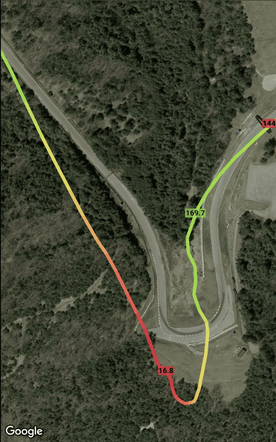

in my experience, built-in phone GPS units are just not fast enough if you want accurate data. doesn't matter whether it's android or iphone, it's a hardware limitation, regular phone GPS does not require that level of accuracy. XGPS160 and any similar race GPS (Aim Solo, Garmin Catalyst and etc) are all 10Hz, giving 10 positioning data points per second versus 1-second or something samples based on in-phone GPS. you should not be seeing things like this with a good external GPS unit:

for sure, you should try tweaking the settings first))). the screenshots I shared are from android Samsung top of the line model. all the app settings were correct, however accuracy was a complete mess, as you can see. I couldn't trust any lap times with this. more importantly for me, there was no reliable way to look at how I enter and exit corners, how different lines and entry speeds affect things, where I have biggest opportunities to improve and etc.
you probably had a different phone which worked better. just saying that don't expect miracles with in-built GPS. 😊.
note for transparency - I never tried xgps160, cannot say how exactly it compares to phone only solution, on paper it looks very solid option though

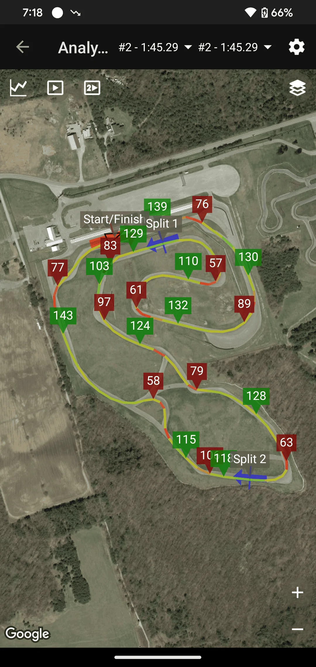

While I totally agree 1hz phone GPS is not optimal, moving my phone from my pocket to my windshield resolved the issue you're showing here.

There may be an issue that Tosha is in the middle of BFE in Ontario. Maybe, the middle of BFE in CA might have better satellite coverage? That wouldn't explain the difference phone to phone, but I've never really seen GPS info as bad as what Tosha is seeing. It's either that or his line is absolute garbage.

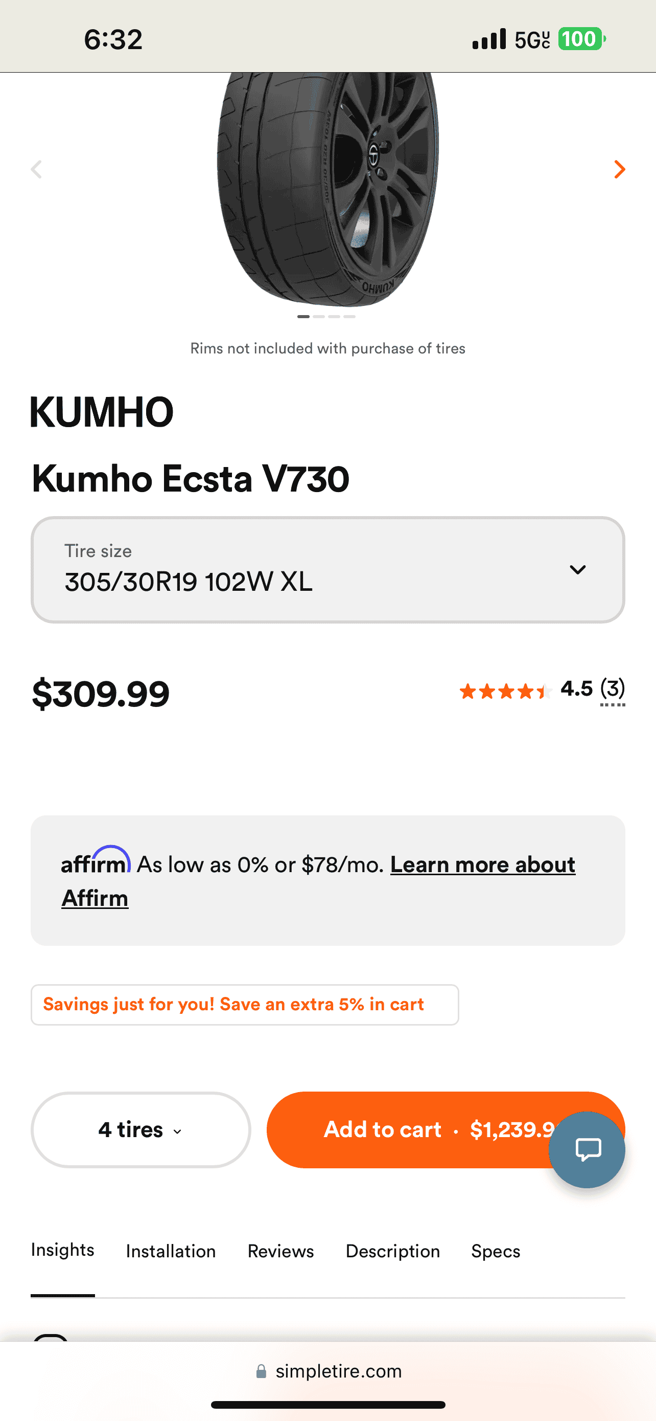

they are still under $1200 a set for 295/19 size. They won't win you any time attack events but they will help you become a better driver.
I remember you inquiring about the Kuhmo v730 last year I think and just an FYI Simple store has them for $310/tire before promo code. Just got to the shop and will put them on this weekend. Will see what my event next weekend brings.

hahah, I might have taken a forest trailrun shortcut, that would explain some excessive debris on track :crackup: :crackup:
mine was attached to windshield. you guys are probably right and it could be issue specific to my device, or as @TeeLew is suggesting, some bad GPS coverage. that actually makes me curious to try it out with a different phone later this year.

I'm also in Ontario and run in the same areas. This is right next door to where his shot was.

So, clearly, enough satellite coverage is available. Is there any way to record how many satellites it's seeing in the moment? You should probably have the phone in a window, but better yet would be to use the car GPS in the roof or a magnetic roof mount antenna.

I'll give it another test in April at GP track with a different phone and will share results.
One guess that comes to mind is that a combination of elevation changes and high speeds at Mosport GP make less accurate phone GPS's go crazy, or it's just my device being glitchy.
In either case, I should be able to test Garmin Catalyst vs Android Samsung phone with trackaddict side by side on that particular track, both mounted to windshield. Should be interesting )))
