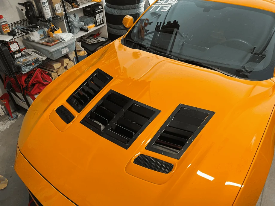

Finally getting some fun work done on the car! I've been wanting to add hood venting for awhile now and decided today was the day.
Now, I've never cut up a car before and I only have minimal metal working experience so this was quite the pucker! The instructions supplied are very clear and the template works great. I have to add, Race Louver customer support is second to none! I've been annoyingly emailing Albert for months now with various questions and he is beyond helpful. I called him halfway into cutting and he was quick to answer my questions. He even called me back later in the day to check on my progress and see if I had anymore questions before he left for the day. Albert, if you see this, THANK YOU!
The entire process was quite straight forward. Time consuming, but straight forward. I HIGHLY recommend taping the entire hood as metal shards and fragments get everywhere. I then used moving blankets to cover the engine and the windshield.
For finding dead-center, I used a long strip of floss and taped it to the center of the windshield (small decal label there perfectly in the center) and then pulled it tightly over the hood and lined it up with the crease line in the front bumper. Then simply measure about 17 different times and tape down the template.
I used a Dremel to cut the whole thing. Took 1 diamond cutting disc (or whatever the more expensive disc is made of) and 2 regular metal cutting discs. I tried to cut it all with the hood still on the car but getting the bottom layer cut correctly requires the hood off. After that, it's cut, trim, measure, and repeat till it all fits snug.

Are the louvers movable up and down ie track v street and do they stay in place once moved? I have a Roush stage 1, and my regular tech mentioned it was warm under my hood. I have stock '16 vents reversed to capture air and my insulation blanket remains in place.
They are stationary. Once you make that cut/hole, no going back. Race Louvers offers different “levels” of trim: Street, Track, Extreme. For non track use you may go with the street trim.

Finally have the full Race Louvers hood vent kit now. Did the center vent years back with a Dremel. Though it worked, it took forever. This time, I got an angle grinder....holy moly it cuts through like butter.

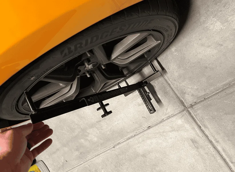

Last point: I have decided to start doing my own string alignments at home. The shop I normally go to for alignments, I used to work at and I'm close friends with the owner. However, they are more accustomed to Camry's and minivans, not wannabe race cars. They have helped me out thus far but my car is beginning to outgrow their standards.
I got a quote from a local race shop to cut my strut tower openings and do a basic alignment....it was nearly $1,000! Looks like my cheap-ass will do it myself.
So I bought a string alignment kit and a wheel camber gauge. It doesn't seem too difficult to do yourself, just tedious. I'm looking forward to being able to have an alignment done whenever I want though, the freedom is nice.
