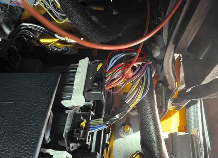

Ok y'all, got the Xineering installed finally. I'm not going to do an install guide because frankly, there is no need to. Between the instructions that come with the kit, Xineering's install video, and help from friends (@Biggsy thank you!) it's pretty straight forward.
However, the instructions don't tell you how to wire in a switch and I hit a bizarre snag that even surprised the Xineerings folks.
Simple wiring diagram for an LED switch:
I tapped into the brake signal wire no problem. Though the posi-taps that come with the kit end up twisting the wire since you have to thread the two pieces together; makes it look messy afterwards. I went with different taps after that.
When I went to tap the blue-grey 12V power wire, I found something odd...
My car had two blue-grey power wires. I emailed this picture to Xineering and they were rather stumped too. They said I could open up the BCM and see which wire is pinned to Pin 6 but likely it's double pinned to both wires. So I picked one wire and tested the system and bingo, it all works.
