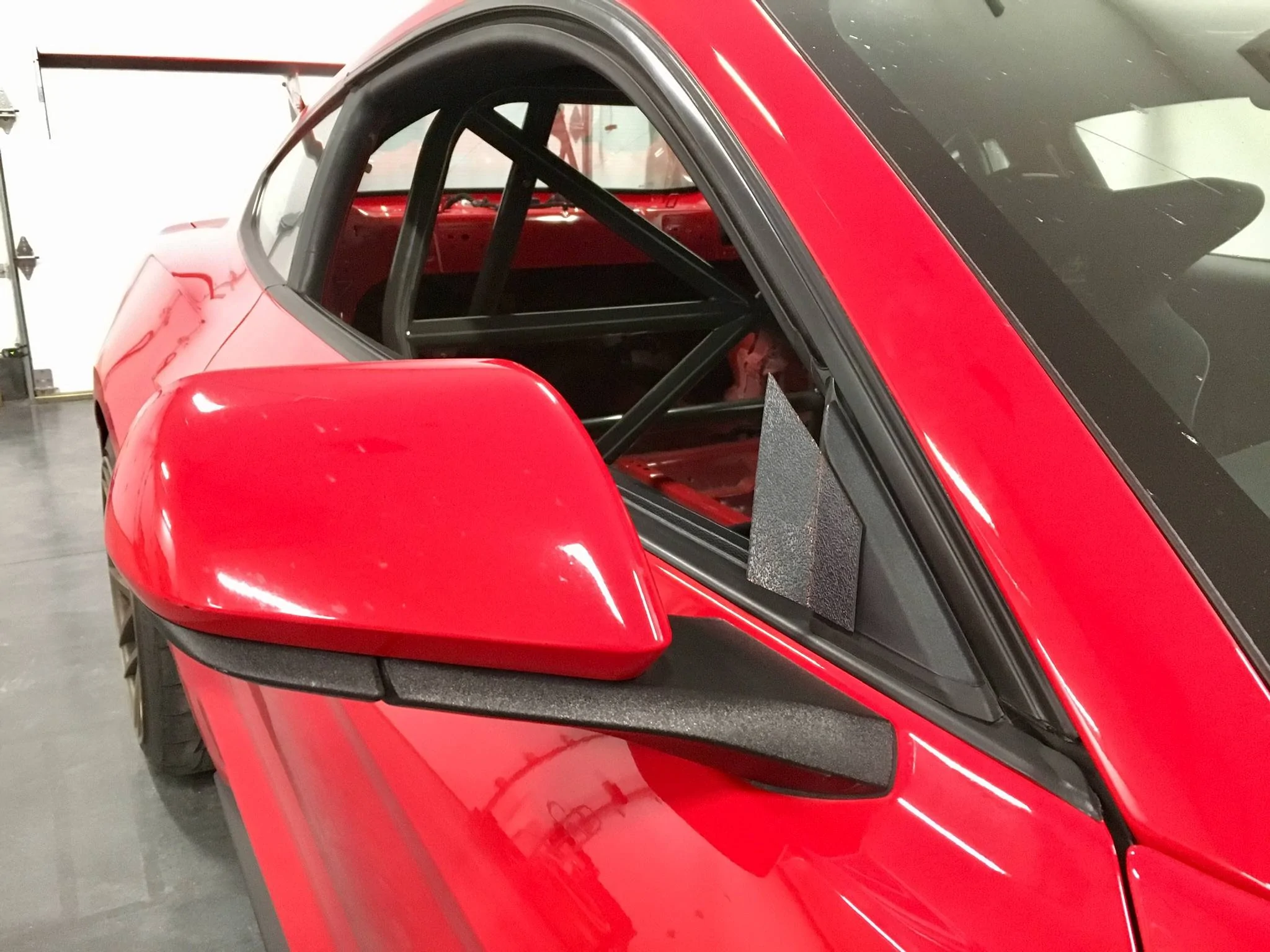

I’m intrigued. Give me the 10 cent tour on these clever little wind deflectors please. Materials, effectiveness, etc

sure. 1/16” abs plastic sheet cut and bent 30*. Double sided sticky taped on. No more buffeting at speed on track. Prior to installing them buffeting at 90mph plus was so bad it required ear plugs in my helmet. Deflectors resolved it completely.

That’s awesome. It would be cool if someone with a 3D printer could make something like this.

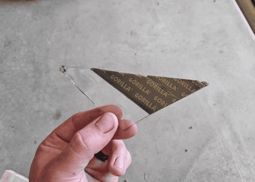

@Scootsmcgreggor here's my attempt.
.093" sheet of Lexan from good ol Home Depot Racing. Cut out the shapes with a dremel. First tried to heat them up over the kitchen stove....after burning some hair off, I now own a heat gun. That works much better.

If i were going to print something, then I think I might try to do the whole part, including the door trim piece. It's funny that Ford missed this.

To be fair, with the back seats in, there's no buffeting. I didn't want to spend the time/money or add weight with a seat delete thing

- Last point on this very long post: the little wind deflectors worked flawlessly. Zero buffeting even at 145 mph.
