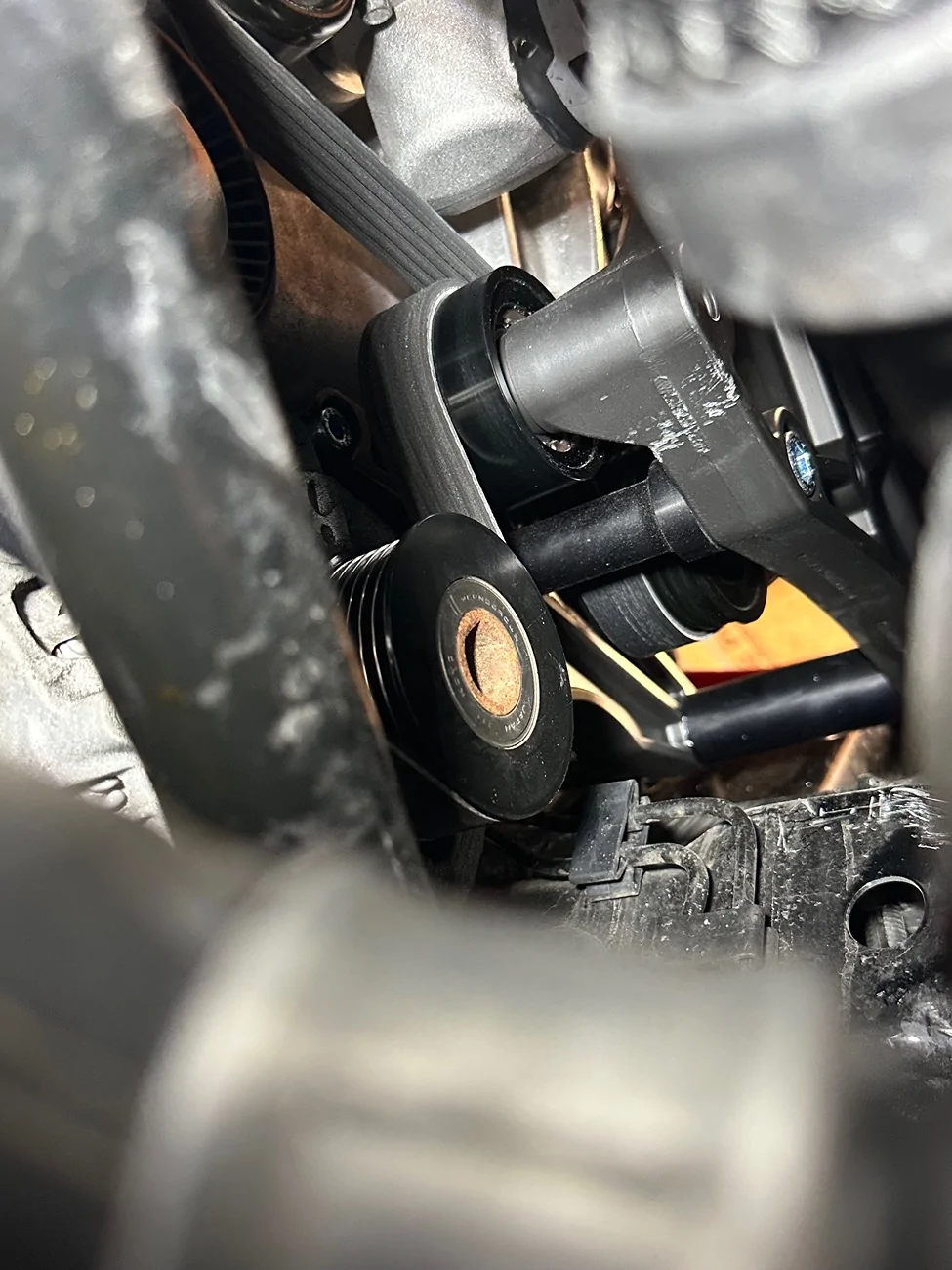

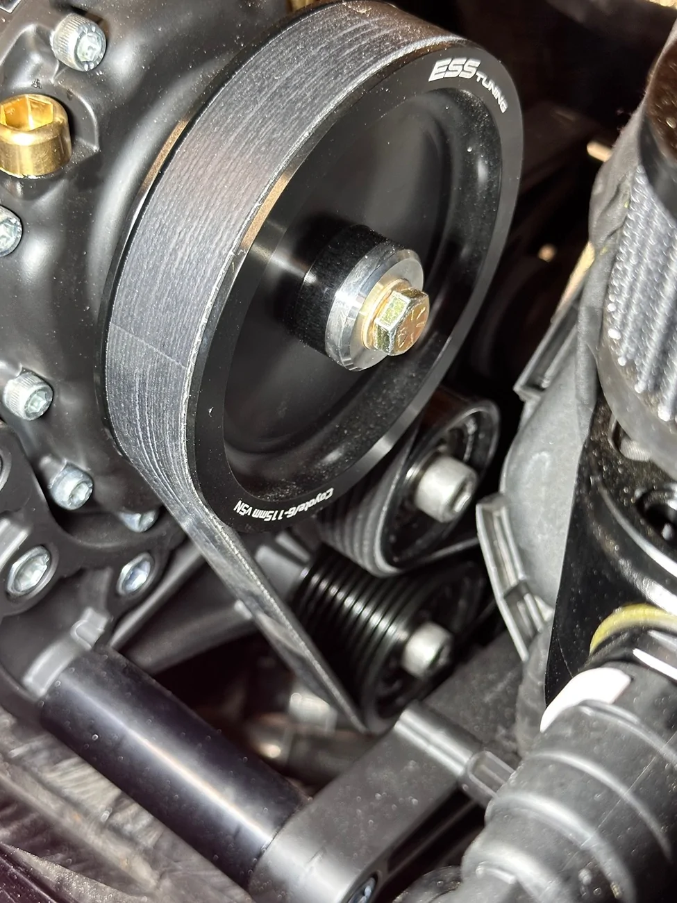

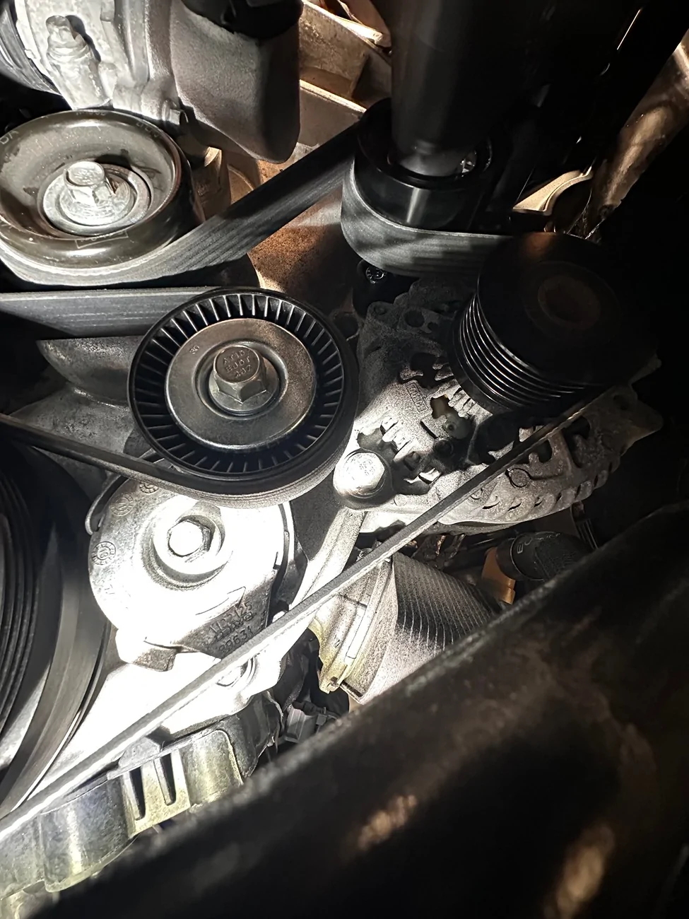

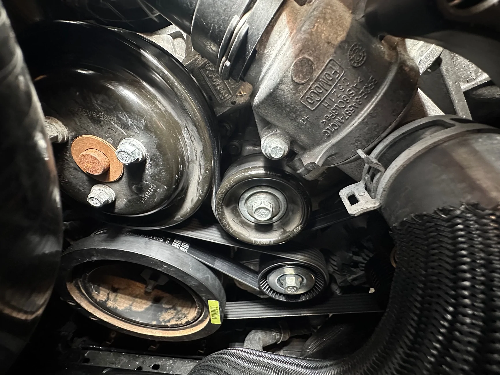

I'm going to bet that you do have the belt routed incorrectly.
The sensor is correct, and the belt is routed correctly. I’m underneath right now looking everything over.

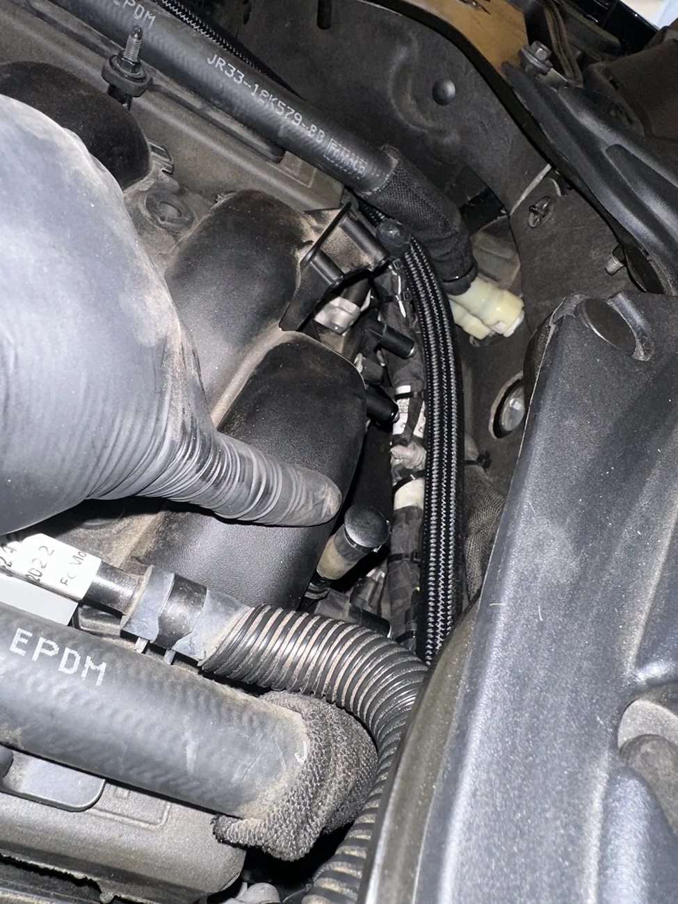

Am I supposed to block off the brake booster line? That’s what I’m being told to do.

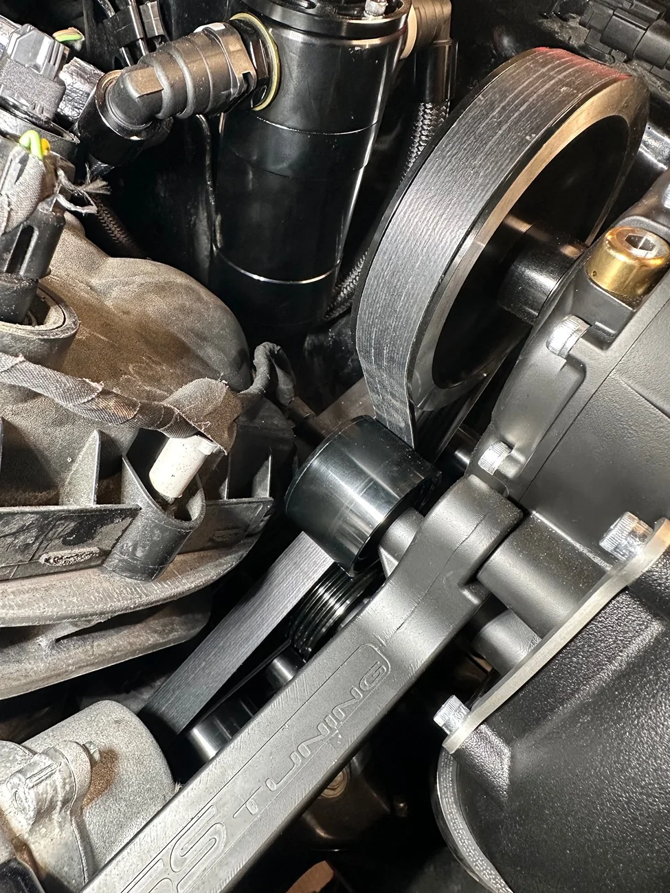

Make sure the pulleys are aligned with a straight edge or laser tool if you can borrow one
Does that really make sense? How would the booster do it's job if it isn't getting manifold vacuum? (That capped tube behind your intake manifold is not the booster line)
You may very well have a vacuum leak that is causing it to run rough, or not idle. Did you remove the intake manifold to do the IMRC delete?

That’s what I’m saying it both ESS and Lund both aren’t any help, and simply say block off everything but the blowoff line. And there’s no guides online.

Yes I did remove the intake and there’s been no signs of leak from it. These vacuum lines are making no sense for where to place them. So it’s either going to have a vacuum leak or be plugged off.

As for the belt. You might want to remove it, and verify that all of the ESS pulleys, idler, Water pump, Alternator spin freely.

I made sure all pulleys spin freely, and it seems the tensioner doesn’t have to move much at all to get the belt on. I have the correct belt for the correct pulley, and they correct layout too.

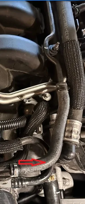

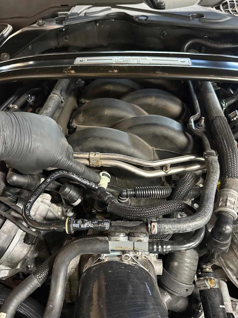

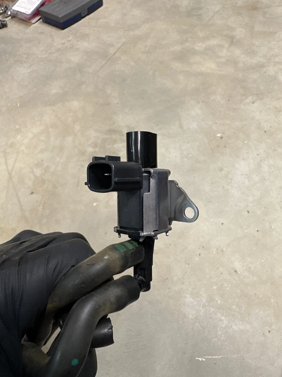

Take a picture of the line that Lund is telling you to plug/cap. This is the brake booster line
It should be tight, and at about 75-80% of it's travel. Meaning only another 20% or so before it is completely maxed out

the brake booster line feeds to the line at the front of the manifold, and is a single line straight shot to the back that connects to nothing else but where the IMRC solenoid was that then connected to the IMRC.
I also attached a photo of the solenoid.
