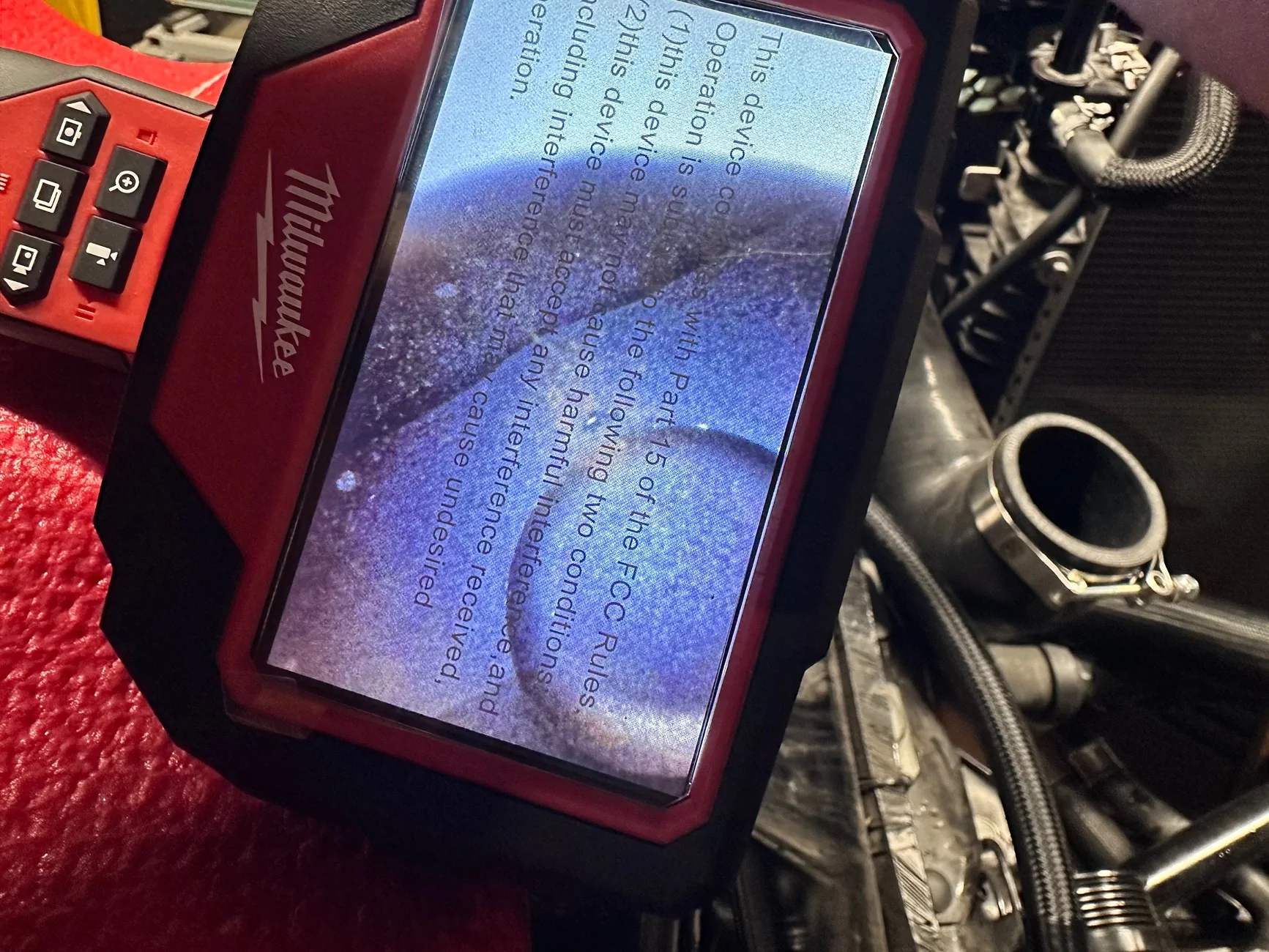

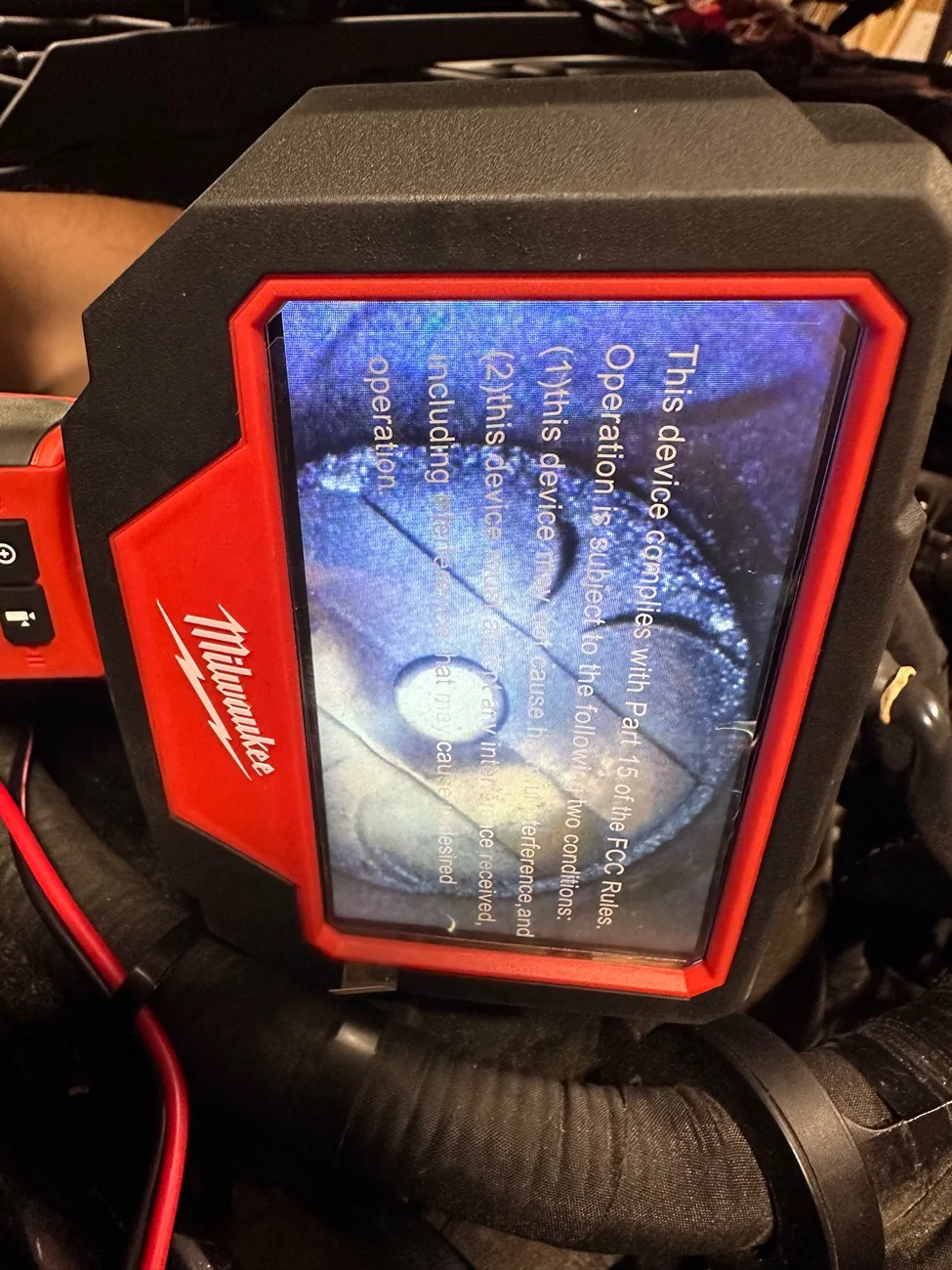

4 pistons looks good on driver side, passenger side:
Just gunk build up or something worse? 🫠
cylinders looks good at least..

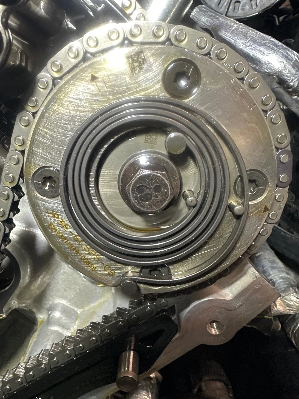

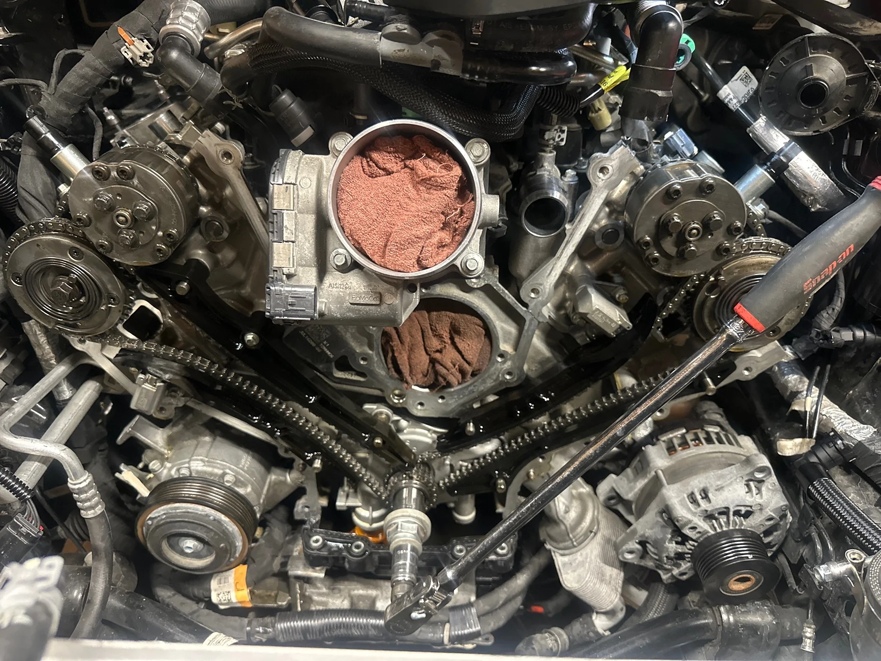

So I believe I found the issue.
Aligned the RH (passenger side) cam face mark to the top position in relation to the key way at 12 o’clock. Removed the RH timing chain, then rotated the keyway to the 5 o’clock position. And found the LH driver cam face mark exactly 180 degrees the wrong way.
Therefore the original timing had the LH (driver side) cam rotated a full 180 degrees wrong, tensioned, then while moving onto the passenger RH side, set it up for failure exactly 180 degrees out of timing. All because of the initial LH side cam position when timed. The LH set up the RH for future failure.
So now I’m at the driver side cam face, and have not removed the chain yet. The face is 180 degrees in the wrong direction, so I will turn the crank 1 time to leave the keyway still at the 5 o’clock position, but correct the passenger side cam first before continuing onto the RH cam and chain.

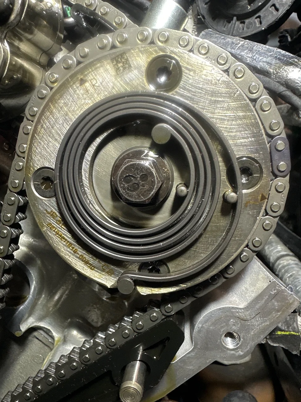

Here is the driver side cam face while the keyway was only initially moved from the 12 o’clock to the 5 o’clock position: the LH face mark is incorrectly positioned 180 degrees.

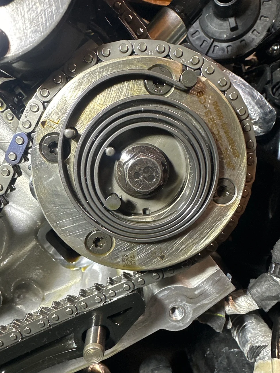

After rotation, it’s in the correct position and the crank keyway is also at the 5 position now. The tooth mark is off by 1.
can someone verify this is all coming correctly?
Also had to remove the new sprocket to find out the timing mark was on the inside. I do remember that from the first install. Oh how helpful boundary! So I marked it properly for the time being. And no the sprocket is not facing the wrong direction. It’s legit on the backside of the sprocket.
The previous timing change must have skipped the step between timing the LH and RH cams. I even pointed that out when it was time to do it last time. Should’ve done it myself. They must have not done the full first rotation, and only went from 5 to 12 position. Unbelievable that this happened but also crazy how the motor didn’t blow up, but actually ran with a cam face rotated 180 degrees the exact opposite direction…

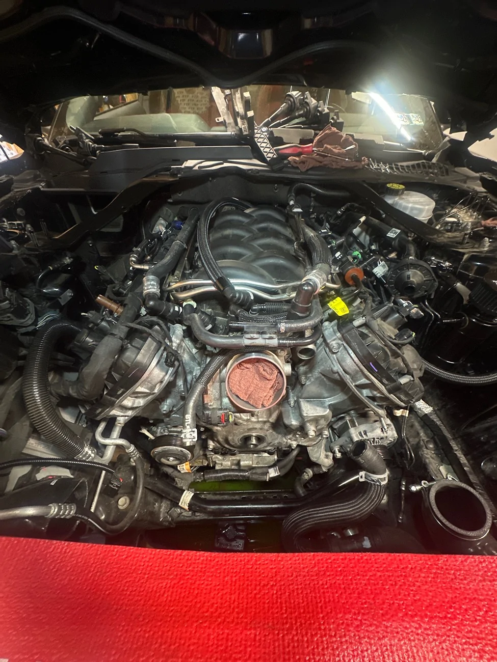

Front cover is on, as well as the LH valve cover, looking into the catch can valve now before installing the RH valve cover.

It’s nearly 4 AM. Long night, but got a lot done.

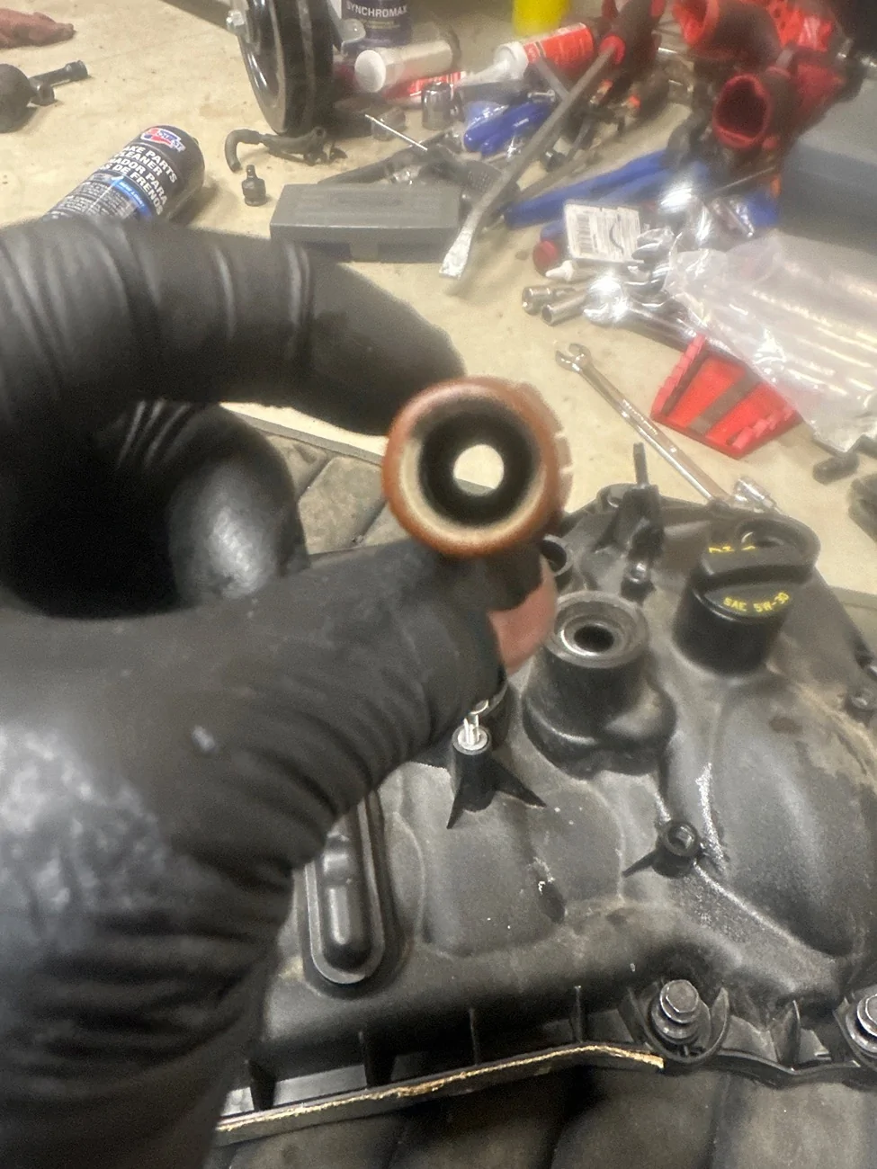

Completely uninstalled the kit and work area. Redid timing, front cover + valve covers back on, also got rid of the RH valve spring/ball mechanism. My goal was to get to this point and allow the RTV to dry/harden overnight. I’m at that point now.
Tomorrow morning agenda:
Clean spark plugs, reinstall the harmonic balancer, pulleys/belts. Fill fluids back up (even fuel at this point lol). Test how the stock tune runs. Go from there.
If all things go well hopefully the blower can go back in the afternoon/evening.

Got the spring and blockage out.
Yes this is what I was talking about. @SheepDog explained it in more detail so I figured you knew what I meant.. 👍🏻. Glad your car doesn’t seem to be hurt from all these timing issues. Hopefully it runs and drives good and you can start enjoying the car again..
