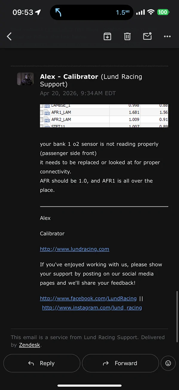

another thing was Lund replied with only this:
