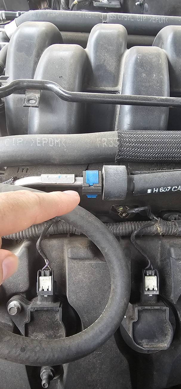

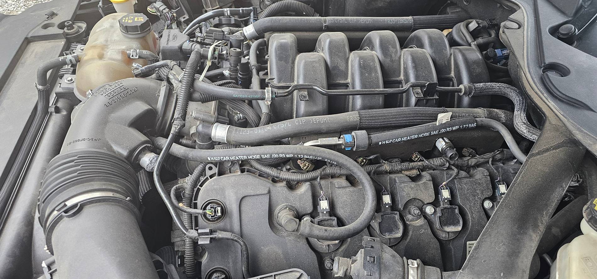

Where the fuel line plugs into the rail. It is on the driver side. Follow the fuel line and you can't miss it.
Hello; Curious as to what sort of fitting is on the fuel rail?
good shop will have an adapter that plugs into the fuel line at the rail.
On one of my former trucks, 1989 F-150, there was a Schrader type fitting on the fuel rail. I have a pressure gauge which screws onto that sort of fitting.

Gen 2 mustang
