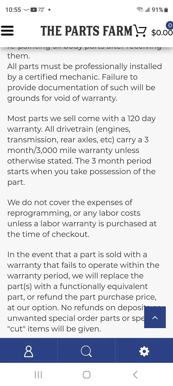

Actually, the "no warranty" on a used engine part of your statement is not always true. Very often recyclers will offer some form of warranty. It's often very minimal, like 3 or 6 months, and never covers R&R labor. But it's usually enough to verify that you have gotten a functioning engine.
Here's a snippet of the engine/drivetrain warranty from The Parts Farm (a reputable breaker yard in South Georgia). I post them because they specialize in Mustangs but do other makes as well.
