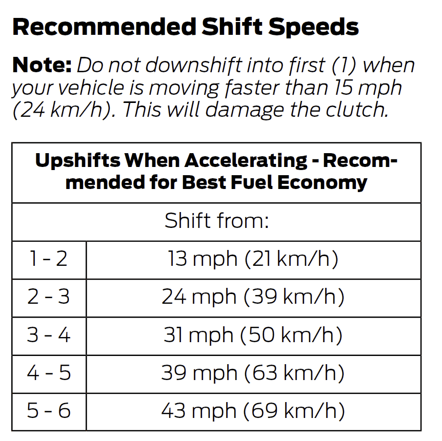

Mach 1 supplement (Edition 2020) says the recommended gears for economy driving.
6th is huge overdrive :)
And yeah, running 6th on 43-45 MPH goes around 1500RPM, which is quite low. I just add throttle not to go below 45mph while just cruising like Miss Daisy..., but for takeovers or acceleration always downshift to at least 5th, which sets me around 2500-2800rpm.

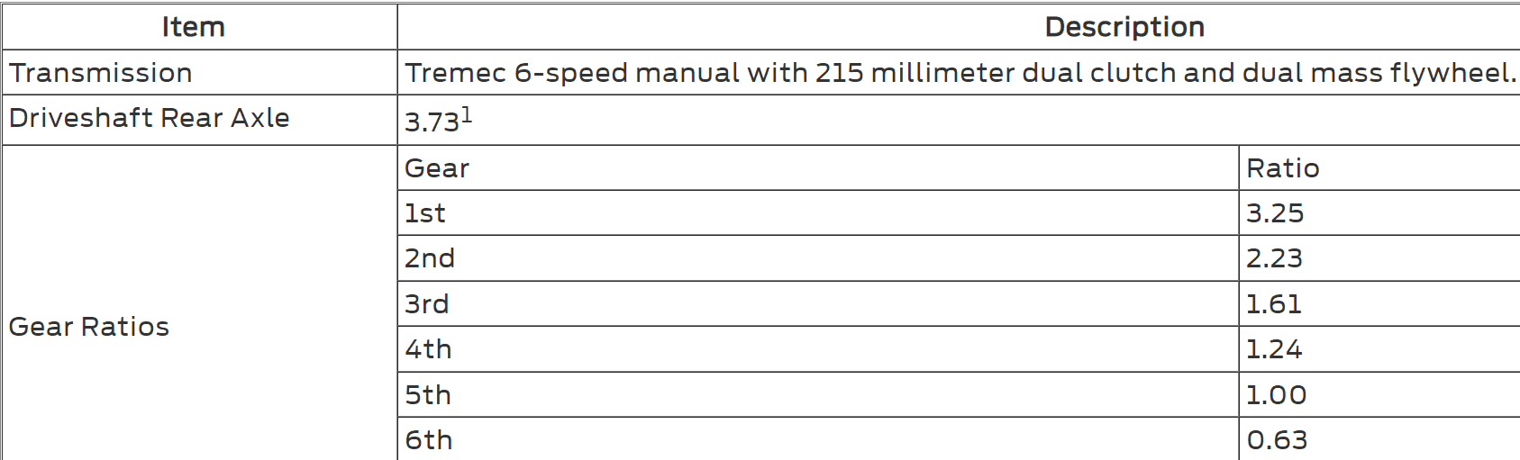

Again, there's no "basically" to this.
5th is 1:1 (not overdrive)
6th is 0.63 (quite an overdrive)
