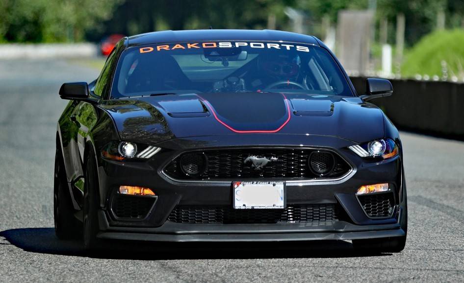

Sweet!! Yea temps are going to be perfect. What are you driving? I am in a 2022 Fighter Jet Gray Mach 1.
I think you'll be able to ID me from the picture attached :cool: Looking forward to it

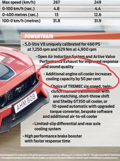

I thought the reason Ford put 5000 coolers in the MACH 1 was so it wouldn't have any cooling problems.
This….in Fact they made a big F’n deal how much better it’s supposed to be compared to a GT.
It disappoints me to see this on a Mach, especially with 2 upcoming track days. Sonoma in August is typically 90 (32.22 C for my Canadian friends 😂 ) Weathertech (Laguna) in September will be cooler 70-80. It’ll be interesting to see what happens.
(I’m a moron hack and I managed to run my Lemons car 15 hours straight on track in 105+ degree weather without overheating.)
You’re going to tell me professional auto engineers can’t figure out how to make this thing run for 30 min without overheating, shame on you Ford.

It’s not an oil cooling problem in the M1, seal off the air flow to the radiator and you’ll see CHT temps recover much more quickly after those runs on the straights where the A10 is keeping the RPM’s up. There are big gaps around the radiator, sealing those up helps a lot. At Sebring, I was getting RPM pull back 15 to 20 minutes into a session at 75 deg ambient. After sealing up the air flow to the radiator, I experienced no pull back at 85 deg ambient.

Keep in mind the M1 has the oil cooling parts from the GT350 and is different from the GT.
