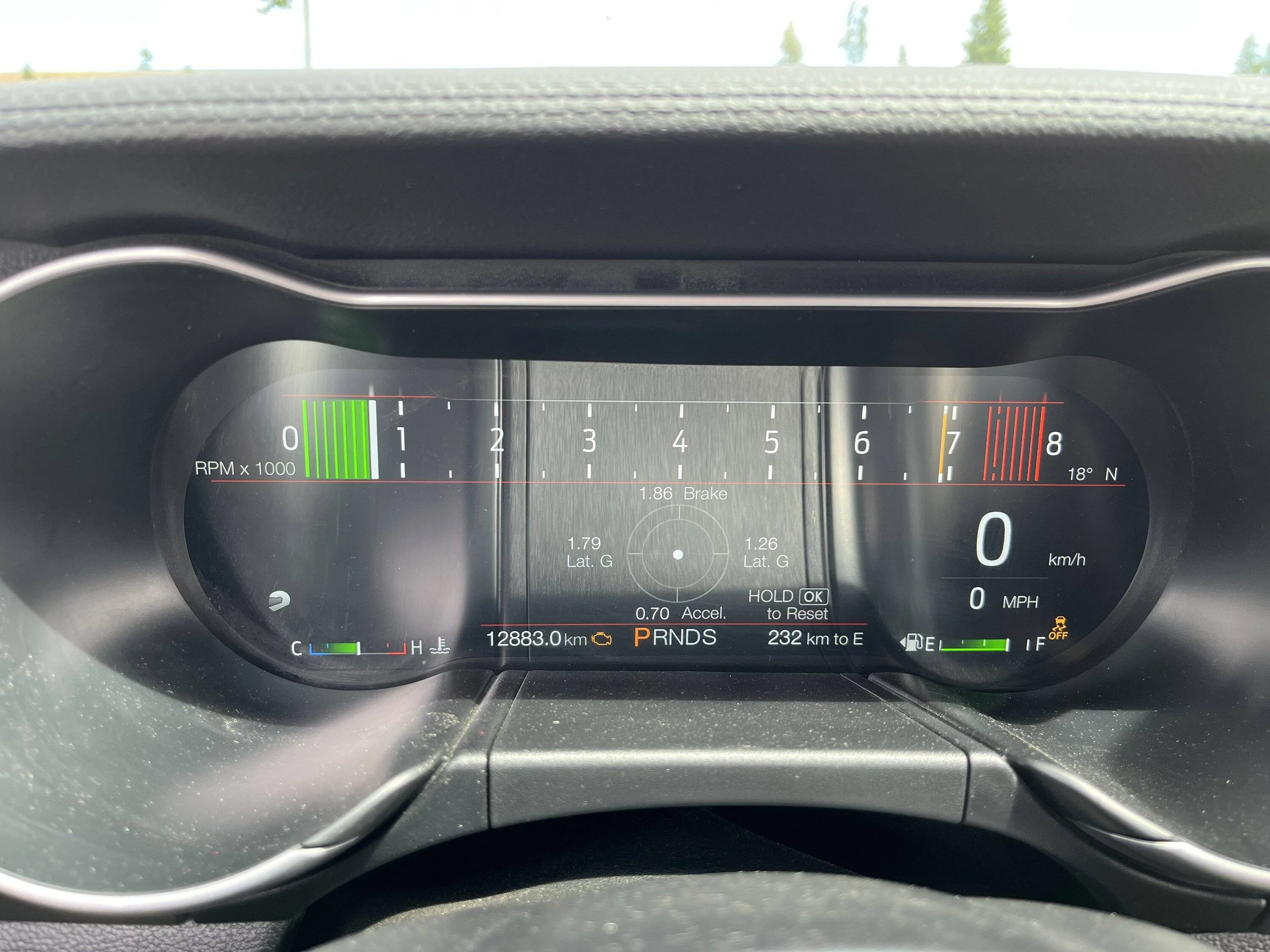

Was at the track on Friday (The Ridge, WA) and my engine light came on. I know I never overheated it according to the temp gauge. I checked my Ford App and it said "engine coolant overtemperature condition". Called my dealer (friend) and he searched my code and said it must of overheated at one stage. I said not according to the gauge but he said I could keep tracking the car but ease off a bit. I did and watched my gauges like a hawk. The next morning the light cleared itself. The dealer said it would be difficult to check the issue without it being present and I should check the forums? Anyone experience this before on the track with a solution?
