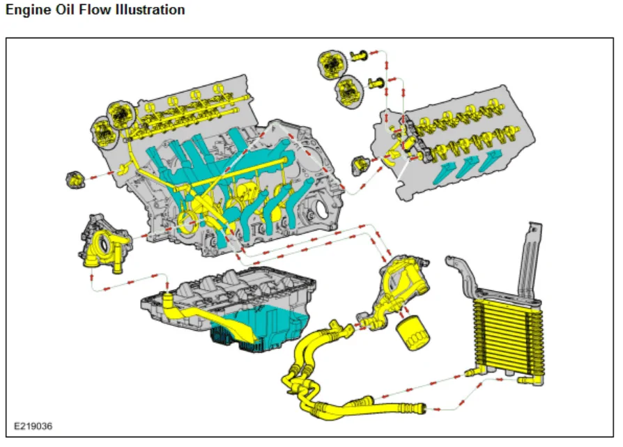

If somebody with Mach1 could take pictures of how the oil cooler is routed to the engine, and whether ford kept a usual coolant-to-oil heat exchanger, that would be really greatly appreciated.

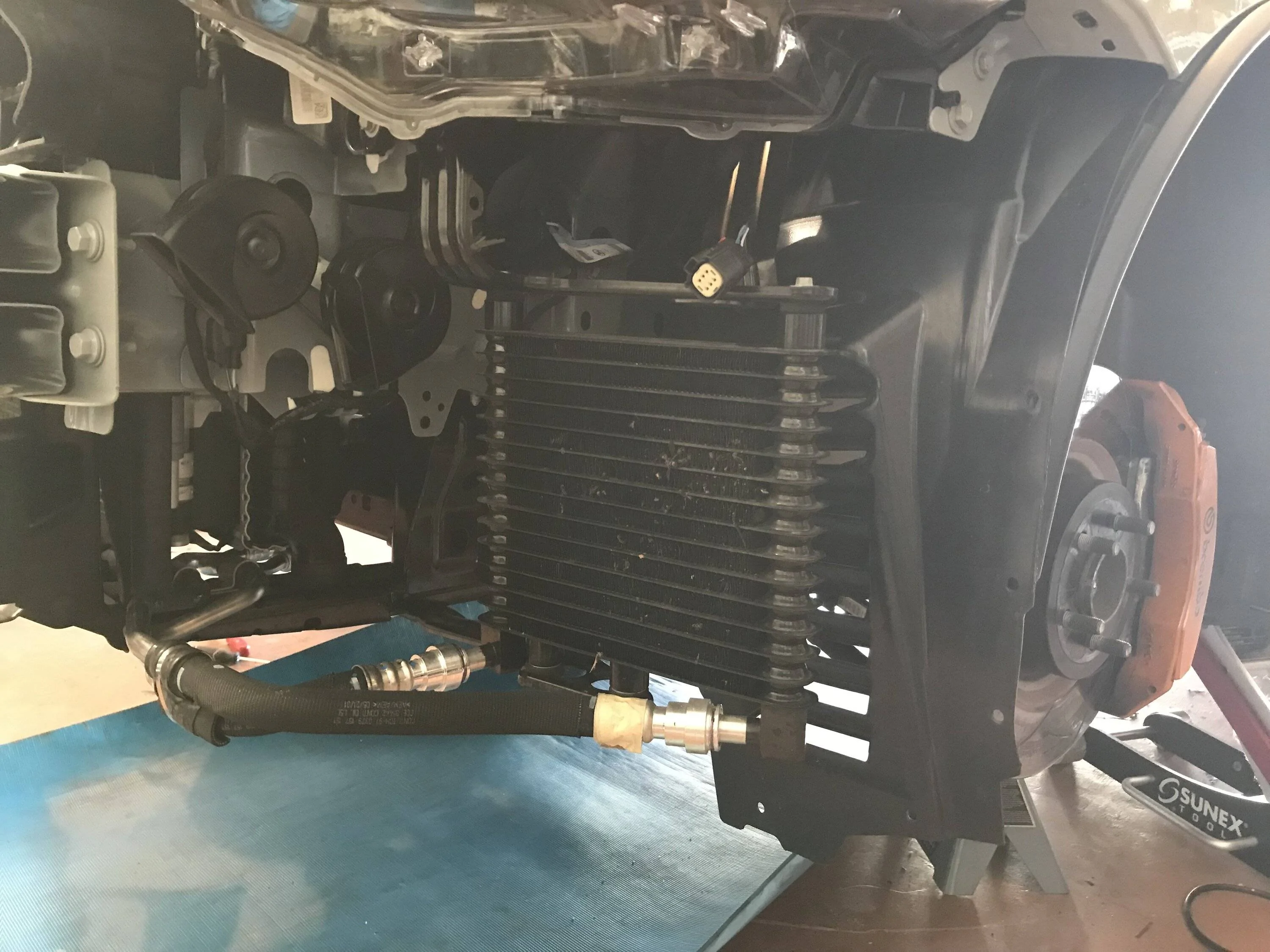

This illustration is for the GT350 but the M1 has a similar filter adapter, cooler line and cooler.
Here’s a pic of the cooler…..
Thank you! Do you have a picture of the filter area by any chance? It's unclear from the diagram whether there is a coolant-oil circuit still preserved or not.

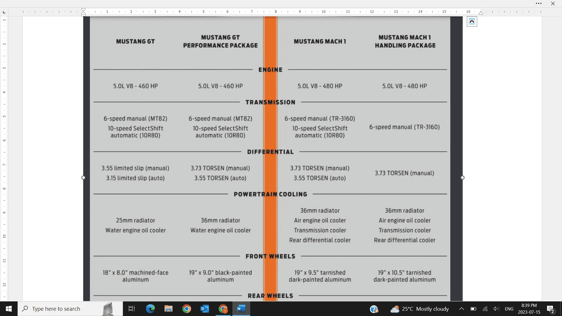

I think the Mach1 has the 4 coolers only. Radiator, Air Engine Oil Cooler, Transmission Cooler & Rear Diff cooler.

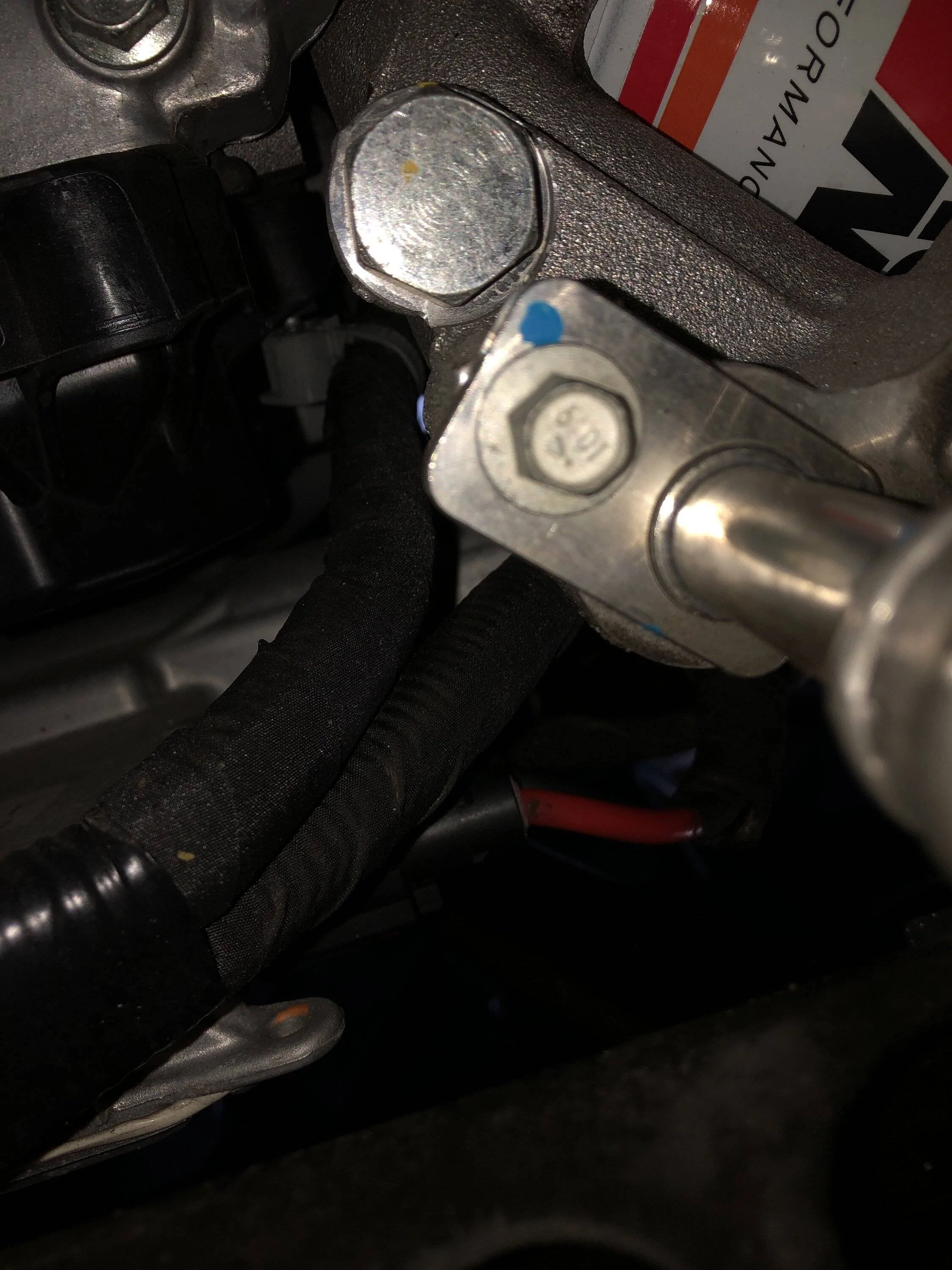

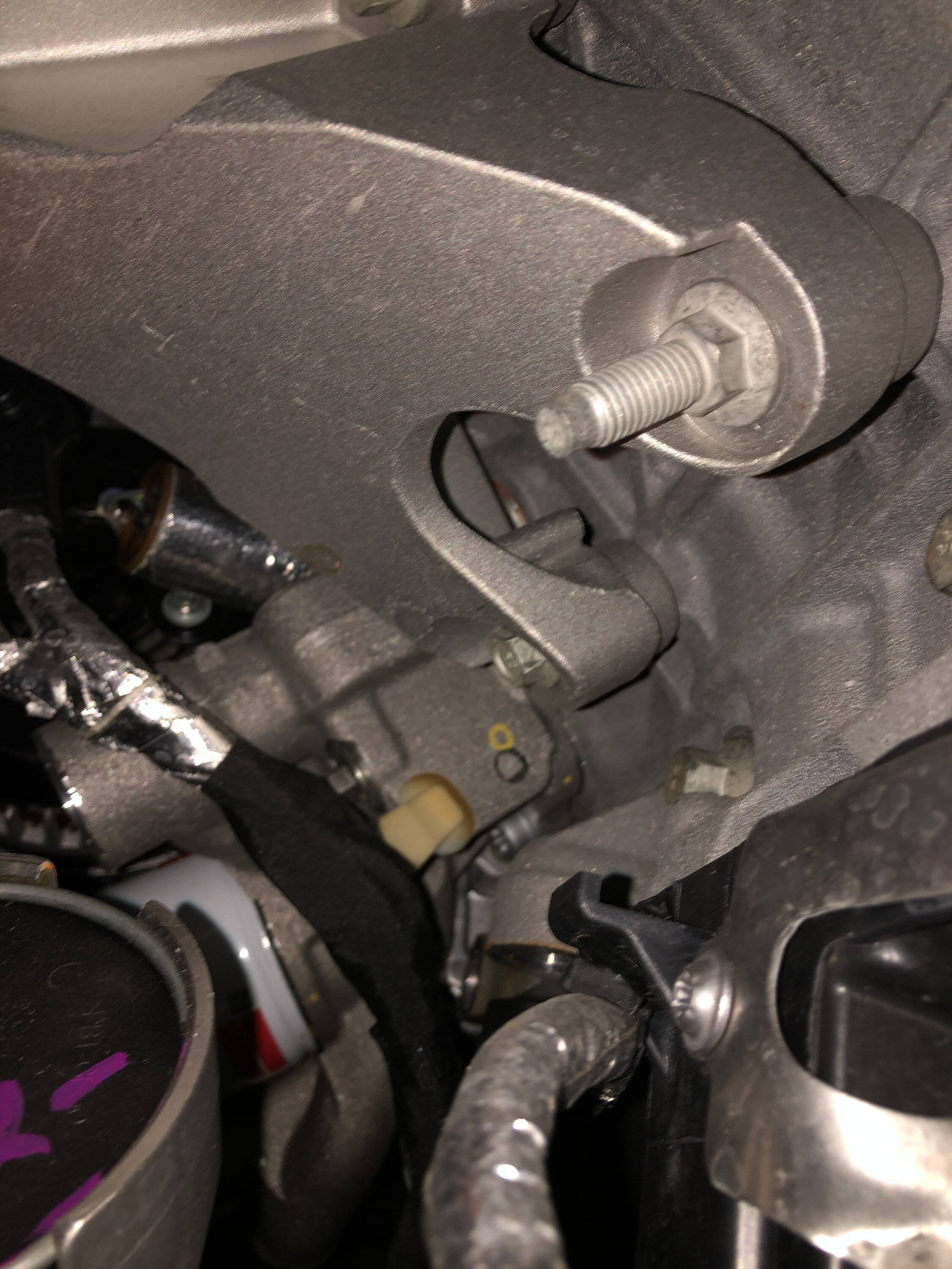

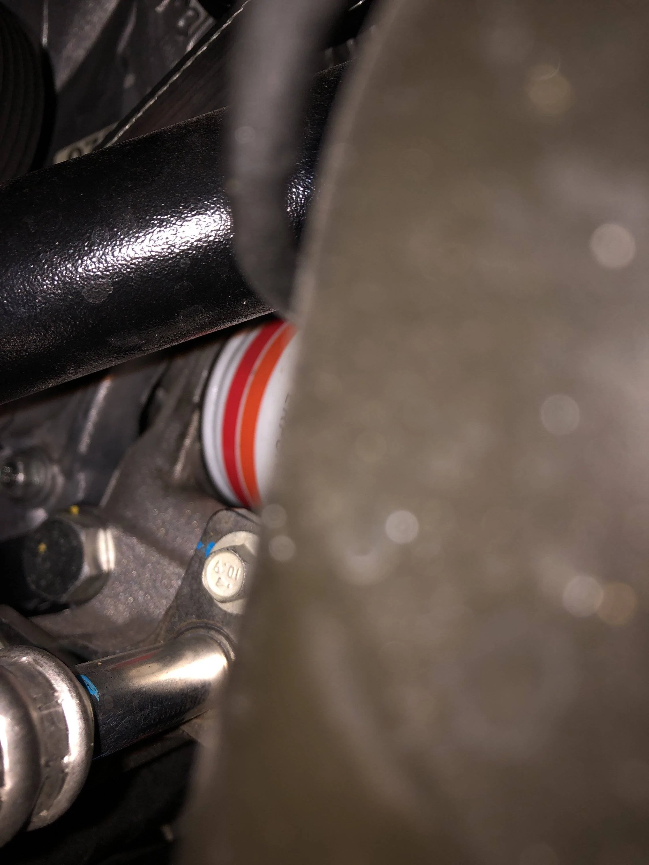

But when I was researching the possibility of adding the Mach 1 OEM bumper cooler and all associated parts, I recall seeing the regular water/oil cooler under the filter in the exploded parts diagram.
So it could be that the 350 does not use the water/oil cooler but the Mach 1 does. I am not 100% positive on this. Surely another M1 will post the definitive answer.

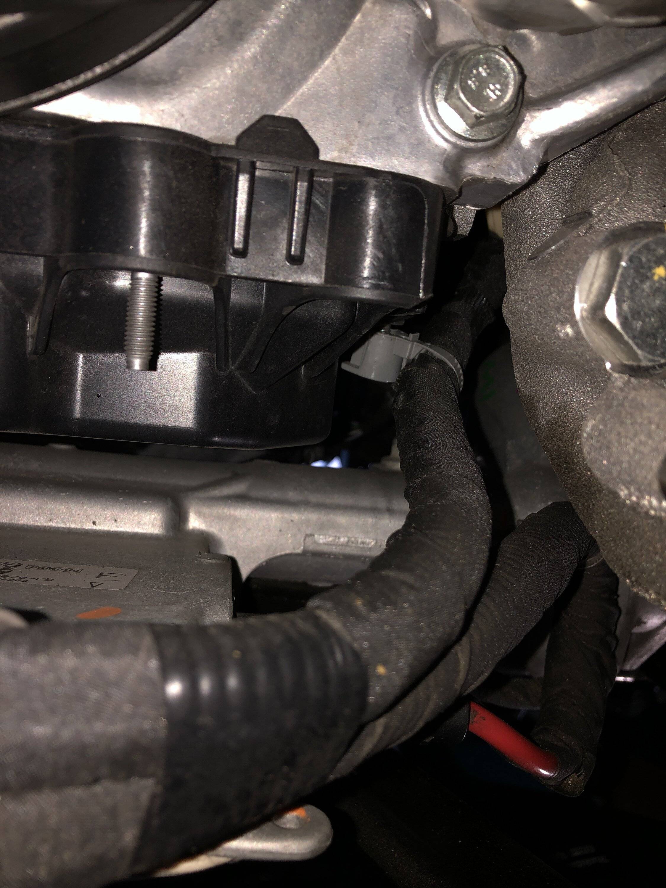

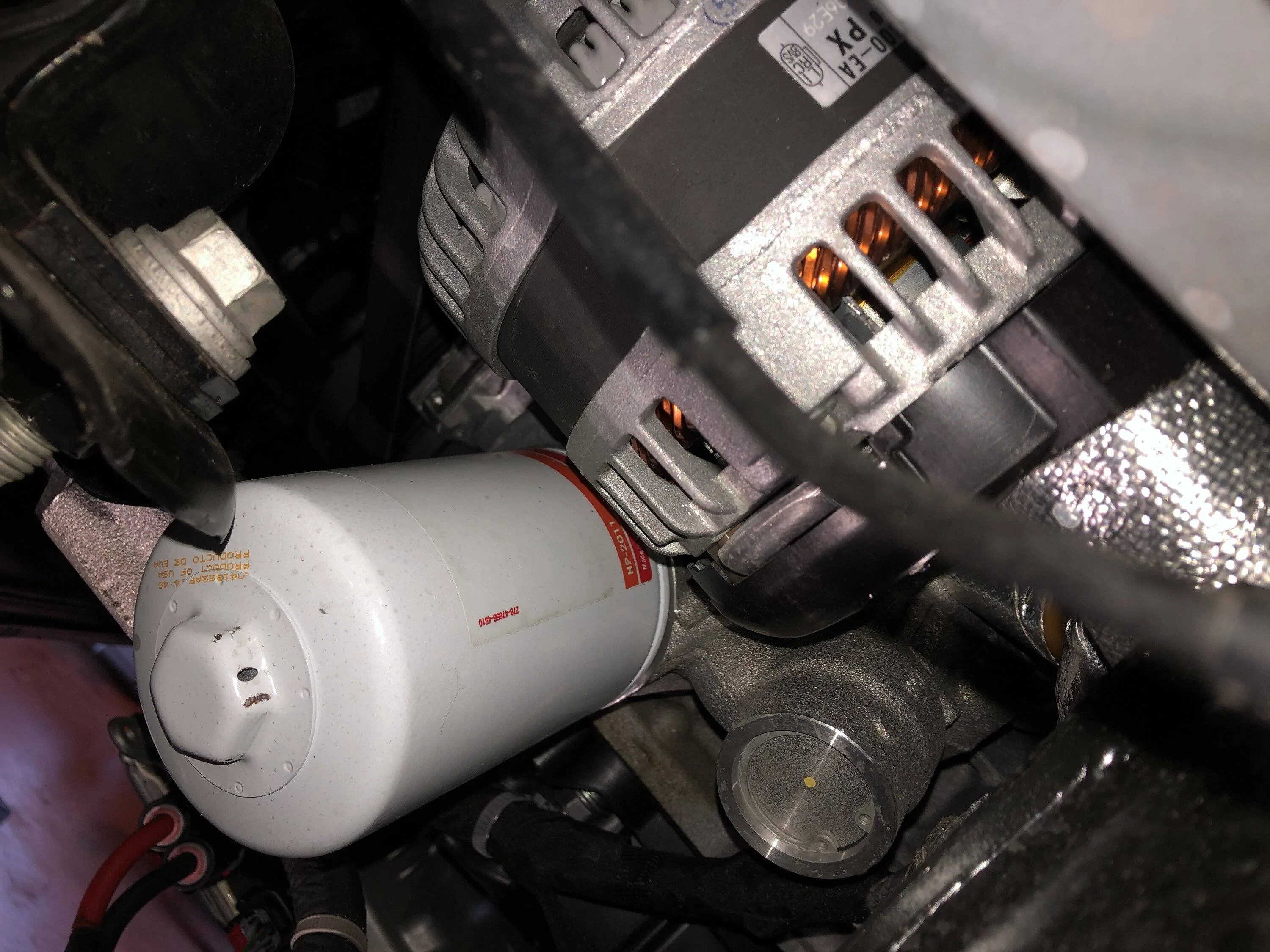

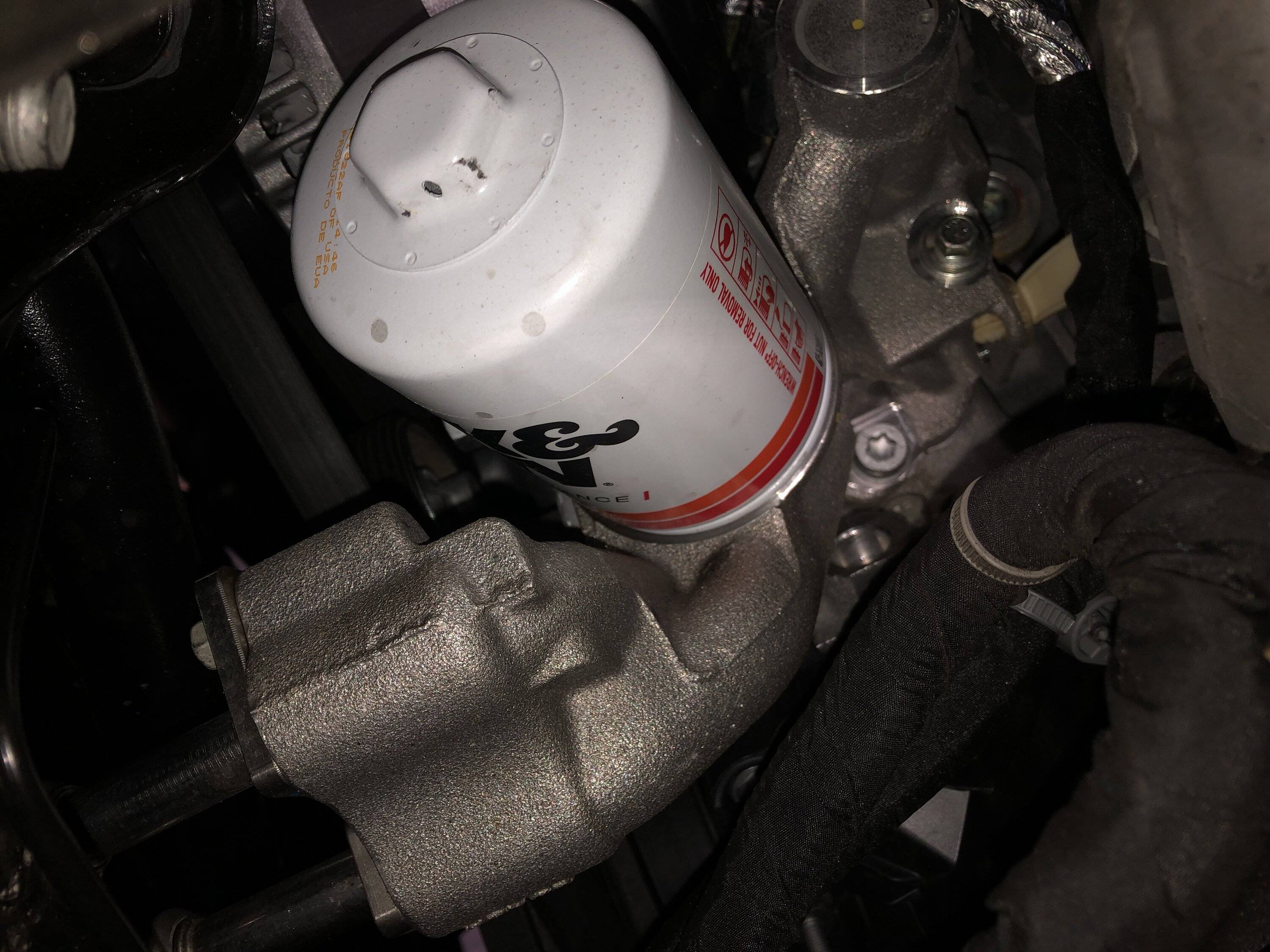

You got me thinking, so I dropped the splash shield and took a few pictures. I don’t see the heat exchanger or any coolant lines in the area.
