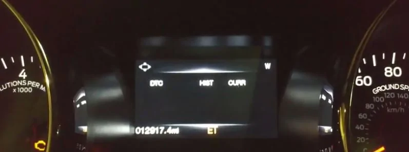

Watch this video on how to go into "Engineering Mode". At time 2:15 in the video you can see the screen that shows "DTC" "HST" and "CURR".
DTC = Diagnostic Trouble Code
HST = History
CURR = Current
See if your car shows any numbers under the DTC column, and if so what are they?
