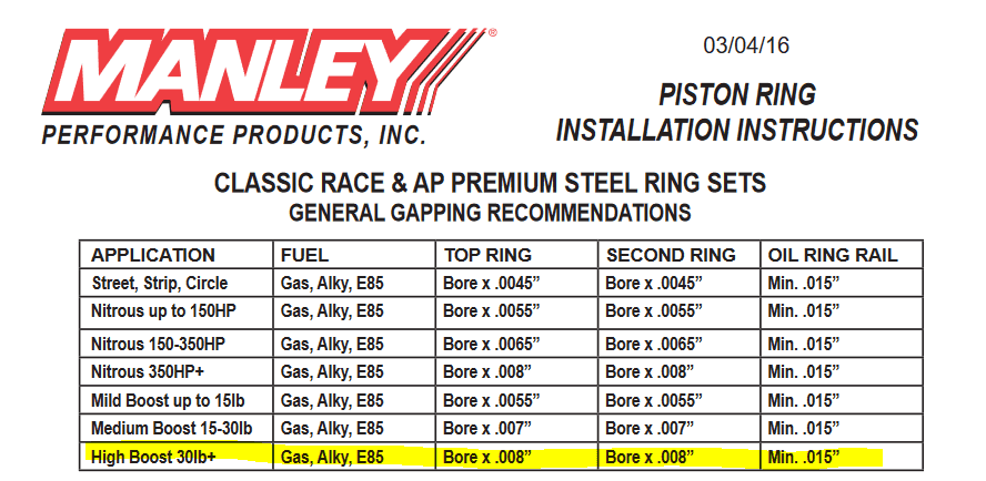

Will do mate. I have to keep the stock block for now as Ford Australia are refusing to ship me a new TS block from the USA, they only import short blocks and are not interested. Just need some gaskets and waiting on the other parts. I'm going to rering the Manley pistons as well because I was never happy with the ring gap due to excess blowby. Going to drop them down from the High boost gap setting to the medium boost gap calculation. In regard to the rods I'm using Manley H beam which are fine but if I did it again I would personally go to the 'I' beam for extra piece of mind.
