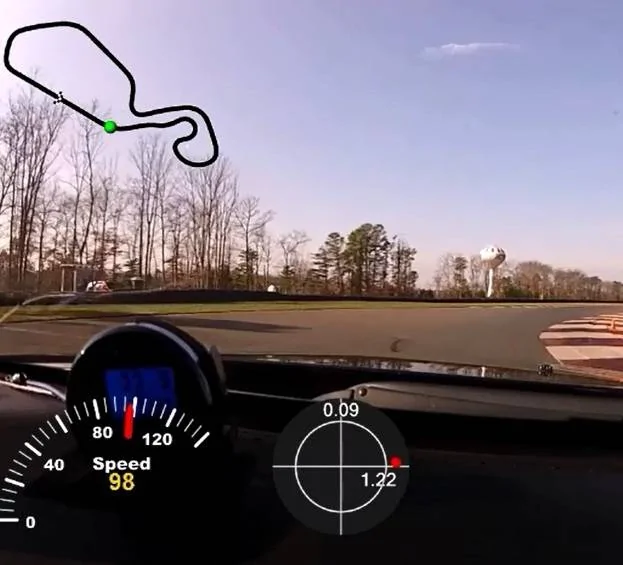

Also, my car can corner at 140MPH with the stock suspension. Just not at the same radius that it can at 60MPH.
If I was to take these cornering g's - made with true street tires, not some sticky track-specific rubber - and straighten it out to be forward acceleration . . .
I'd be driving a car that could do zero-to-60's at least as quick as down in the low threes, possibly down in the twos.
