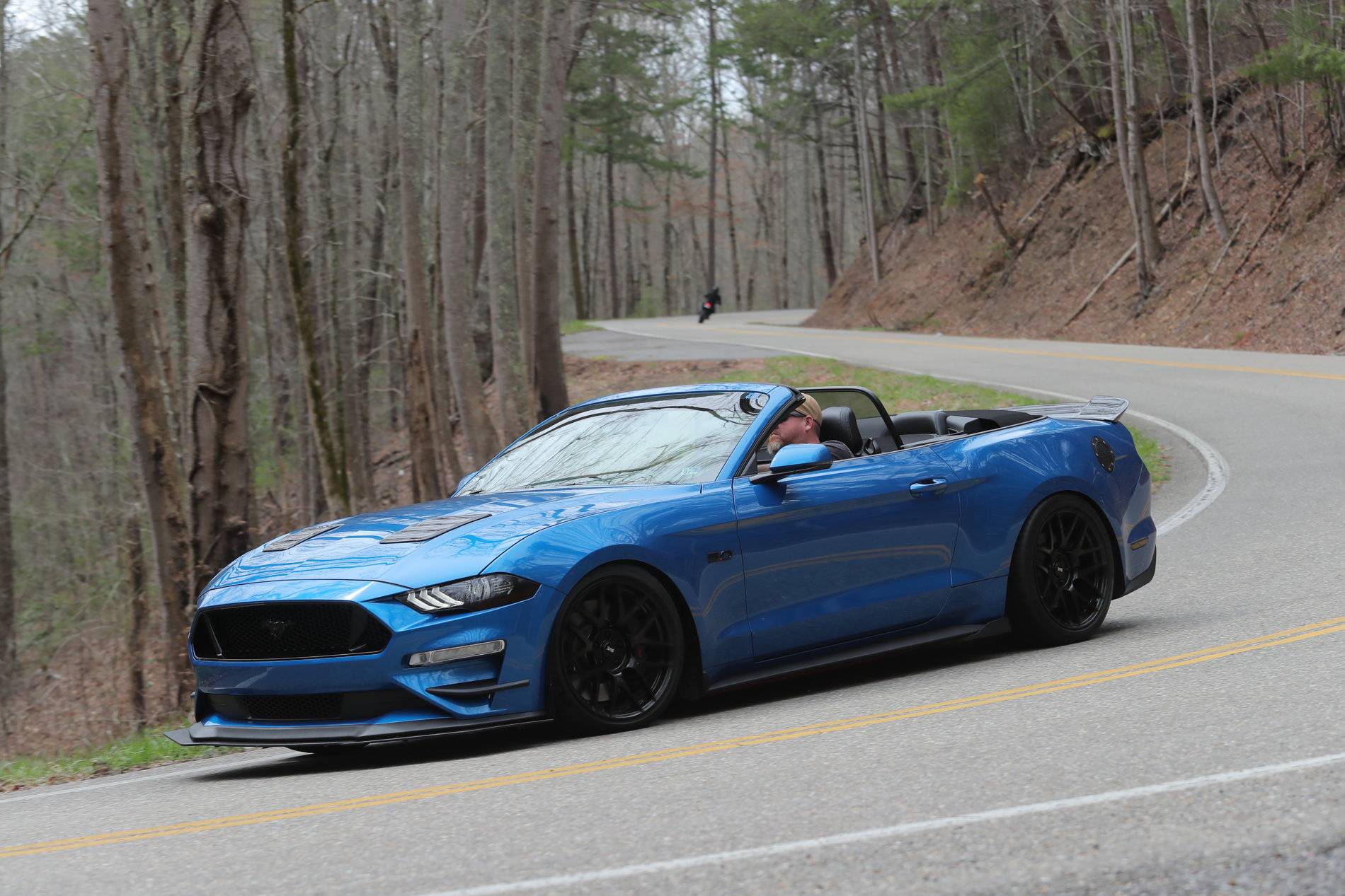

Thanks for the compliment! Like TopJimmy, I did everything at about the same time, and I didn't get a chance to push the car very hard before doing the work and between, but I can tell from reduced cowl shake over local wash-boards that the bracing helped a lot and the overall stiffness is much improved.
Anyway, for what the OP intends, I don't know that the spherical bushings and rear alignment kit I installed would be worth the time and money.
The J&M Jacking Rails that I installed are very long compared to the other brands I looked at, and approximate the old Sub-Frame Connectors we would use on SN95/New Edge cars. They are also under $200. The Steeda G-Trac brace was also cheap and easy. I added it shortly after the rails and noticed it tightened the car up further. Neither of those pieces add much weight and are very good bang-for the buck for the verts.
I can't comment on the springs since mine is an MR car, but the Steeda springs I went with are stiffer than stock...close to the GT350. I can push it really hard through some sharp turns, and while I get a decent amount of body roll, it isn't enough to where I hear the tire squeals at all. Of course, the Pilot Sport 4S tires are amazing. I don't think I am going to mess with new anti-roll bars. If I do, I would likely go with what MRX recommends and stick to something used on factory cars already, like GT350 bars.
I can say that with all the work I did, including the bushings and alignment kit, the car still rides VERY well in Normal Mode and is much more responsive and "precise" than before. I didn't pick up any significant NVH. Below is a pic through a hairpin on the dragon. I was pushing hard that day. You can see the body roll. I wish I hadn't lost a picture of the same turn in my 04 Cobra from 15 years ago. It was a coupe that I had that fully suspension modded, and it looks like it is about to roll over in the same turn at about the same speed. The S550 is a terrific car.
EDIT: I recall my best Lateral G the day the below pic was taken was around 1.1g on the built in PP meter. I don't know how accurate that thing is, or if that number means what it used to. 25 years ago a street car pushing 1g through a turn was a big deal, IIRC. It may be as common as rain these days.
