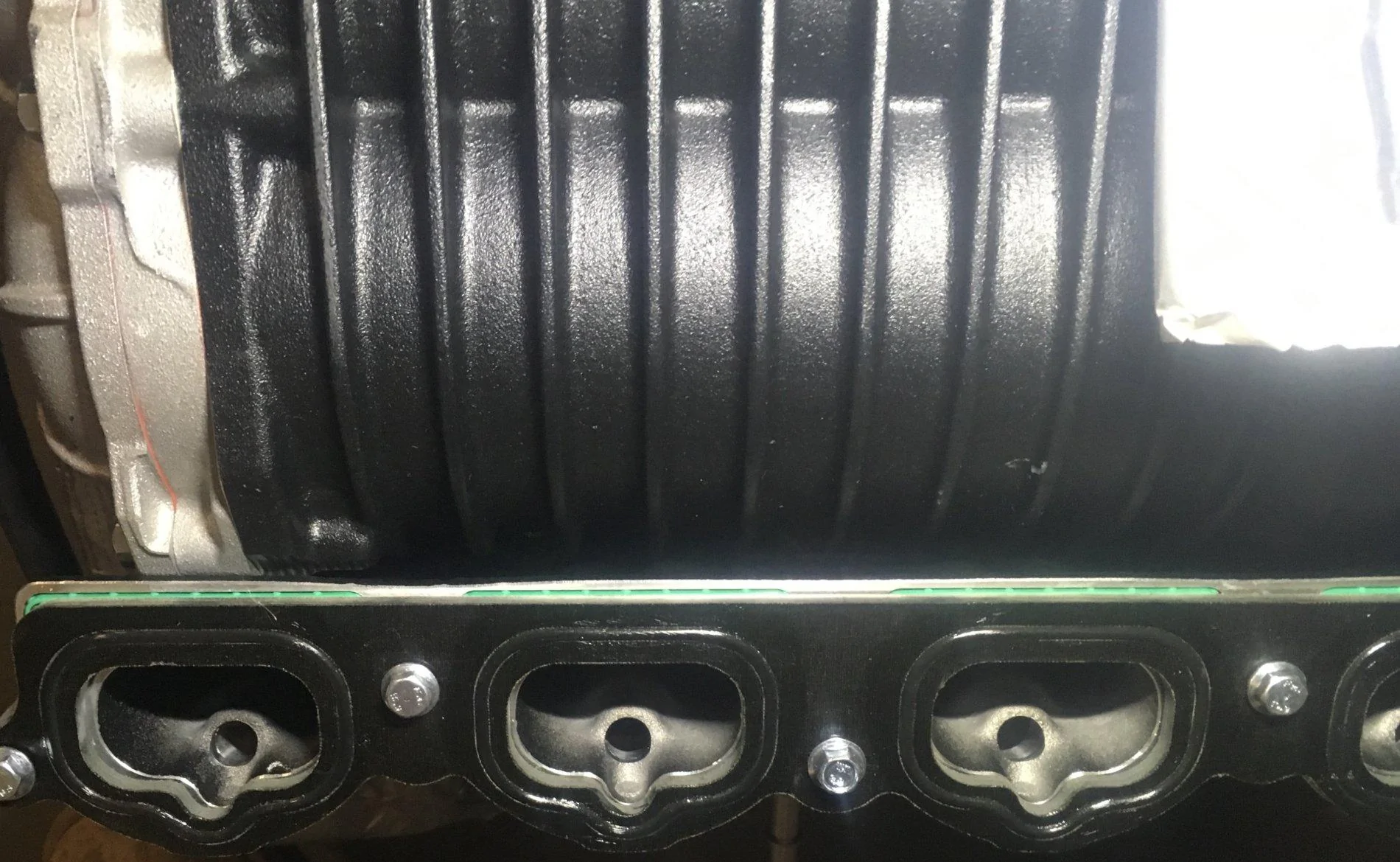

Got the phenolic spacers milled down to just under 6mm. Winning.

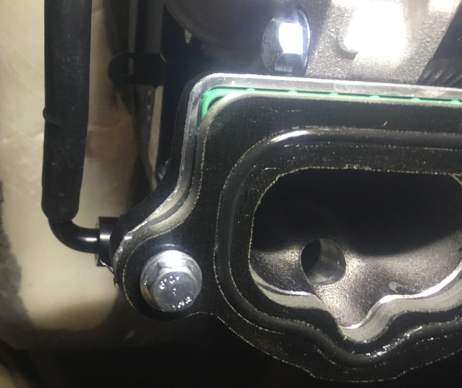

Edelbrock provide grooves for both the small and large type rubber gaskets.
Unfortunately my car has the large ones. I’ll let you guys work out what the problem might be.
Spoke with Matt Coates from MFP about this, he’s never seen that style of gasket used before.
He was more than happy to make a new set for me but I may be able to source the smaller type easy enough.
On the bright side, the extra 6mm height will make the fuel rail install MUCH easier!

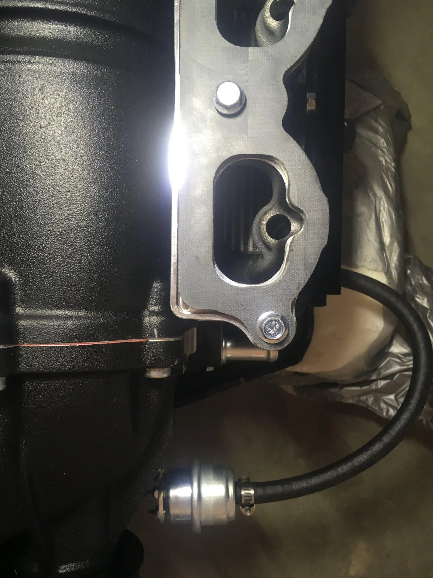

Took the time to port-match the spacers to the heads. They were actually pretty damn close to perfect.
Probably no real need given that the Edelbrock ports are slightly under sized relative to the intake ports of the heads.
Pic shows the typical mismatch. Very little in it really.
