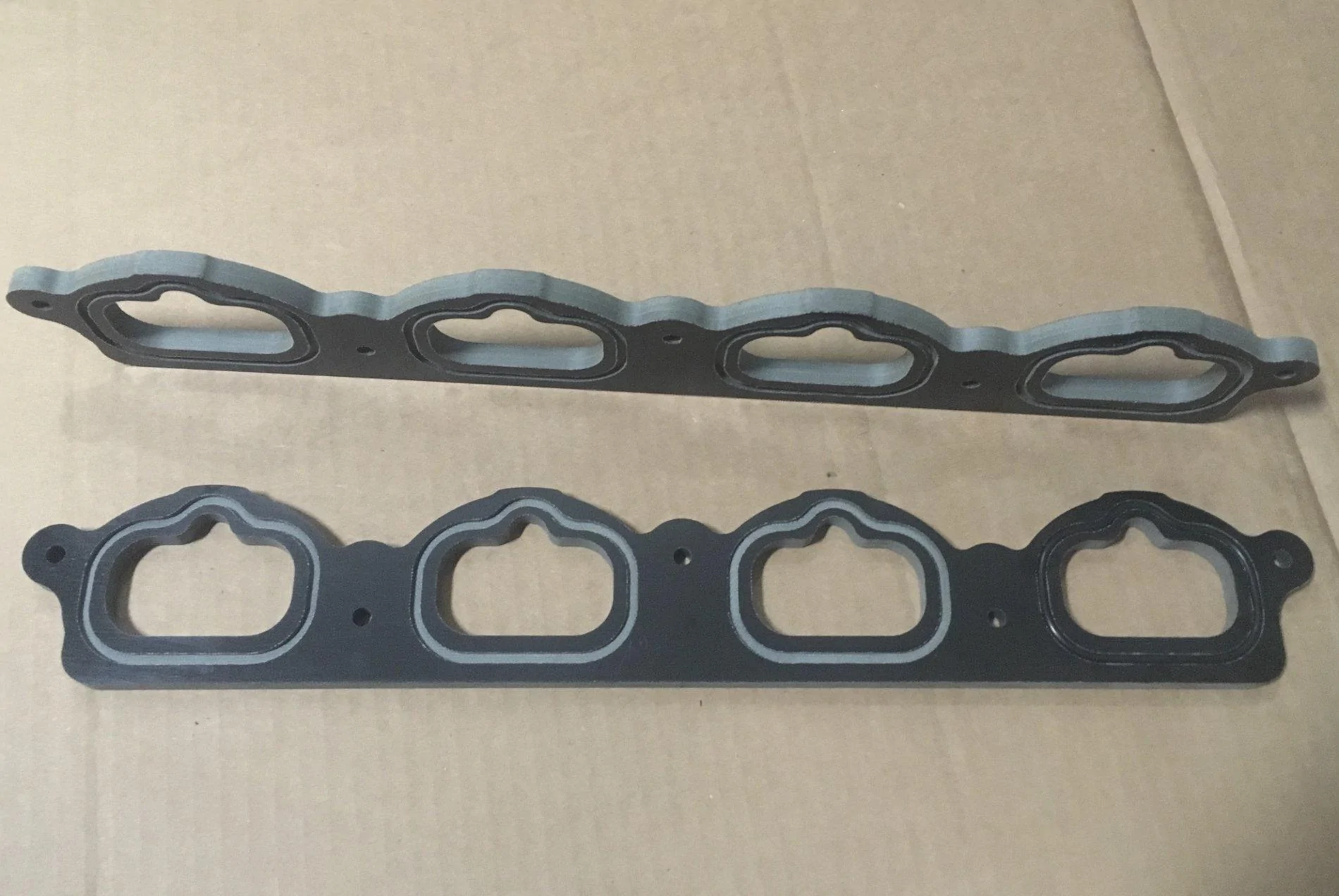

Had to take a few days off the install for work commitments.
Phenolic spacers from MFP arrived while I was away.
Given the amount of trimming a RHD car requires to make the blower fit, I had basically shit canned the idea of fitting them.
They were meant to be 7mm but arrived at 8.4mm.... 7mm was going to be a squeeze but 8.4 isn’t likely to work at all.
Decided to get them milled down to 5 or 6mm, which will mean a little more trimming but the flip side is that it will make the fuel rails a little easier to install.
The bigger trick will be sliding the blower into position without disturbing the spacers.
I have some ideas on how we might go about this. Pics to follow showing methods.

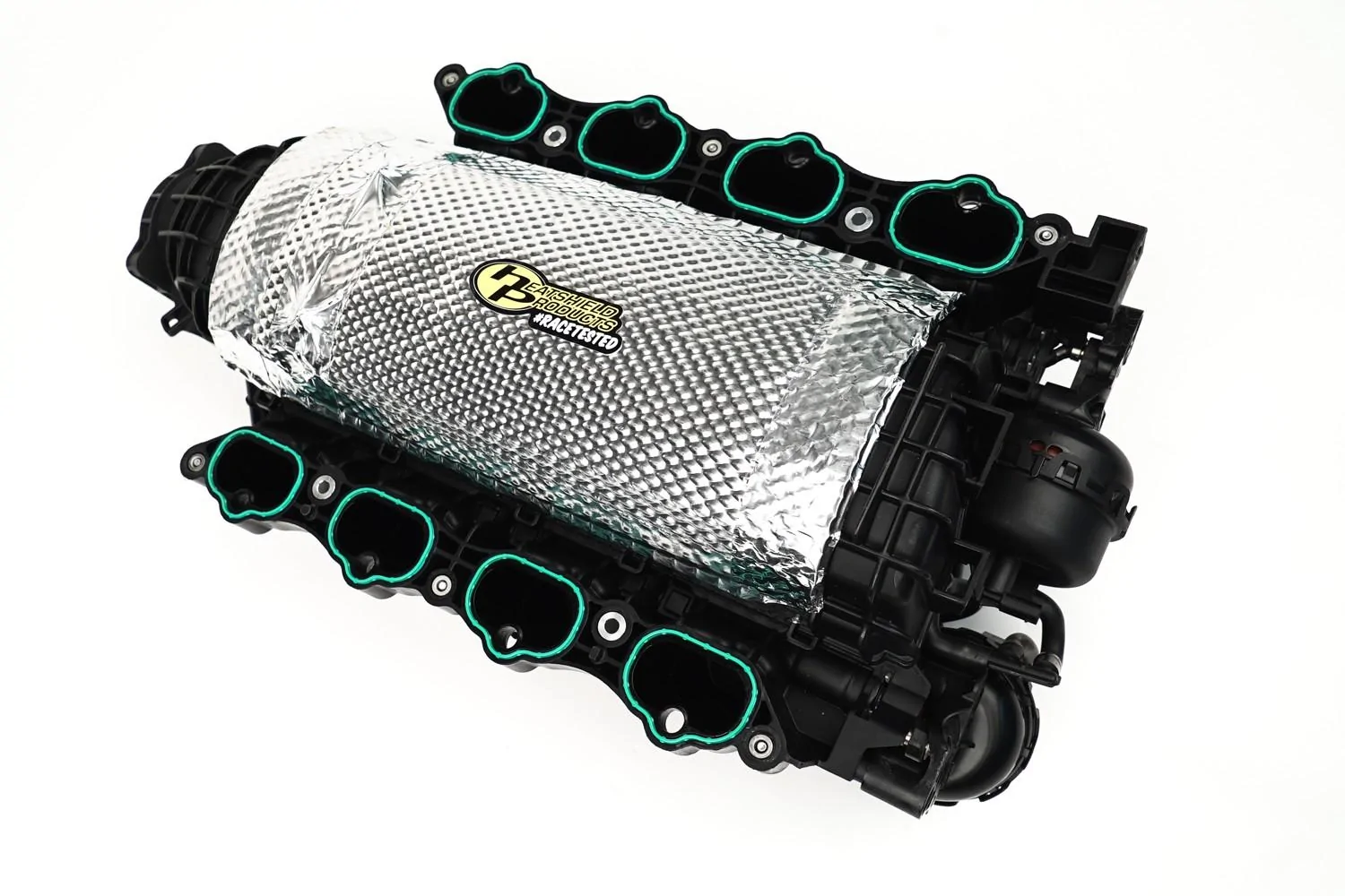

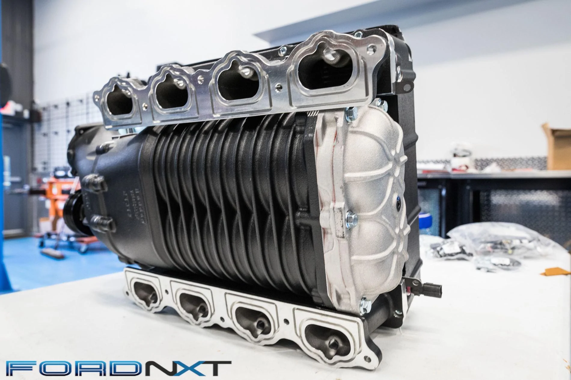

I know you're committed to the idea of the intake spacers, but in this case you might want to consider using some heat shielding on the underside of the blower instead. I'm willing to bet the amount of heat rejection from the system as a whole would be greater. I've seen testing that gained appreciable HP from this mod, like 10-20 hp.
http://www.superchevy.com/how-to/en...ld-install-dyno-test-more-horsepower-for-less
https://www.fordnxt.com/project-car...d-products-coyote-intake-manifold-heatshield/
bolting-on-a-2-65-liter-tvs-blower-boosts-a-coyote-to-770-rwhp-2018-05-22_00-37-59_359978.webp
https://www.steeda.com/Heatshield-P...t-Shield-50L-Coyote-2011-2019-GT_p_16115.html
