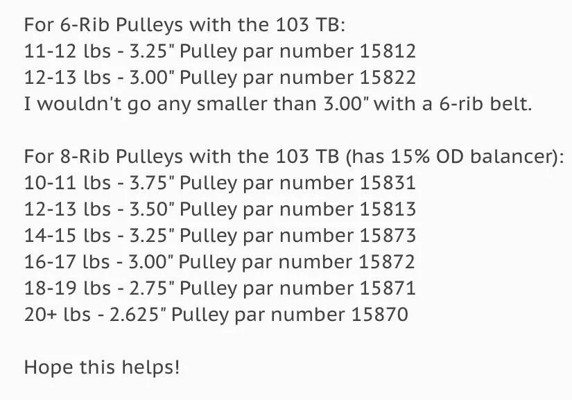

I've thought about doing the same thing, but with a 3.5 (2650) for winter driving. Is there a chart somewhere that shows boost vs pulley size? Does changing it require a retune?
This is straight from Edelbrock.
Just keep in mind that boost will be slightly lower with a smaller TB.

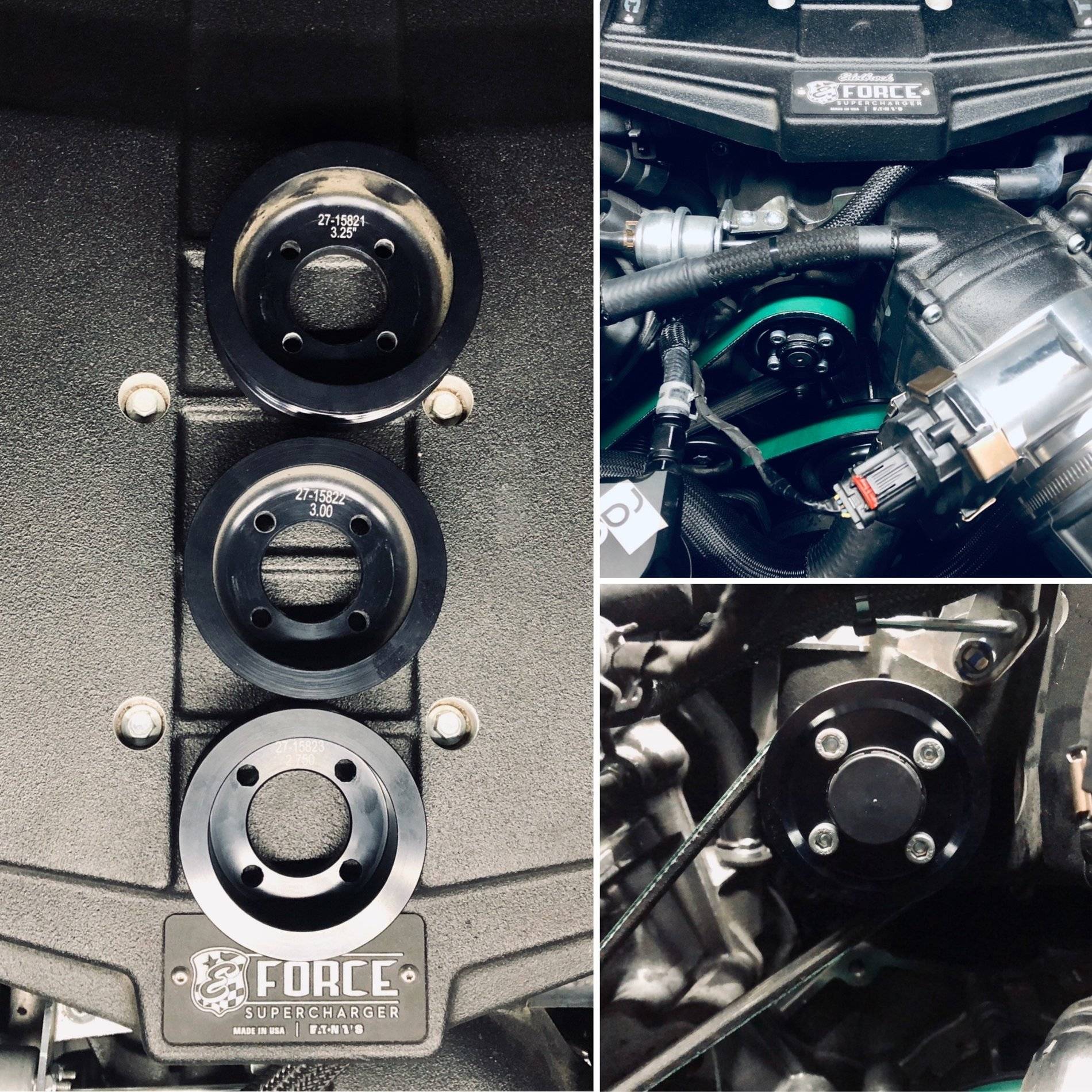

So it looks like the 3" pulley w/817 belt combo is the smallest we can do on the 6 rib, this makes 12psi if you have long tubes. I swapped the 69mm pulley on along with a green 812 belt and while everything fit good and belt was night and tight, the set up still slipped bad. I saw peak a peak of 13psi but this was short-lived as the boost would drop anywhere from 8-12 psi through the same pull.
There is just not enough belt wrap on this small of a pulley. I think it would be possible to run if someone made a bracket to move the idler up close to the blower pulley, sort of how the Hasty bracket works, but I'm not going to bother. Will just stay on the 3" and get the 8-rib set up when I want to run more boost.

This is correct, the 2.75" does not have enough wrap, I just finished testing it and 3" is the smallest you can go on the 6 rib set up

Thanks @Burkey. Did they happen to give you torque specs for installing the pulleys?
I was to say it was like 81 inch lbs with red loctite. I stopped doing that shit after the 3rd swap, those grade 2 chinesium 5mm allen bolts are trash and you'll spin the head right off of them pretty easy.

2 ugga duggas from my cordless impact is tight enough, I've swapped them out quite a few times too
