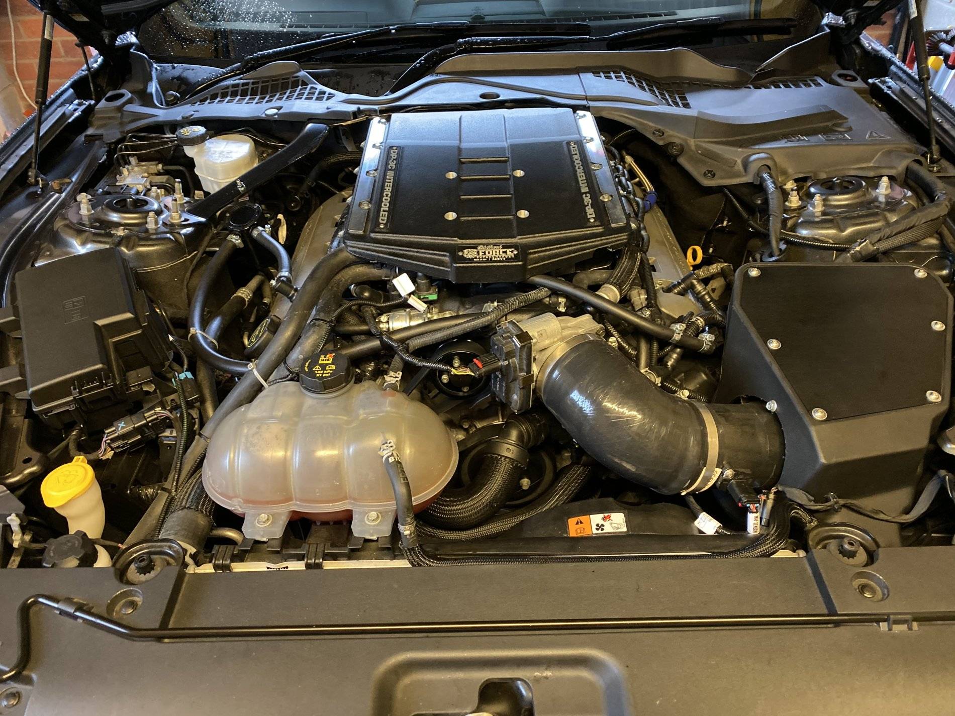

What kind of oil separator setups are guys running with the 2650 kits on 18/19 cars? I was going to go with the UPR dual can setup specifically made for the Edelbrock, but I saw a post on here that is was a garbage kit considering it's $400 price.
I was thinking about just doing the Watson/peterson breather can to the valve covers, and just capping off the intake/TB side ports. I see a lot of the race/turbo guys going this route.
mikengail
Sep 3, 2014
201
151
Albuquerque, NM
2018 Mustang GT Premium Convertible A10
I'm using the UPR you mentioned. Clean install as you can see in the picture. At least it looks impressive.
I have no idea how well it's working though. Palm Beach Dyno can't seem to get my part throttle jerking/bucking fixed and they have stopped responding to my emails. I spend so much of my time on the car data logging and installing new tune versions that I don't have time to bother with anything else...
