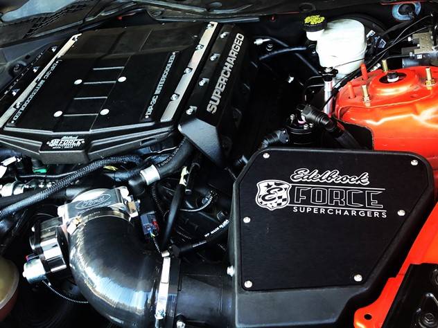

The throttle body won’t do you any good without the modular front. I think you’d be better of with the ford racing 90mm, which if memory serves is as large as your current opening gets. I’m in the same boat as an early adopter 2650.
The opening where the throttle body mounts on the 2300 is 90mm,so a larger TB reallly wouldn't help much. I am running the Ford Racing 90mm TB along with the Edelbrock Comp Intake Kit on my 2300. I installed those items along with DW95 injectors. The $500 price on the intake is still expensive but it used to be $700 for that piece of plastic. Edelbrock must have dropped the price due to people bitching.

There is a stage 2 upgrade kit for the 2300 blower it is PN 15866 and has a valid EO#:
https://www.edelbrock.com/e-force-supercharger-15866.html
The Edelbrock Stage II Upgrade kit part # 15866 allows customers using the 1586/15865 supercharger (2015-2017 5.0L Mustang) to upgrade to stage 2. The Edelbrock Stage II Upgrade kit #15866 includes a complete, competition air intake system, 90mm Throttle body with adapter, fuel pump upgrade and an updated calibration file.
I bought a while back but Fred @Evolution Performance gave me a great deal.
I have it on my car now with same 2300 blower.

I saw that one too but the title says its for the 2650 even though the part number in the description says for the 2300. Confusing.
Both the 2650 and 2300 can bolt up to the stock tb, so the adapter should still work. The airbox shouldn't see a difference. I imagine the only difference would be the calibration file?
