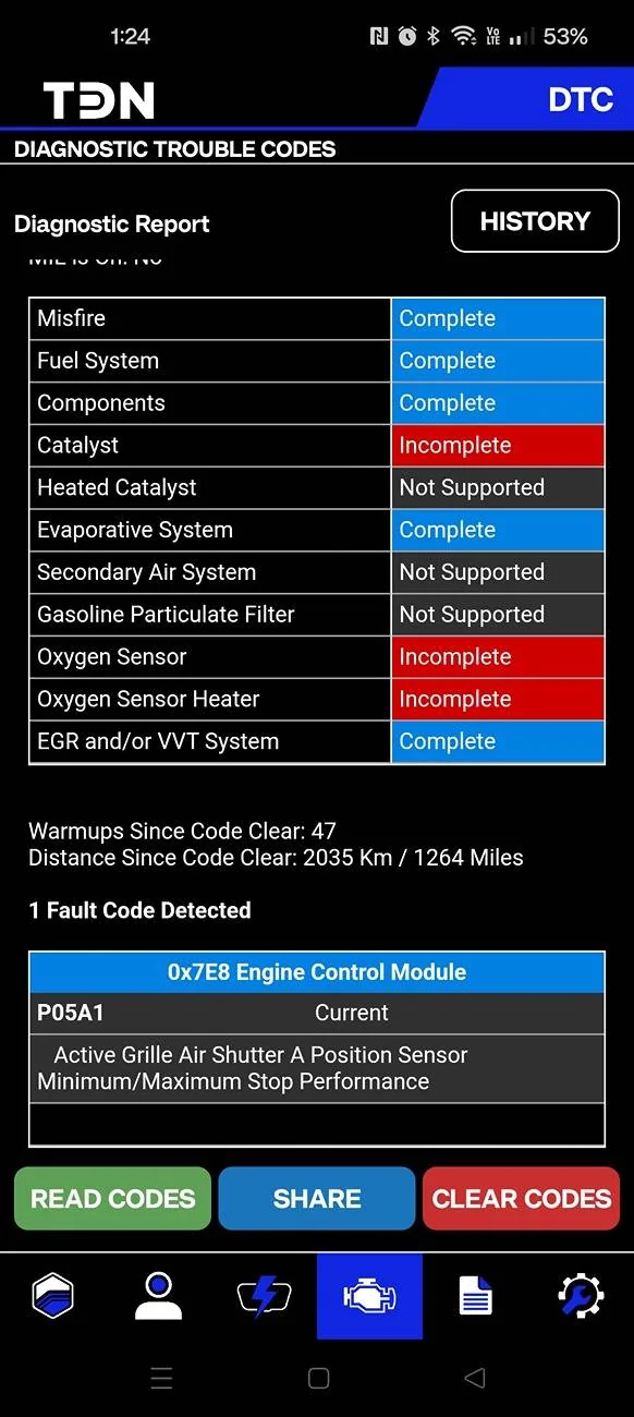

Back again guys, so last year after the install and remote tune from Lund everything was fine. This year I got it out late in the year and have been experiencing the slight hesitation and surging/bucking that I've heard about. It happens around 2200rpm while cruising at a held speed, could be any gear. As soon as I slightly lift off I get that hesitation thing happening. I contacted Lund and they mentioned 02's but then said check for codes. The only code that came up was P05A1.
Now Lund said it should have been tuned out and said it's $150 to do it. Either way I don't think that's the issue. I'm off to Woodward this weekend and will do some datalogs on the highway. The issue isn't anything I can't drive around and wanted to know if it's worth having it looked it by Lund? In addition to that I asked Lund if I installed Long tubes would the cost to retune be the same at $150? They told me anything exhaust related didn't need to be tuned..... Can someone verify this for me. Thanks for your help guys.

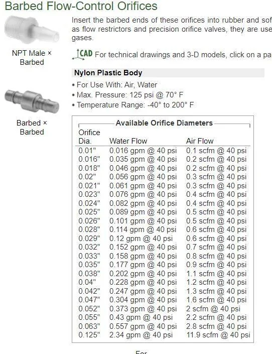

I ended up replacing the pill with a different size orifice. Tried quite a few before I got it feeling perfect, but it's been so long my McMaster history won't bring it up.
