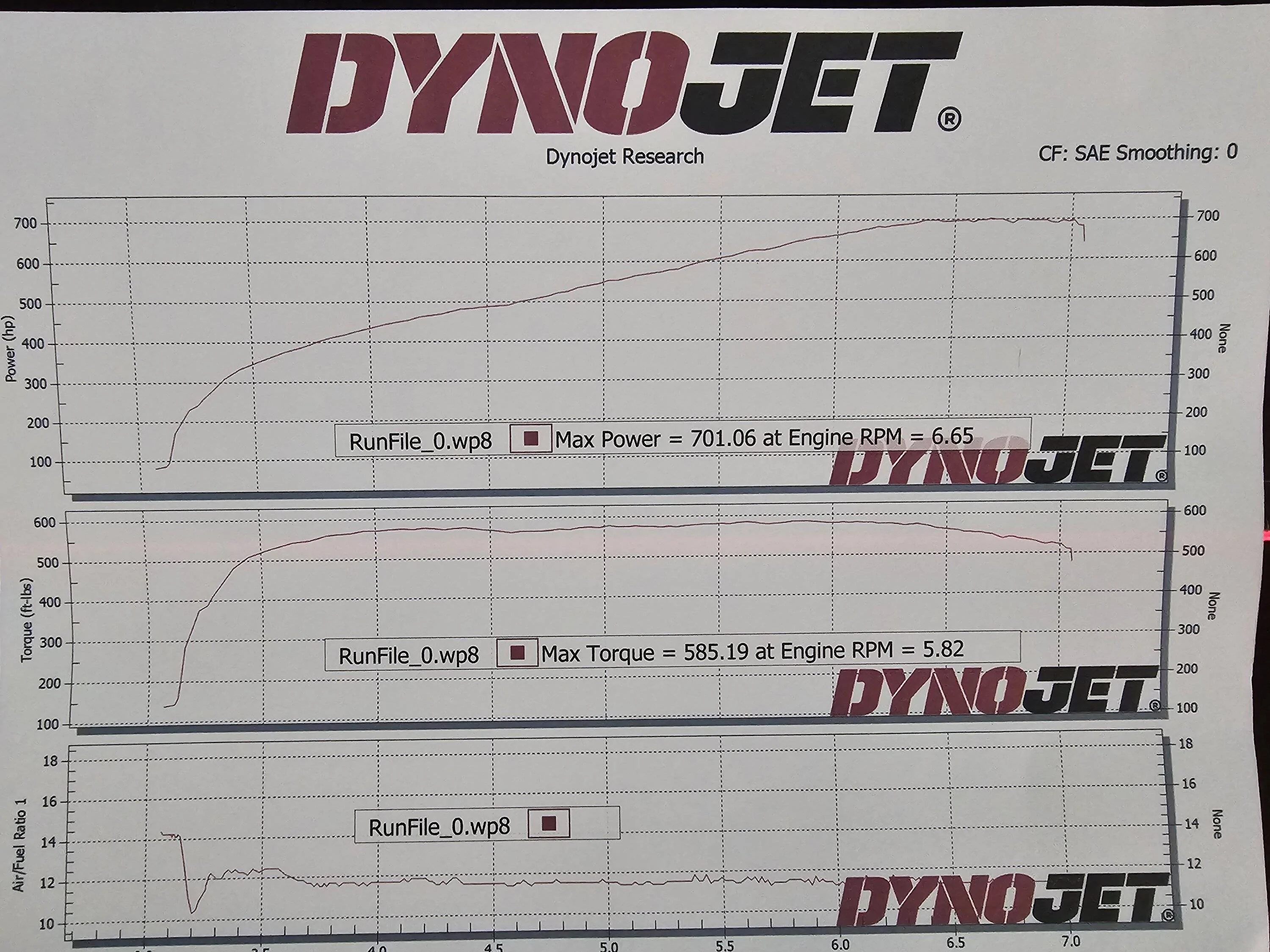

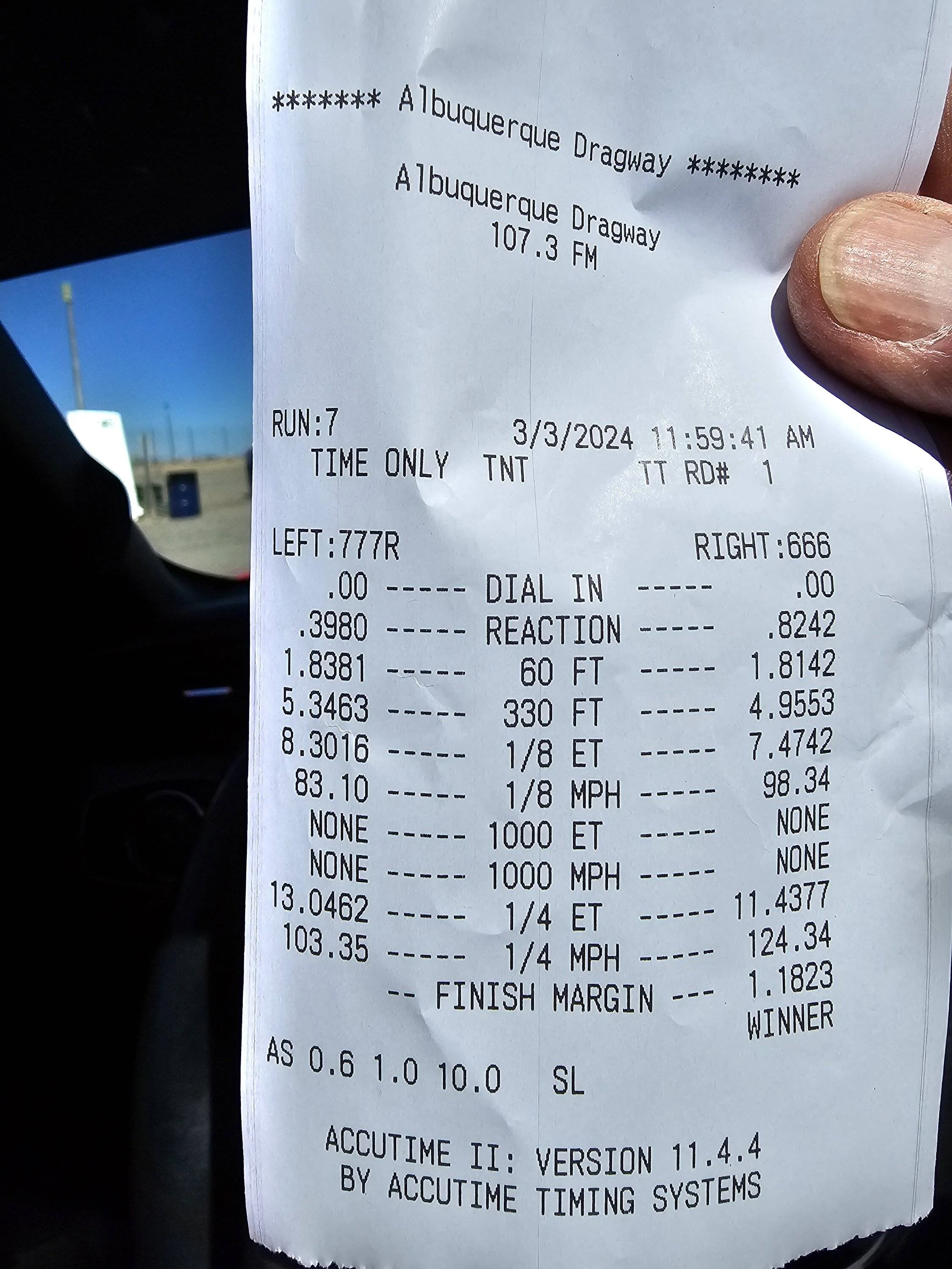

Got her on the dyno with the Soler 103mm Throttle Body. 701 rwhp / 585 rwtq. Dyno guys said the logs showed air/fuel as rich as 8 at one point. Sending those logs to Lund today. Ran her at the track last Sunday. 11.4/124 was my best run. No traction. I used Nitto NT05R drag radials in a 305/35-R19 size. I tried different air pressures of 19, 18 and 17 psi, plus I warmed them up really good in the burnout box. They still wouldn't stick and spun through the 1st three shifts in the A10. DA was over 7000 ft, so that didn't help either. She's fat at over 4,000 lbs. Dyno guys suggested starting at 22psi for the Nittos, since she weighs so much. I'll try that next weekend...

Nice!
So you got your 700 whp!
you went from 697 to 701 with the TB? Kinda thought it would be more. Nevertheless, that’s awesome!
What were your 60 foot times at the track? 1/8 mile time and mph. How many mph did you pick up on the back end?

I was expecting a little more too. Lund says the bigger TB would come into its own with more boost and E85. ID1050x should be here by Friday. Dual pump return style fuel system, after that. No hurry on my end. I need a better rear tire/wheel combo more than anything else right now.
I'm going to to give the Nittos another try next weekend starting at 22 psi and going down a pound or two, after that. If that doesn't work, then I'll try a 17x11 rear wheel and M/T or Hoosier slicks. Throwing more power won't help, if I can't get her to stick.
Lastly, I'm going to watch the DA predictions and try to run when it's under 5,000 ft. Hopefully, they will start running in the evening here soon. This is the first time I've ever raced this car. I didn't get the roll bar installed, until too late in the season last year...
