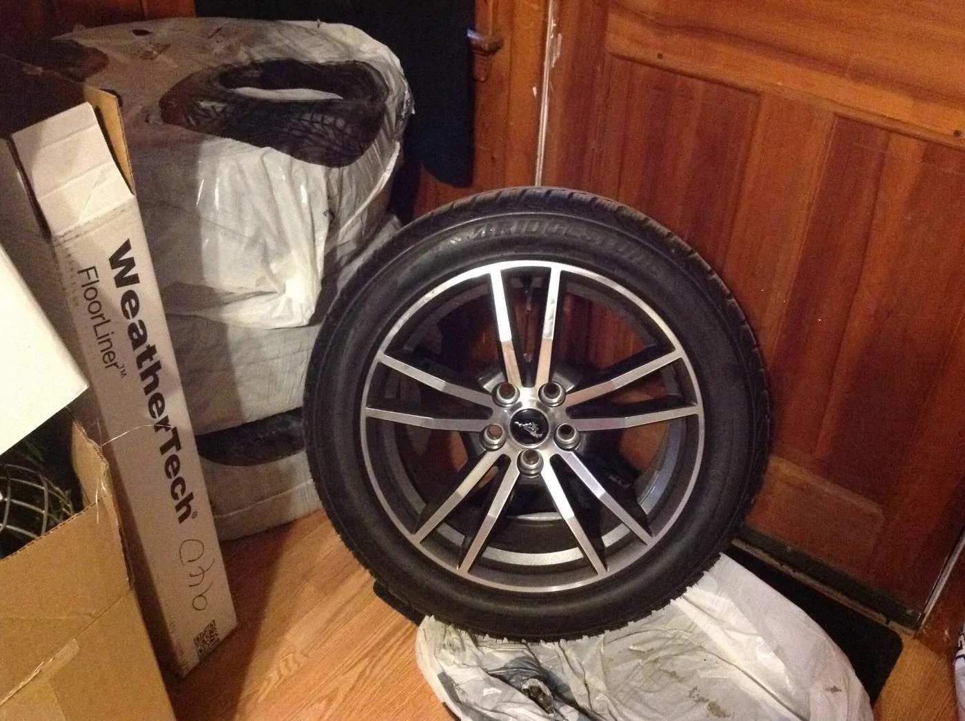

I ran these 255/45/18 blizzack on this 18" non-PP wheel this past winter.
Put it in snow mode, drove smartly and didn't have any issues.

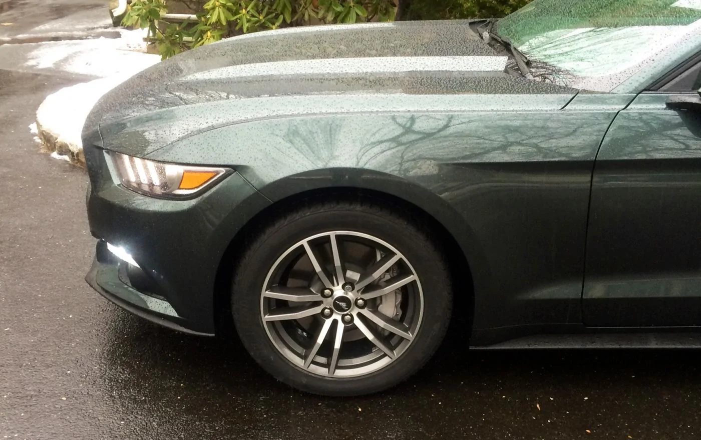

Here they are on the car.
