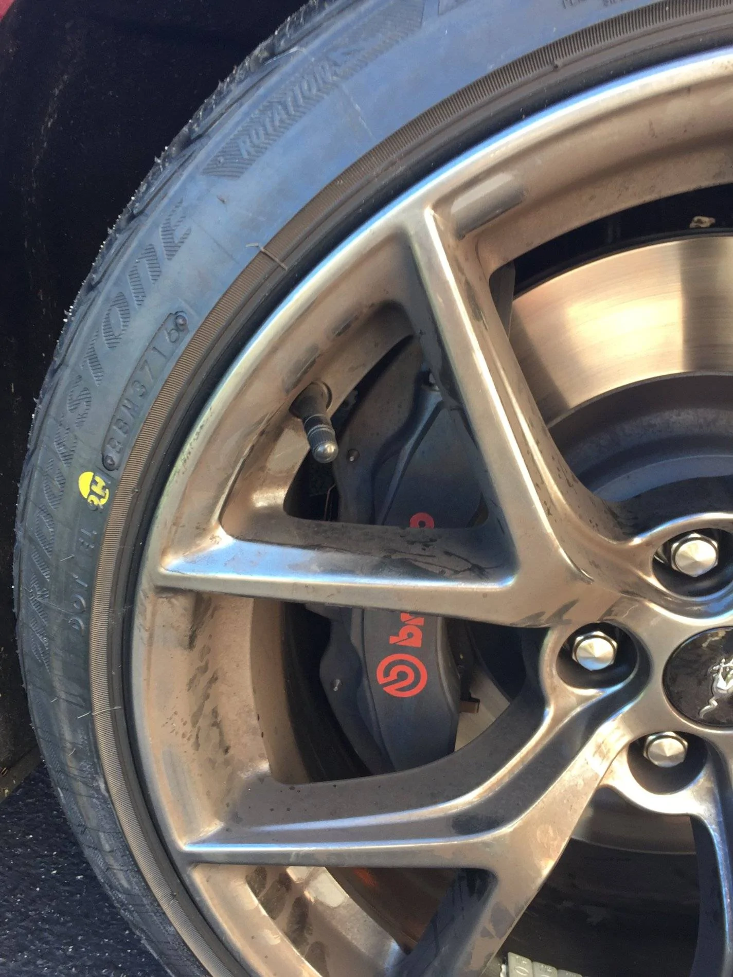

Just a note, 275/35 on the OEM wheels make it very easy to scuff the rims so watch out for getting too close to the curbs

No problem. The guys were so great they even walked the rim on by hand to keep the rims nice.

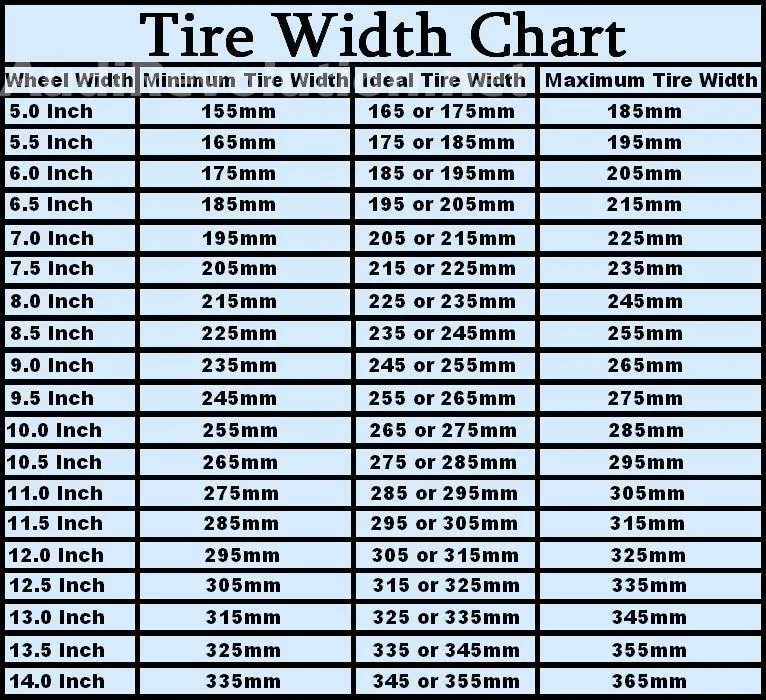

a 275/35R19 is within allowable fitment range
Looking at 11" wide wheels, a 275 is the narrowest recommended.

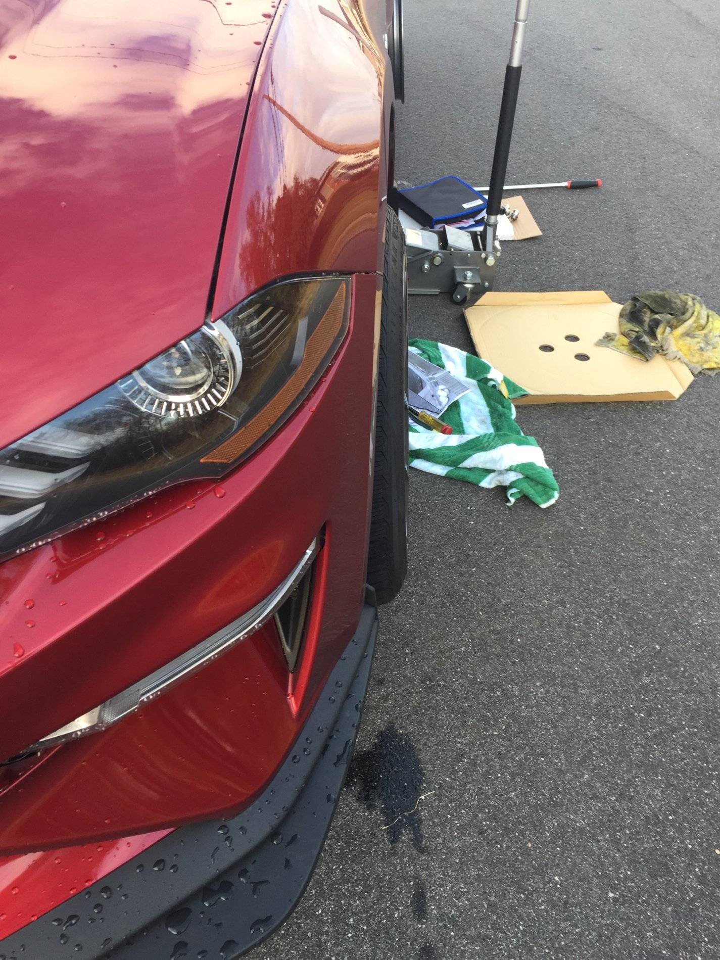

Also looking at the chart, a 9.5" wheel can also take a 275 wide tire. this is why I (as you can see in the jack photo) am purchasing a set of VMR V710 wheels in 19x9.5ET22 for the front and 19x9.5ET45 for the back. I wanted to keep the track width as close to stock as I could. Yes, even though we lost 1" in width and stayed close to the 24mm offset, the front still stick out a little. That same day, I put on a set of RokBlox mud flaps to protect the paint as bit more. Also installed the BMR jacking rails this I were using in the shot. Makes life so easy to jack up a car. I am using jack stands but out of habit, I leave the jack with light contact in place in case something should happen.

I use this tire size calculator to see how different sizes fit compared to stock. It takes in wheel and tire data and even spacers to see how the resultant will fit.
https://www.tire-size-calculator.info/
In the winter, you want a narrower tire than stock. For snow, they often recommend going 1" or 2" narrower than stock. To minimize speedometer alterations( and possibly other things in the drive ability of the car), you should try to keep the diameter the same.
For a PP2, 1" smaller would be a 275/35R19. 2" smaller is either a 245/40R19 or a 255/40R19. The 255 will be larger. I have read they recommend keeping the change in circumference at or below 3% from OEM. Of course, the 245 or 255 will never fit a 11" wide rim. You would need a 8-9" rim for that (see chart above).
The reason for wanting narrower is the opposite of snowshoes. With snowshoes, you want a wide base so you will sit on top of the snow. For cars, you want to cut down into it and contact pavement. Narrower tires also help promote straight line driving since the contact patch is more orientated along the long axis of the car.
I will admit that the 275 were more snowshoe like but were far better than any summer tire and I am sure better than many ( if not most) all season. The winter tire is more pliable in cold temps and with al the sipes and channels, it will collect snow (a desirable thing) for traction. Snow grabs snow better than rubber does so collecting snow is a good thing.

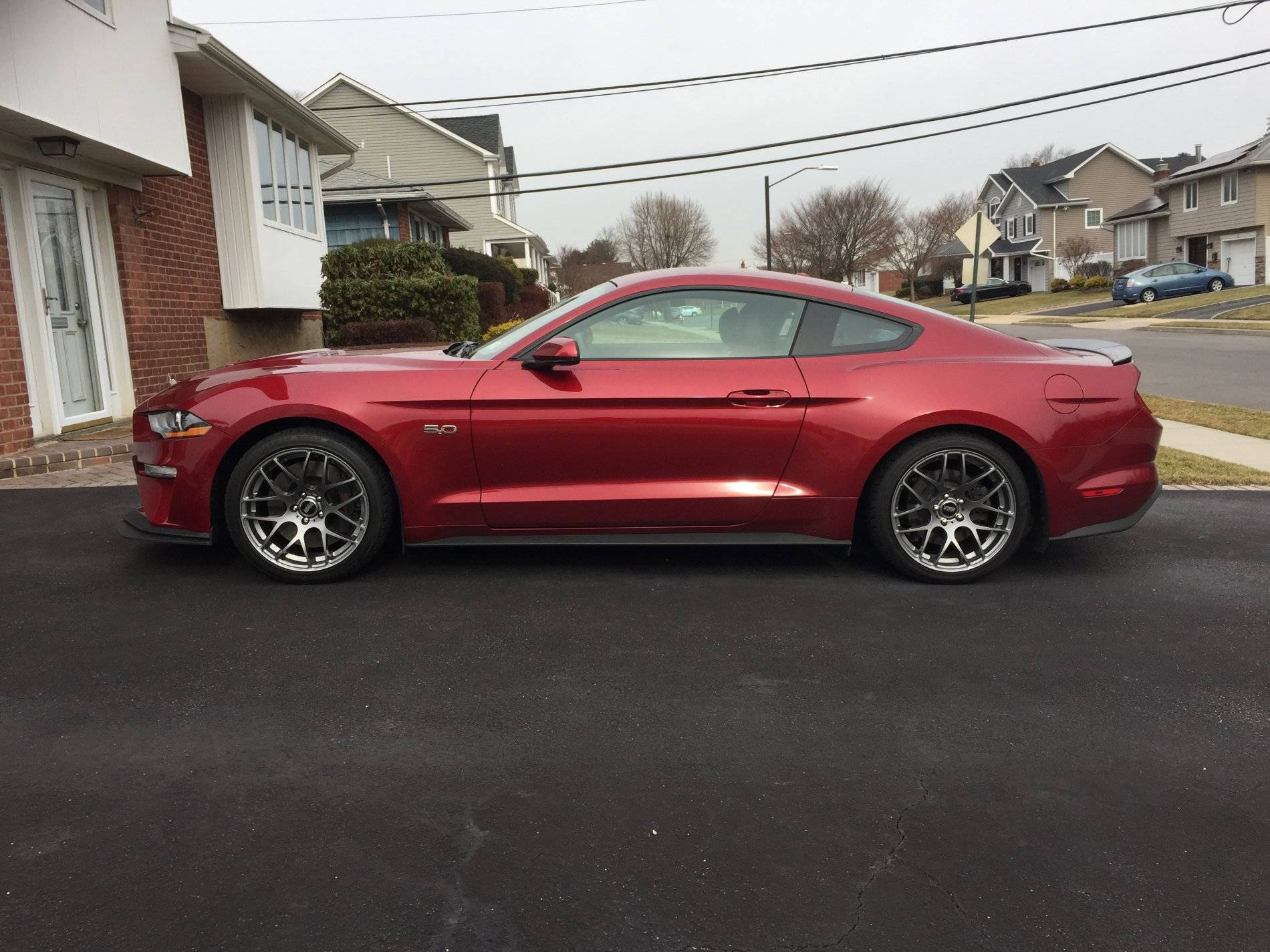

Here is my PP2 with VMR V710 gunmetal wheels (Fr: 19 x 9.5 ET22, Rr: 19 x 9.,5 ET45). Wheels are the Blizzak LM-32 275/35R19
