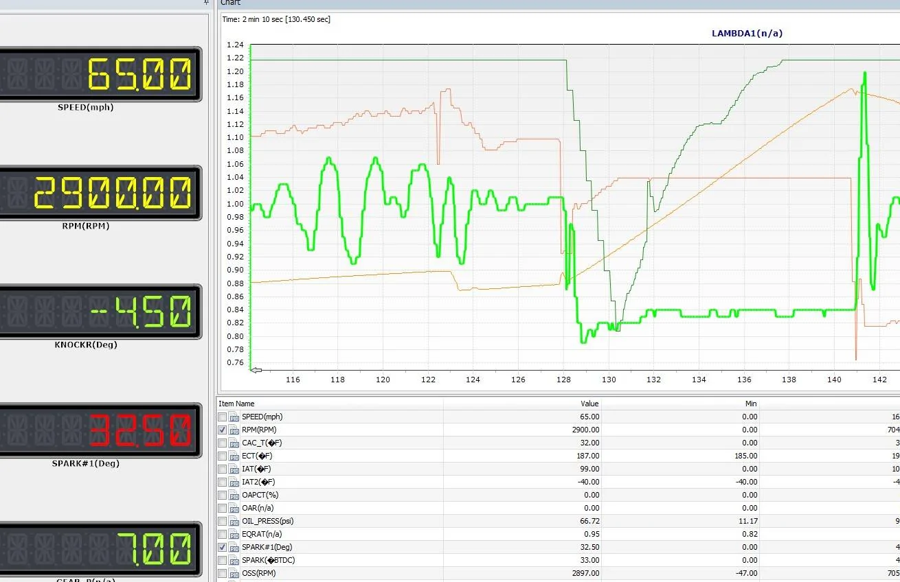

Aggressive is more about how fast the low rpm spark is ramped in ..
My 2018 Gen3 'E85 Race' tune dialed up 32.5degrees WOT and had an aggressive ramp in .
Here's snapshot of a 2000-7000rpm 7th gear pull I logged.
That run had started with 19degrees as soon as I went WOT and hit 32.5degree and the knock sensor added another 4.5 at 2900.
That was a A10 PP1 with O/R LT's and for a Coyote, it pulled like freight train ...
Are you saying you are running 36+ degrees of timing? or is it 32.5 with the addition of the knock sensors?
That was a 'drag mode' tune and it had 32.5 degrees timing plus whatever the knock sensors dialed in on the hit.
And I had a couple logs showing 38 in 3rd and 4th.
We were just about finished with that tune when that car was killed.
