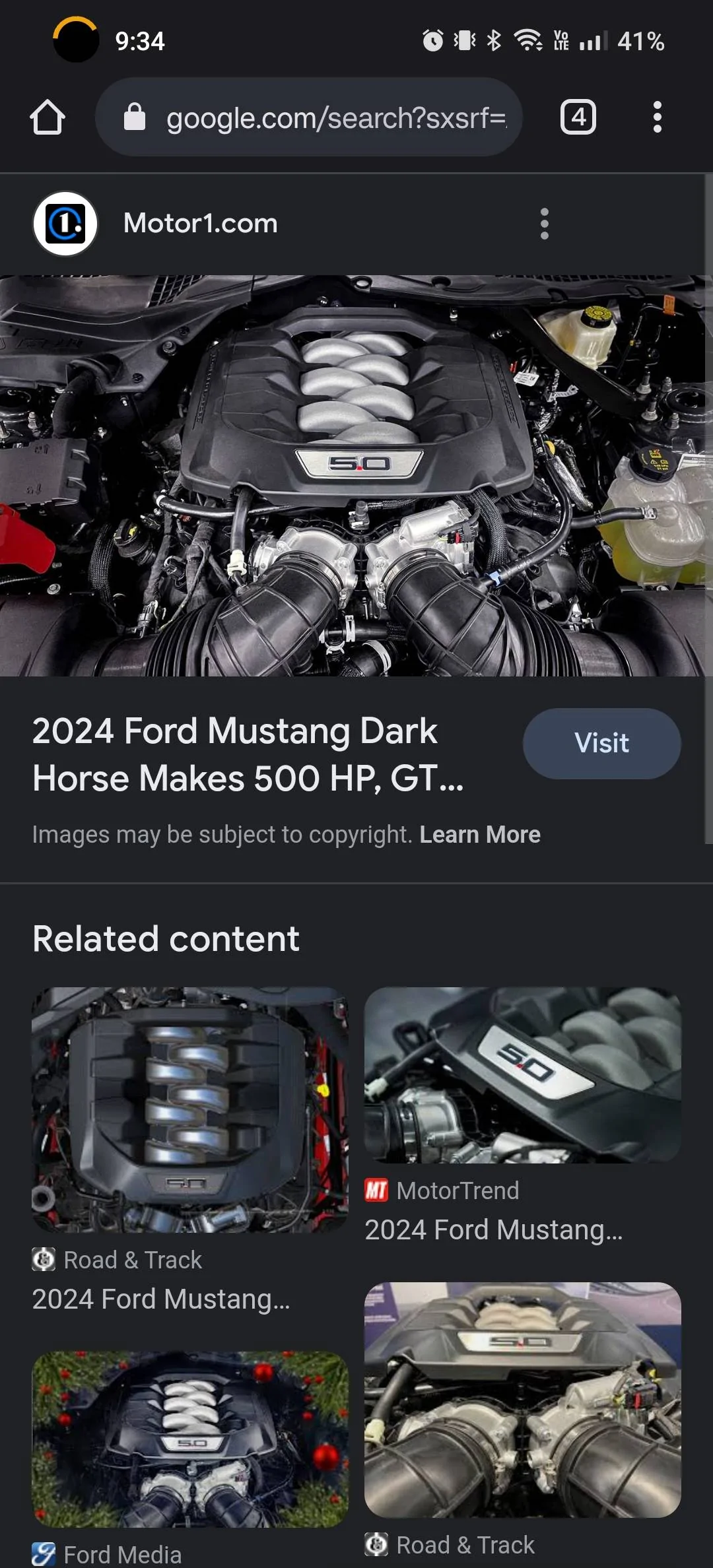

Earlsays
Aug 27, 2015
76
521
242
KATY, TX
2021 MUSTANG GT
I wonder if that new engine cover/intake cover would be a 2018-2023 solution to replace the ugly ugly that is on there now.
