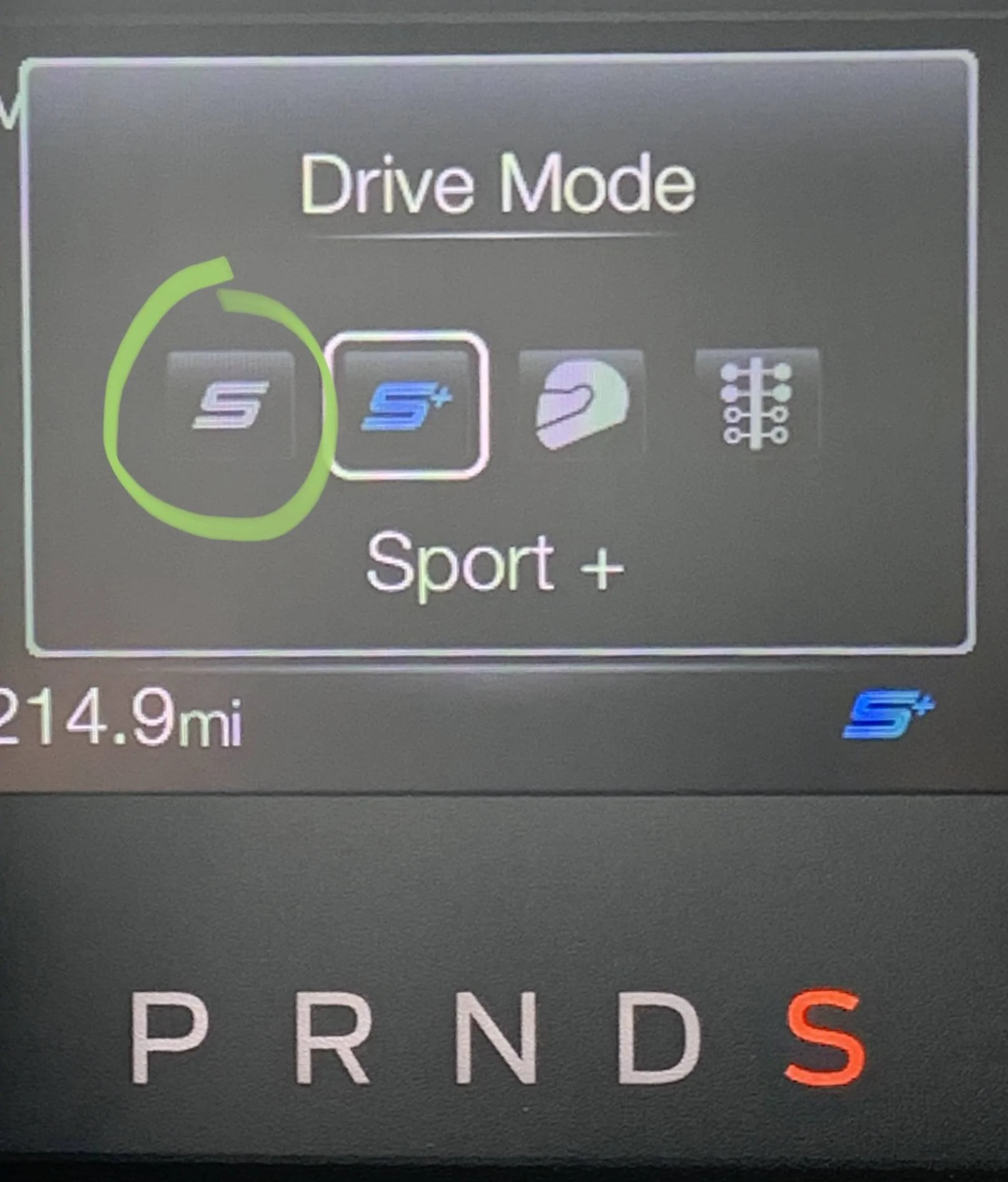

First - I want to clarify all of the below is ONLY for and in reference to an S550 equipped with an AUTOMATIC transmission (10R80 for current subject matter). TRANS Modes are absent on MT82 equipped S550's, so let's get that out of the way now.
Second - The (4) doc images are from the 2018 S550 Owner's Manual regarding AUTOMATIC TRANS Modes (D and S) and the various DRIVE Modes (Track, [Sport - auto trans only], Sport+, Drag, and Snow/Wet).
Third - This is the info regarding "SPORT" according to the Owner's Manual "DRIVE Mode" section. This excerpt was taken from the image snip seen further below. PLEASE NOTE - "SPORT" is NOT to be confused with "Sport+."
Sport - Engages when you shift your automatic transmission into sport (S). Sport mode increases throttle response and helps your vehicle accelerate faster, but does not change the vehicle dynamics or stability system.
What makes the above "SPORT" info even more confusing is IF one reads the separate annotations outlined in the Owner's Manual for TRANS Mode (S)port and DRIVE Mode (S)port, the Ford tech doesn't really mesh and still separates the (2) types of Modes from each other. What the User has to keep in mind is this: DRIVE Mode "(S)PORT" does NOT exist in the DRIVE Mode menu selections UNTIL TRANS Mode "(S)port" is selected using the Transmission Gear Selector.
See actual gauge cluster images below for further explanation of #3 above which will help to understand the Owner's Manual statement for DRIVE Mode "(S)port". The (3) dash cluster images are from my own 2018 w/10R80:

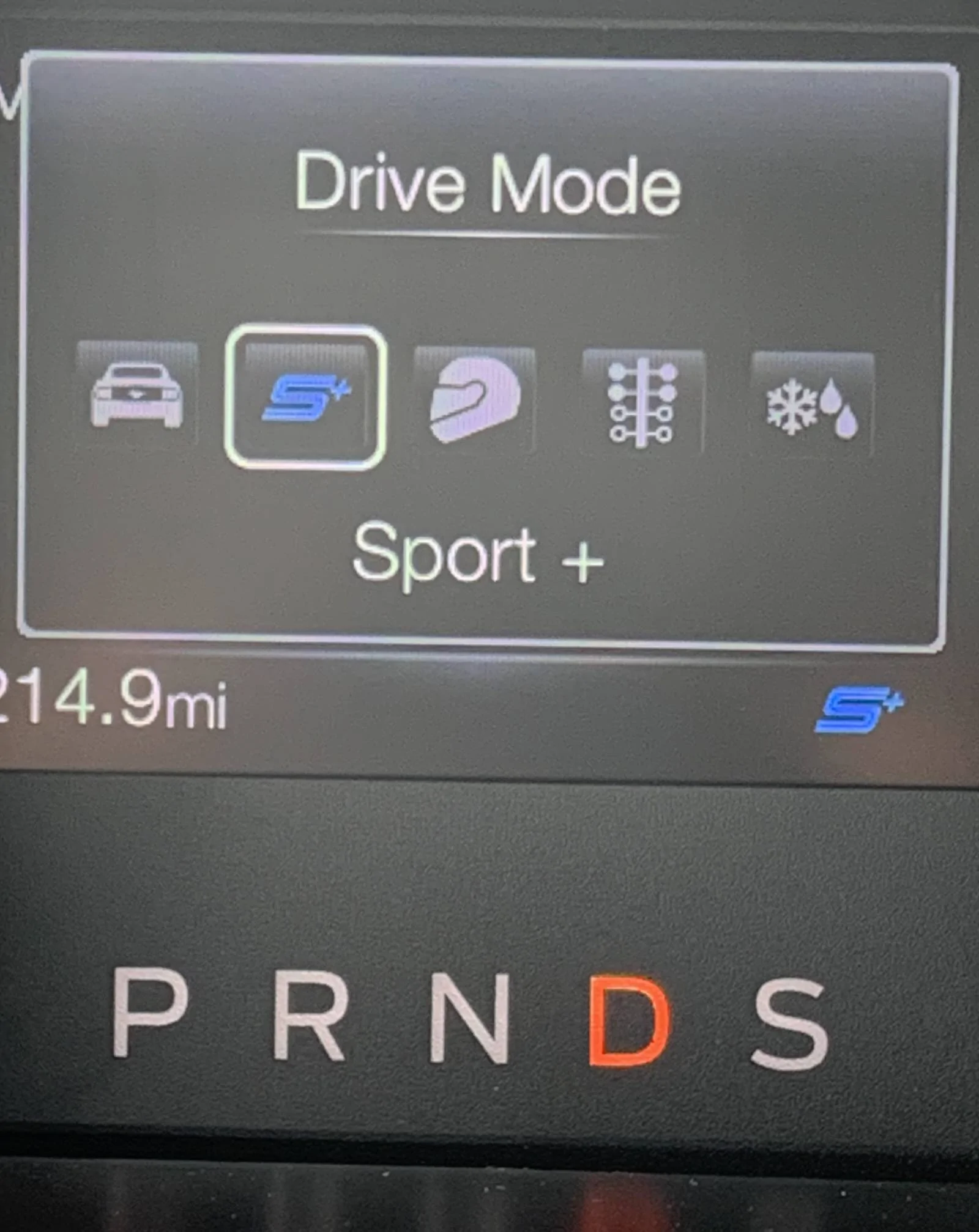

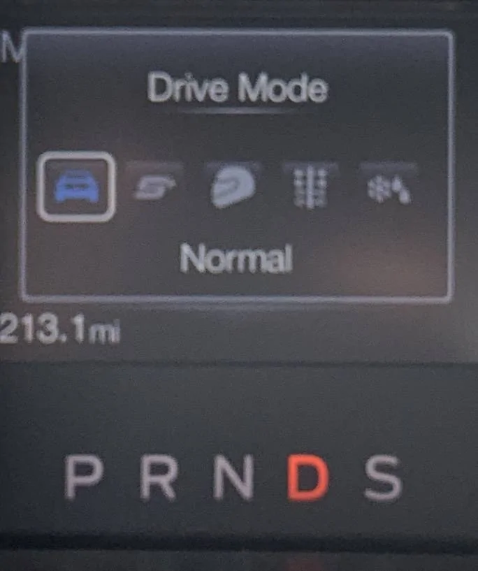

In this below image, when the TRANS selector is in D(rive) and DRIVE Mode toggle switch is toggled, these are the available DRIVE Mode menu options. The first icon it is on is DRIVE Mode "Normal". Notice in the DRIVE Mode menu selections, a "(S)port" Mode icon does NOT exist in the menu options at all:
In this below image, the TRANS Mode is still in "D" (Normal), but for the DRIVE Mode
Menu option, I have chosen the S+ (Sport+). Again note that the DRIVE Mode "(S)port" icon is NOT available in the list.
In this last image below, TRANS MODE "(S)port" is selected by putting the Transmission Gear Selector into "(S)port". The DRIVE Mode toggle switch was toggled again, BUT in this instance now notice that the DRIVE Mode "(S)port" icon IS present in the menu options (circled in green). Also notice that DRIVE Mode icons "Normal" and "Snow/Wet" are no longer present. This is the ONLY time a user will see the DRIVE Mode "(S)port" icon available in the DRIVE Mode menu options.
TRANS Modes "D" (Normal) and "(S)port" are accessible using the automatic Transmission Gear Selector. The Trans modes affect the TCM TRANS operation and transmission performance. These (2) pages apply to 10R80 for 2018+ S550's (the general operational guidelines aside from available trans gearing, also applies to prior 2015-2017 S550's w/ 6R80). Also below that is the info regarding how "SelectShift" works and how TRANS Mode "(S)port)" will react when using paddles:
DRIVE Modes (Normal, [Sport - auto trans only], Sport+, Track, Drag, and Snow/Wet) for an S550 with MT82/10R80, are accessible via the MODE toggle switch at the bottom of console center stack. The DRIVE Modes affect the PCM ENGINE performance and are essentially "canned" factory tune mappings based on the DRIVE Mode selected. These (2) pages apply to 2018+ S550's (but again, also apply to prior 2015-2017 S550's with MT82/6R80).
I hope the above better clarifies the questions regarding TRANS Modes vs DRIVE Modes and offered further clarification of just the "(S)port" function in an S550 equipped with an AUTOMATIC transmission.

Can confirm in my Mach 1 it does not allow me to change steering mode when in sport+, track, drag modes.
