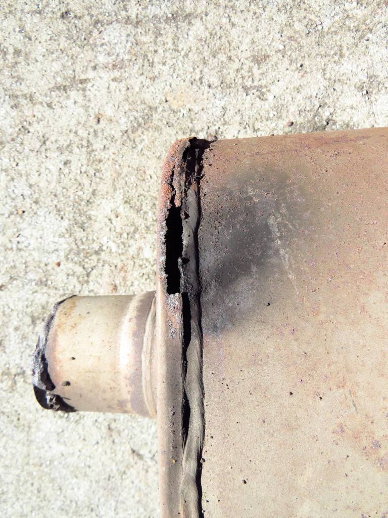

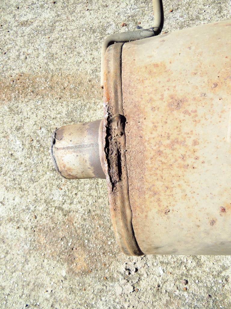

I asked Magnaflow about drilling a weep hole in their mufflers and they promptly said it would VOID their Lifetime Warranty.....GO FIGGER??:crazy::facepalm:
Good Luck and curious what Borla might have to say??:sunglasses:

My Magnaflows were too........welds musta been mild steel since they rusted out at the welds!!:curse:
I still wonder why Magnaflows have no weep holes when most OEM mufflers have holes to drain moisture!!??:sunglasses:

In my experience, magnaflow cheaps out on the stainless they use, they only use the better 304 on the outermost shell of the mufflers. The pipes, inner structure of the mufflers, the hangers are all 409, a much cheaper grade of stainless that will eventually rust out. That's why magnaflow is cheaper pricewise than most other brands. On the other hand, companies like borla use 304 thru-out the entire cat back system

Surprised at the photo that Borla used - weld quality on the pipe exit isn’t the best for an official photo ?!
As already mentioned - that photo of the rusted out muffler has me thinking it’s not 304 ? 304 under most conditions will show little more than some mild surface discolouration (not normally rust coloured either).

WD your right, I forgot about that. They are probably just 409 stainless. or it was a counterfeit muffler made to look like a magnaflow. On the past magnaflow systems I had, only the pipes had surface rust, the mufflers and tips were still shiny even after several years of winter driving in the rust belt. I have always known magnaflow to be a "Legit" company who stands behind it's product and doesn't claim its product is what its not. So maybe the bad muffler was a counterfeit. Maybe at one time they made mufflers entirely out of 409, but I've never heard of it.
