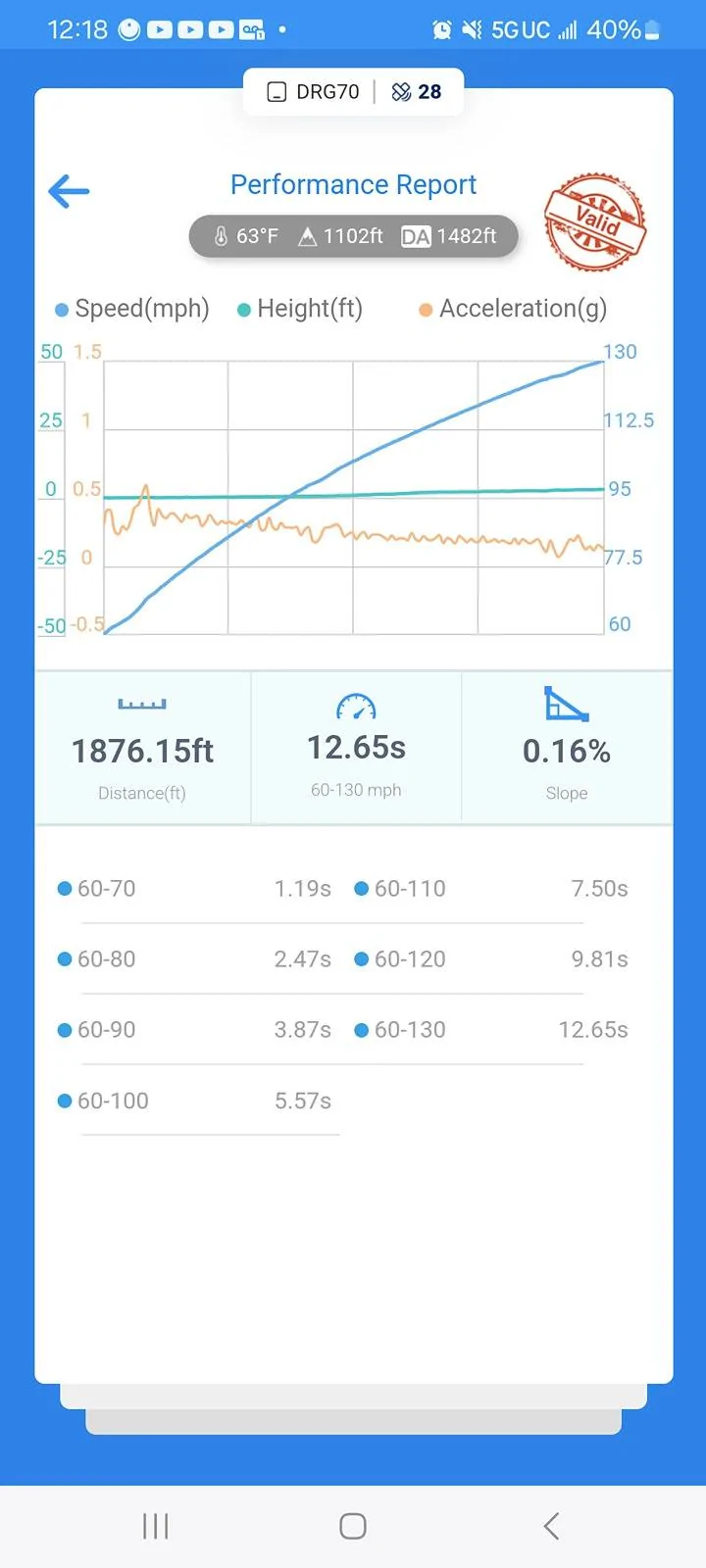

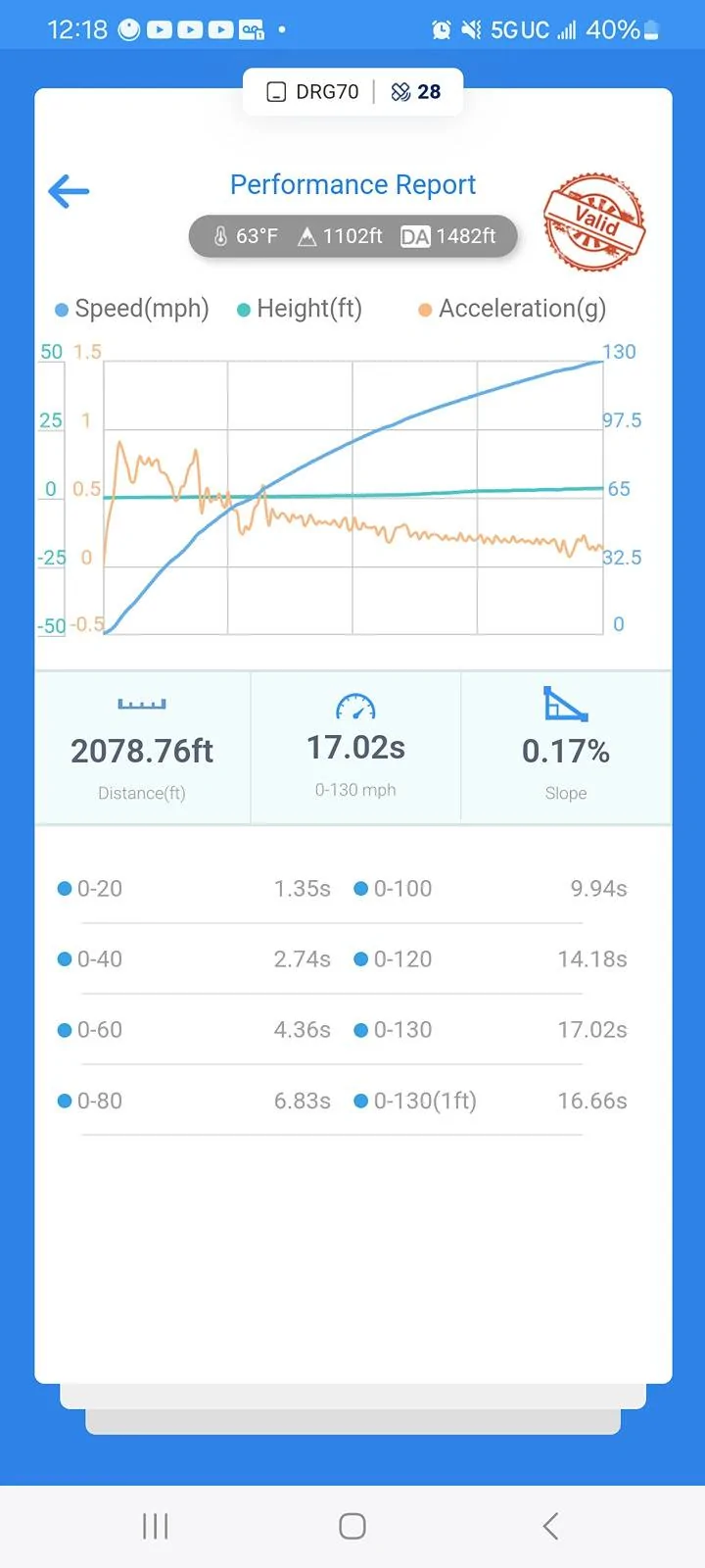

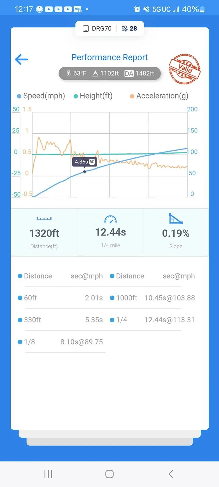

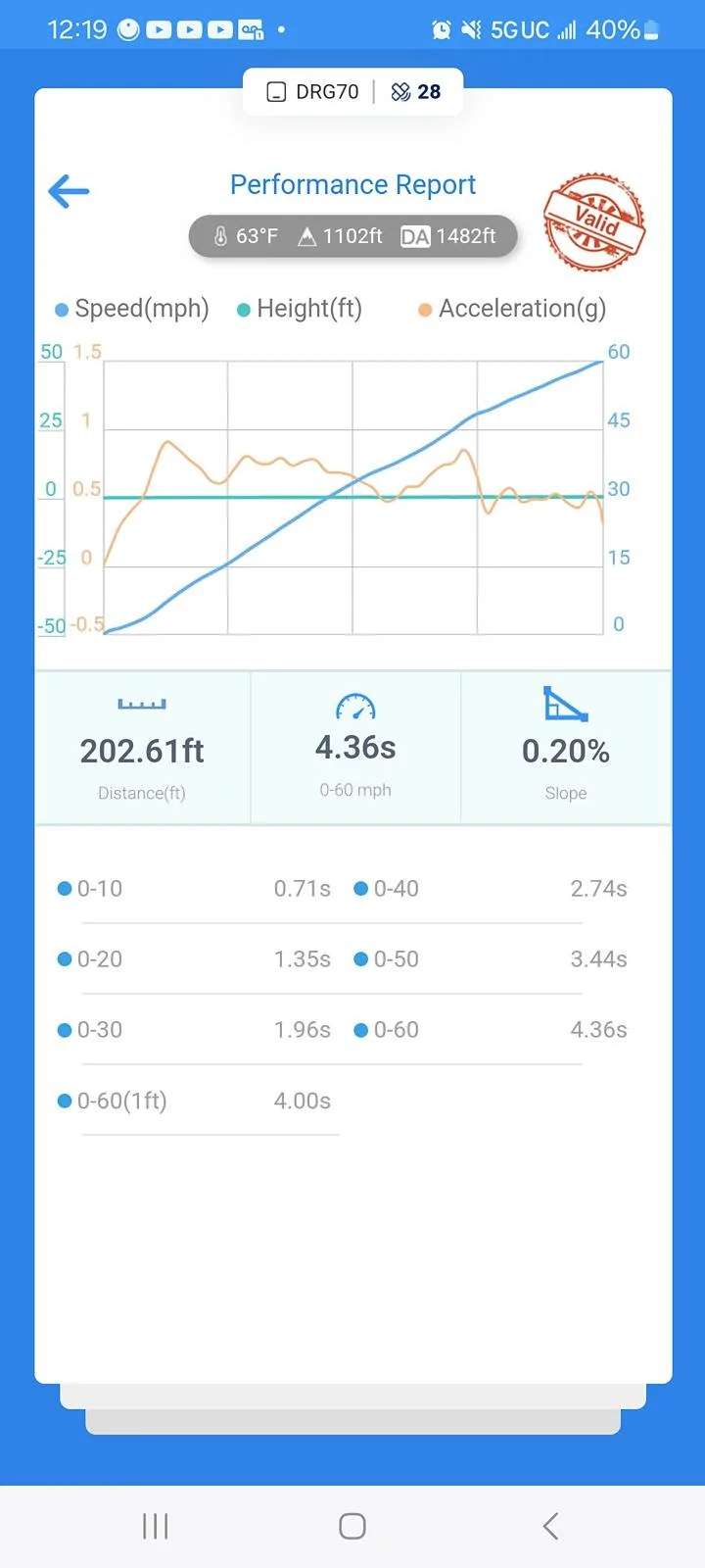

i got one really good WOT run that includes all of the times and stuff by making it up to 130 from a stop. my 60-130 shows a valid time of 12.65 seconds, 0-130 in 17 seconds. i've seen a few threads where people are getting far quicker times. it feels fast to me, but i'd like to know why or if there is something wrong.
the screenshots show everything for that one run
i'm just curious on why

Your car actually is slow compared to other fast cars. Compared to regular traffic, or cars from over a decade ago, it's pretty fast.
For the 60-130, did you just start at 60? Or did you start about 5-15 lower? That's what most people do.
You are on the slower end of stock times, but still in line somewhat.
Any time you see another s550 that's much faster than yours, the car is not stock.
Your car is really really struggling on the top end. 120 - 130 took you almost 3 seconds there. Shows a lack of power.

I think you’re within range for 60-130 and 1/4 mile trap speed for a Gen 2 Coyote GT with minor mods. Have you searched the Dragy app history for 15-17 GTs? There are several in the 12s 60-130 and they seem to have minor mods. A few in the high 11s so perhaps there’s a little room for improvement but those had better DA also.
