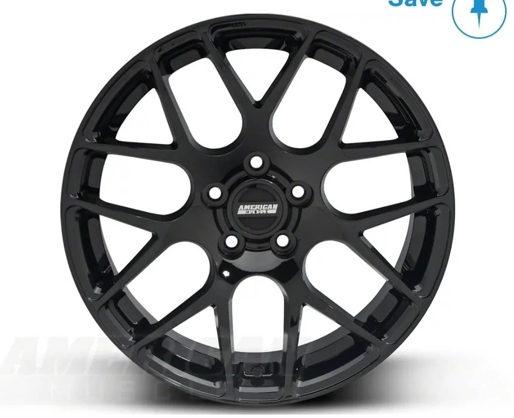

MMR makes these in a 19X11. Not exact but close. I just want to run the drag radials during summer local driving so just buying a pair of those with 305`s might be the way to go?
Does anyone make wider PP1 style wheels?
As far as whether or not the Nittos would "make enough difference to be worthwhile", that's completely subjective.
These are close and are 19X11 which would handle a 305. I just want to run them locally during the summer. I'm kind of answering my own questions. Lol. Your thoughts?
They're close, but not really the same thing.
Anyways.......subjectively, I'd bet those Nittos would be a decent improvement, especially at that width.

American muscle makes a PP1 wheel clone in a 19x10 size, and you can put a 305 tire on it. It's not ideal for cornering ability and handling, but for daily driving with a drag radial they will be fine.
https://www.americanmuscle.com/performance-pack-black-19x10-2015.html
The 555 r2 in a 305/35/19 has a minimum wheel width of 10" so you can run them.
https://www.nittotire.com/competition-tires/nt555rii-dot-compliant-competition-drag-radial-tire/
