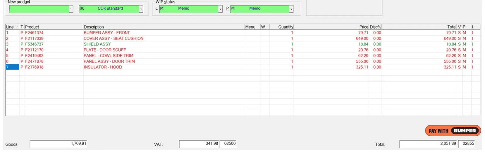

I reckon he quoted you the wrong price … :shock:
Over in the U.K. we pay more for mustang bits than you guys. I believe our trim spec is the same as your premium and they quoted me £555 (+20% tax) for my 2020 :
Still expensive though … !

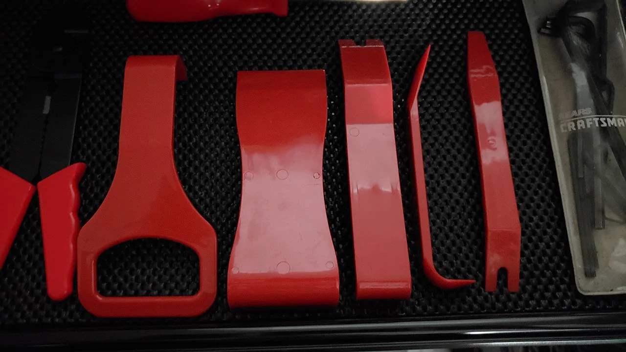

I’d suggest the hair dryer route as well. Use something rounded (like the end of a screwdriver handle) to massage it gently. If you’re already considering buying a replacement panel, trying this first won’t hurt and may save your panel.
A clean trim panel tool (they come in a set of 5 tools) works pretty good too.
Warm up surface and gently massage. Make sure to clean the tools with alcohol beforehand.
