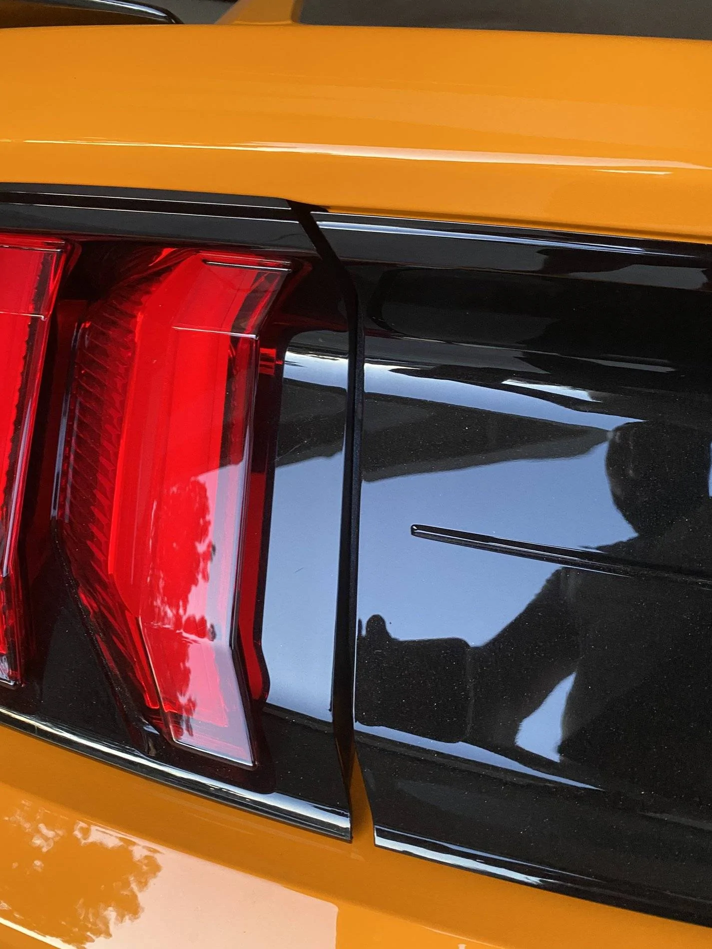

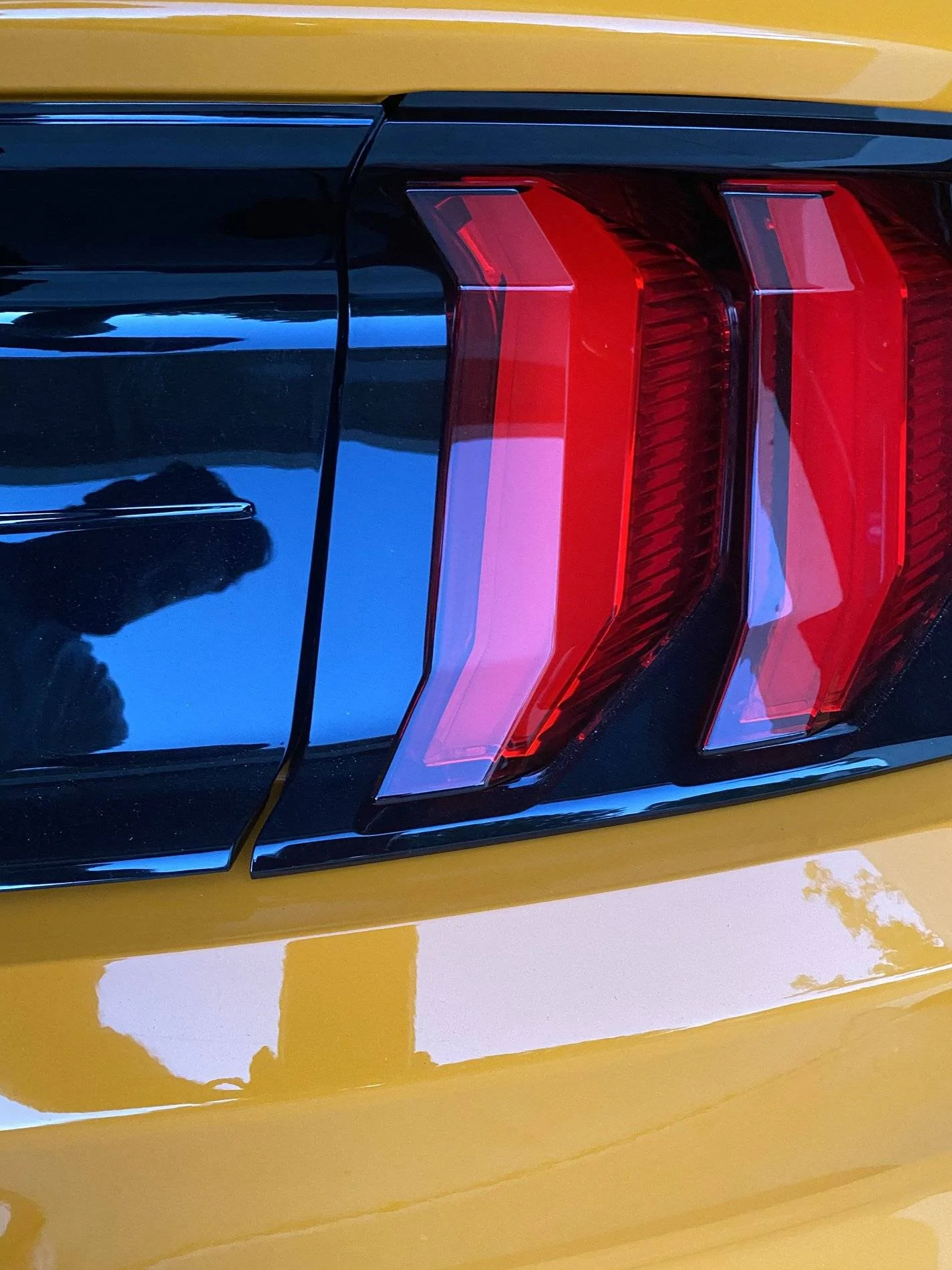

I have issue with my cars trunk lid. It has more gap on driver side and not enough on Passenger side and ford Dealerships auto body Shop tried fixing it but no luck.

Thats actually terrible. Mine is flush on both sides. Id push them to figure it out

Steeda actually just posted a video on how to adjust the trunk because some people who bought their trunk pop kits were misaligning them. Same basic adjustments for stock. Could try it yourself and see if it would work.

First check that your trunk lid is actually out of alignment vs the fenders. I wouldn't mess with those bolts unless that's the case. The issue with post #6 is the trunk's black rear panel. Could be wrong, but really doubt the trunk itself is that far out of whack. A picture further back would reveal which of the 2 (or both) are out of alignment.

Might just be the latch. I had a similar issue and adjusting my latch fixed it. Remove the plastic cover and give that a go. Word of warning, don't loosen the bolts all the way and remove them, just enough so you can move it and then re-tighten and check alignment.
