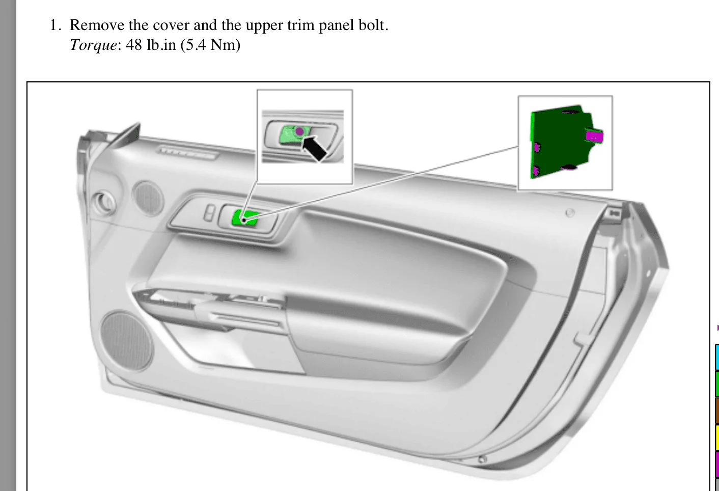

I'm trying to remove the door panels, which according to the instructions should be an easy task. But I got stuck at the very first step.
How on Earth can you pull out that cover? I can't for the life of me insert any tool between it and its surroundings. And its rear edge, the only place where it looks like one might be able to pull on the cover, is directly behind the door handle, where I can't reach it.

You use a 90 degee pick tool to get in behind the panel where I circled. Pull the handle back out of the way to gain access to here:
Use one these:
Once you get the pointed end in behind the panel pull it straight out toward you. The clips will release and probably scare you in the process.
