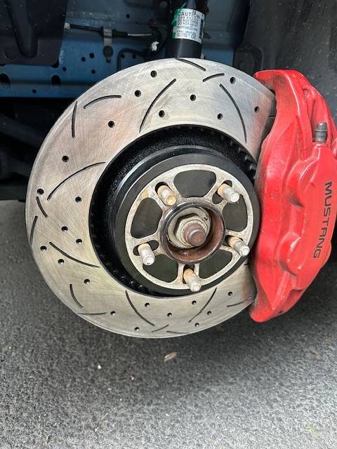

Went with slotted and cross drilled rotors, I only drove local with them this evening, maybe 45mph tops and so far so good. This weekend will push to 80-100 mph, to see how they feel with some heat in them, before i am confident enough to go all out. 🤞

Street you are fine, and they look great.

Thank you all for the responses, I think I will just go ahead and replace both the pads and rotors.
Just noting that the strange feeling is only on the passenger side front. So was not sure if it was a seized piston in the caliper, but they seem to flex in and out ok.
I am going to remove the driver side as well to see if there is a noticeable difference.
Will post up the images of both rotors as well, when I get the other side up later this evening.

Before putting the new rotors, I gave the hubs the shake test and they felt solid.
Will post up the pics of the new setup.

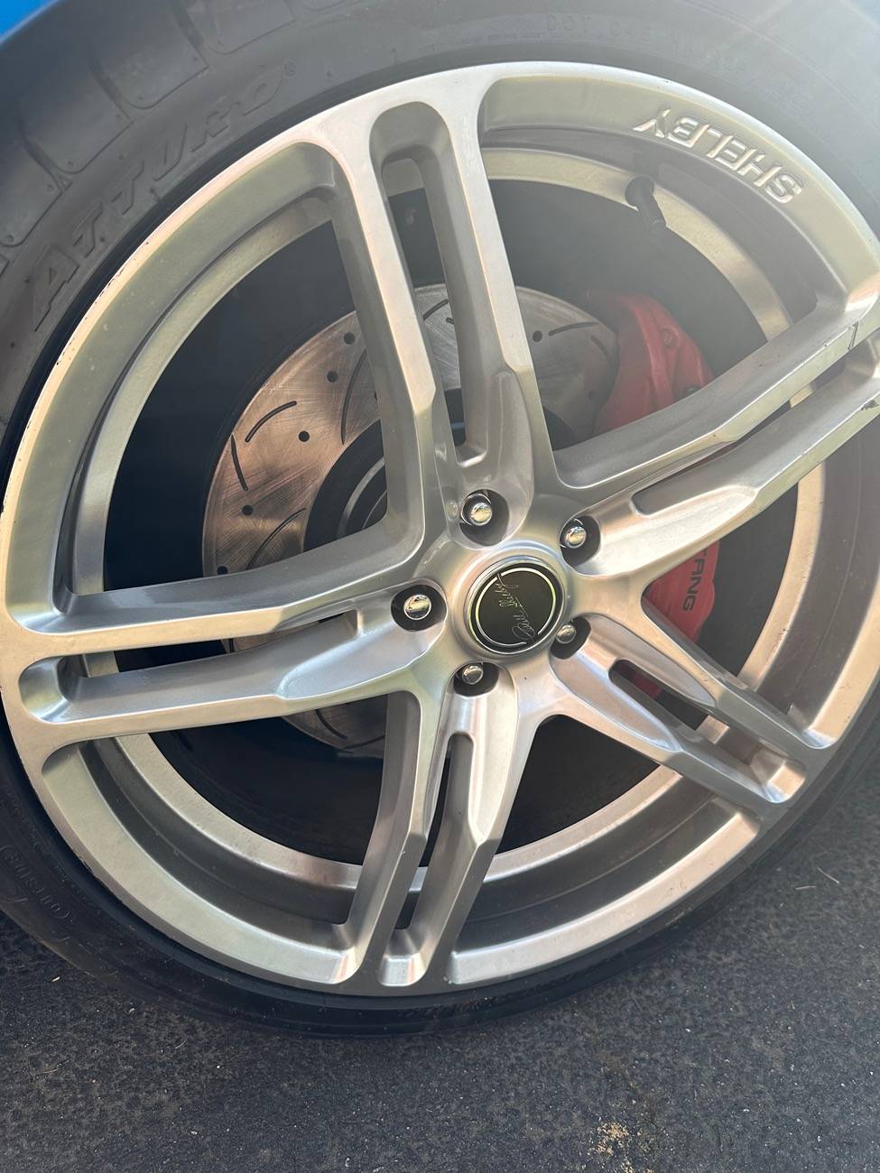

Should of taken a pic with the wheels off.

I run a small spacer to avoid the rubbing from Steeda progressives.
