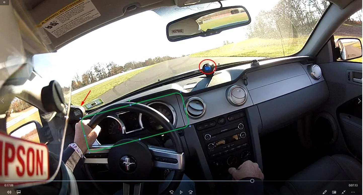

Possibly, but the dash is not far below the windshield. When I was running mostly in sport mode (my first track day. I'm now a veteran of two trackdays), I didn't have problems seeing the traction control warning flashing in my peripheral vision now and then. Probably not every time, but enough times to know I was using it. But yeah, YMMV as you said.
I can't find a picture showing me where the TC lamp might be on your car. Any chance you can grab a picture during the bulb check right after you start it up?
I have to tell you that with 45 years or so of driving where none of my cars had either TC or stability control, I am not conditioned to expect anything happening on the instrument panel when the g's are closer to 1.0 than 0.1. Never mind that a flashing TC or ESC lamp isn't going to tell me anything I really need to know right at that instant.
On the track, I will see my upshift indicator flash, but that's really about it for warning indicators. And the gauge it's part of sits above the top of the dash, either in the circle (I caught a frame where they're lit), or where the arrow is pointing to. Anywhere in the green rectangle takes active effort for me to see, and that's not something I'll be doing when I'm busy with more important matters . . . things like cornering, hard braking, other traffic, flag stations, etc.
Norm
I'm not in Spain at the moment unfortunately, so I can't take a picture right now. I tried to google for the digital display in track mode, but the photos I found look quite cluttered, with somewhat of an information overload, compared to what I use. Anyway, if I remember correctly, it's in the lower right corner, so if you were wondering if it's in a really prominent place, it's not.
I think our eyes and brains are quite good at detecting moving/flashing things in the peripheral vision however, and my display is as minimal as I can get it, with mainly the long tachometer stripe taking up room. When another icon suddenly appears and starts blinking, I usually notice that something has changed in my peripheral vision, even though I might not have time to look and understand what it is right then. After going around the track a few times and seeing it a few times, next time something starts blinking in that corner, I know enough to understand it's the TC light flashing without having to look closely at it.
