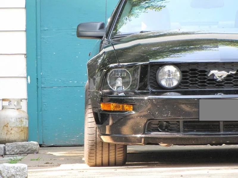

Not really sure what your options are. I wasn't going to sacrifice the fog lights on my '08 either, and cut my own brake cooling inlet holes in the lower radiator inlet pretty much directly under the fog lights. Threw a little spray paint at them and called it good. I'm not a car show guy.

I thought about cutting a hole similar to yours (in a spare lower grille from ebay) but my bigger intercooler is probably in the way. If there's no other option I might have to run without cooling or just go through the hassle of mounting/dismouting the fog hole kit each time.
Look into ways of scooping air up from underneath the car with air deflectors of some sort. Anything really low hanging would need to be easily removable for street duty, or at least capable of being tied up and out of the way of pavement contact. Otherwise it becomes another consumable.
