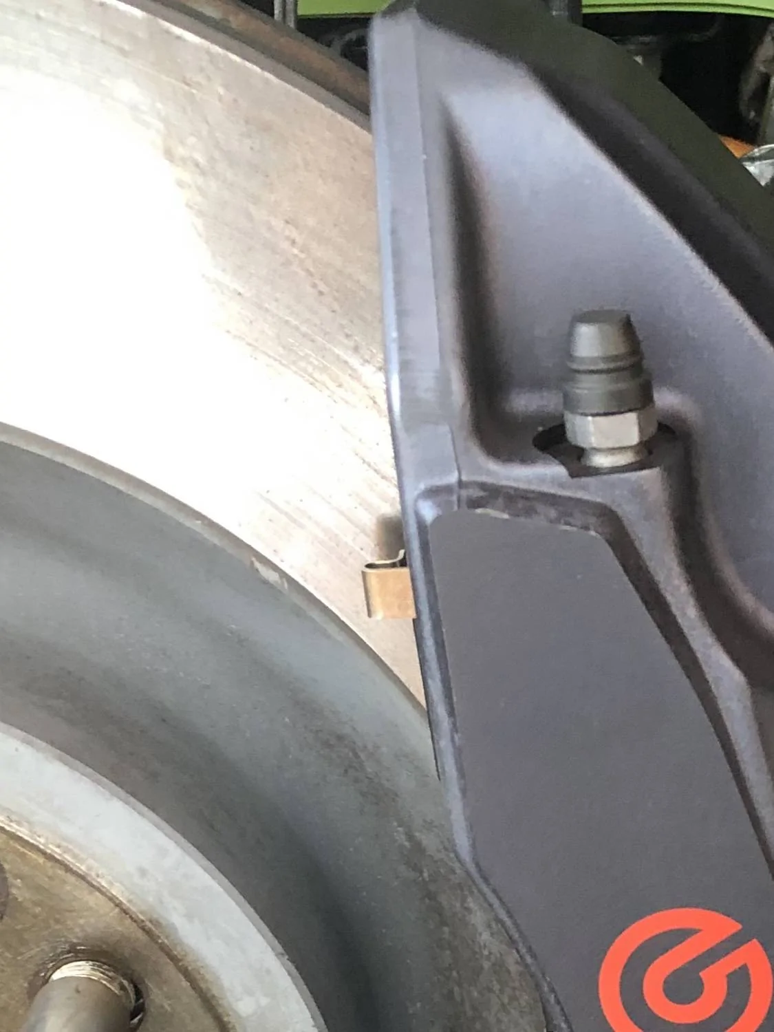

Well now I'm wondering what the hell pads are in my car.
I'm assuming those are the OEM pads? I don't have that squealer.
Yeah, I bought the car new and the pads are OEM.
I’ve just checked and both my outer pads have a squealer - left side at the top of the pad, right side at the bottom.
Hope that helps ? :like:
