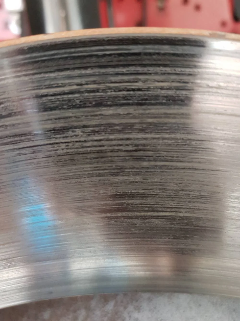

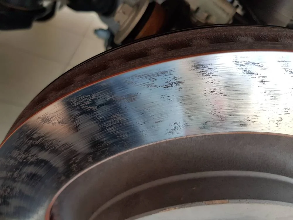

Just came back from a track day at Spa Francorchamps and now the brakes feel a little off. I did a fluid flush using Motul RBF 600 right before I went. The brakes aren't squeaking but you can hear the pads dragging against the rotor when braking (more than usual) and I find myself needing to press the brakes harder.
Decided to do a quick fluid flush again since I figured there might be air trapped in the lines. That seemed to fix the vague brake feel.

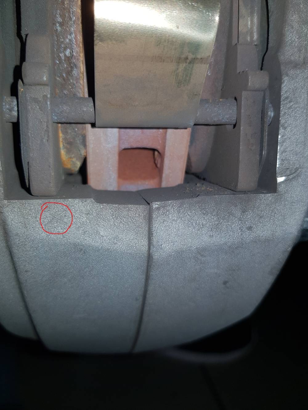

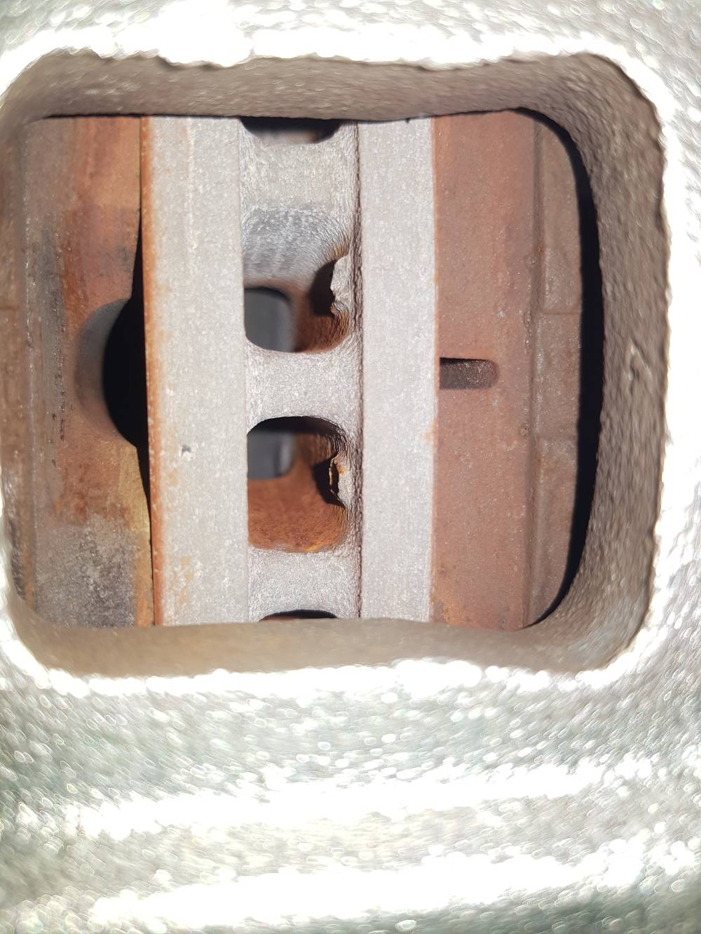

While I was at it I checked the brake pads and the rotors too. Do you think they are too worn for another track day or are they still fine? Rotors seem a bit scored, not sure about the pads I noticed 2 'X' marks on the caliper, are those wear indicators? Is it fine until it's past the X?
What rotors and brake pads would you recommend for a car that sees a couple track days a year (<10) and is mostly used on weekends? Should I stick to OEM or something aftermarket? Perhaps something that can take more of a beating but not too much more dust or noise. I have a performance pack 2017 Mustang Ecoboost.
