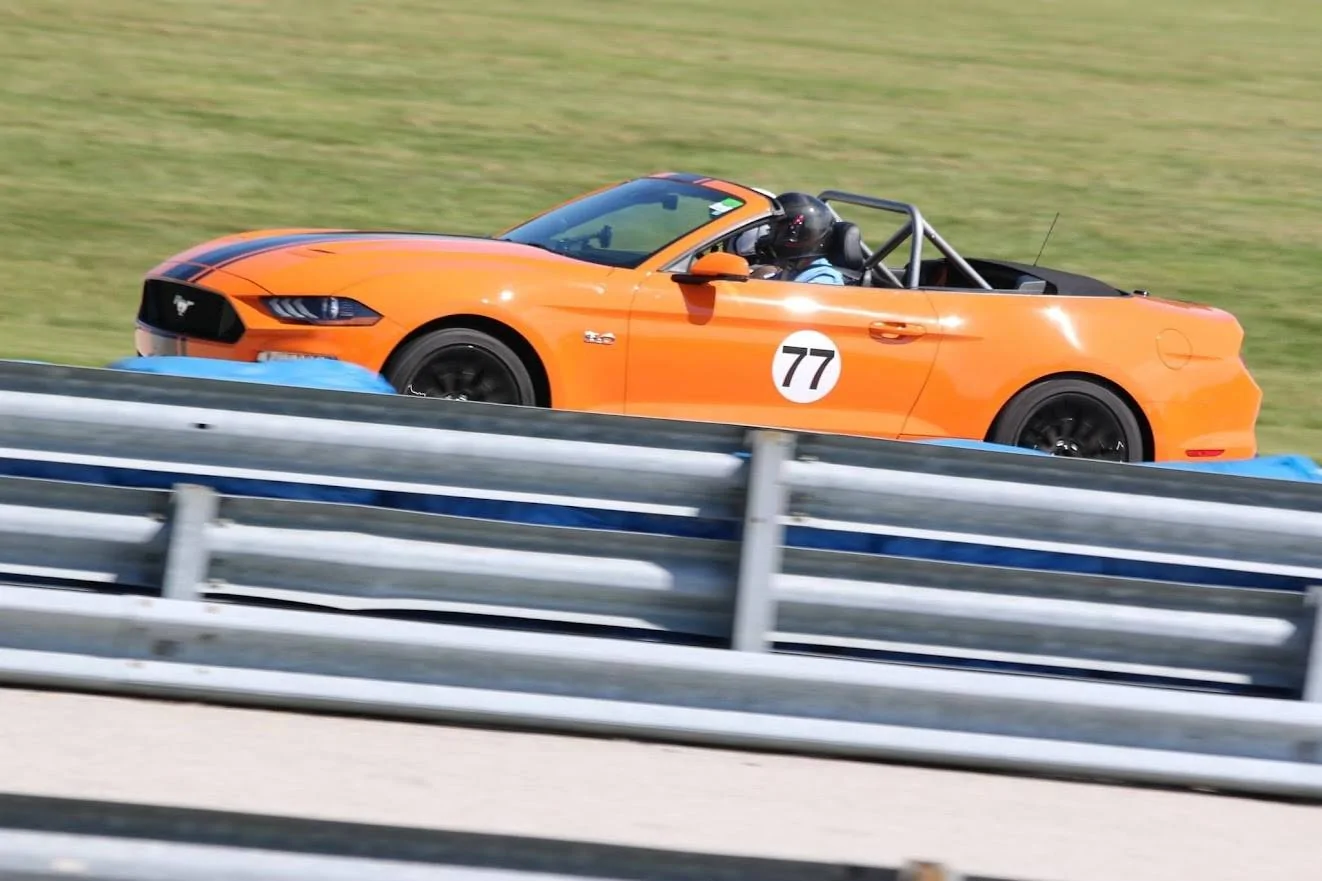

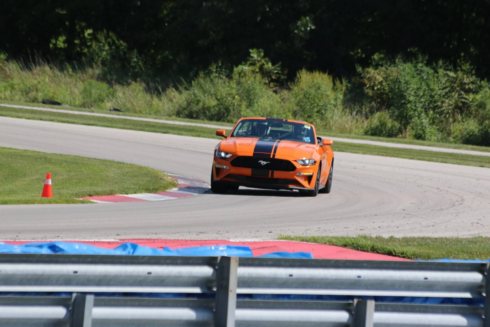

Here's what I bought about a 1 1/2 years ago for fun drives and track. I was going to buy new then found used under 4k miles: GT Premium Convertible, Performance Pack I, group 401a upgrades, added a roll bar and track level brake pads. Drove on my mostly stock setup for at least 4 HPDE's no problem. Have no idea how to find a non-black interior tho.

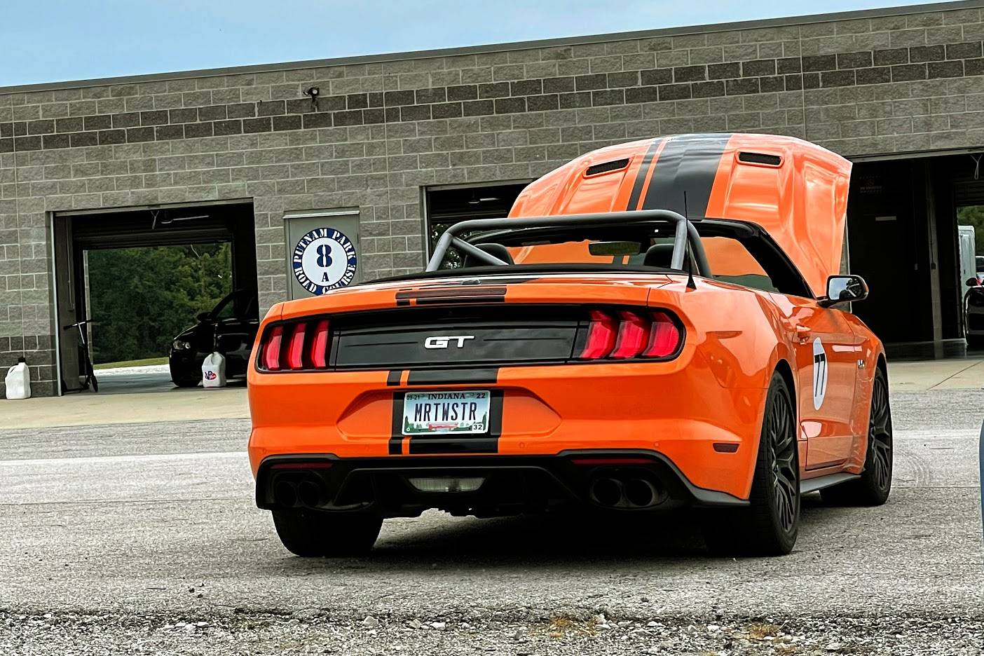

I'll say this about the Watson 4 point roll bar, it's really nice but while they say it's removable, it's a bitch to get in and out with the door panels. My gal has no fuss with leaving it in and doing road trips, if you want to have it in and out unless your a real mechanic find a shop that will swap it for you each season.
Oh has Magneride too, great for track and being Novice.

It's dangerous to drive a car with a roll bar in it if you aren't wearing a helmet. Especially if you have no padding on the roll bar. I would encourage you to take the time to remove the bar between track events. I realize it's a pain to remove and reinstall, but that's what I do, even though I have roll bar padding on mine. I want to be as safe as possible, and you can't control what the other drivers do.
