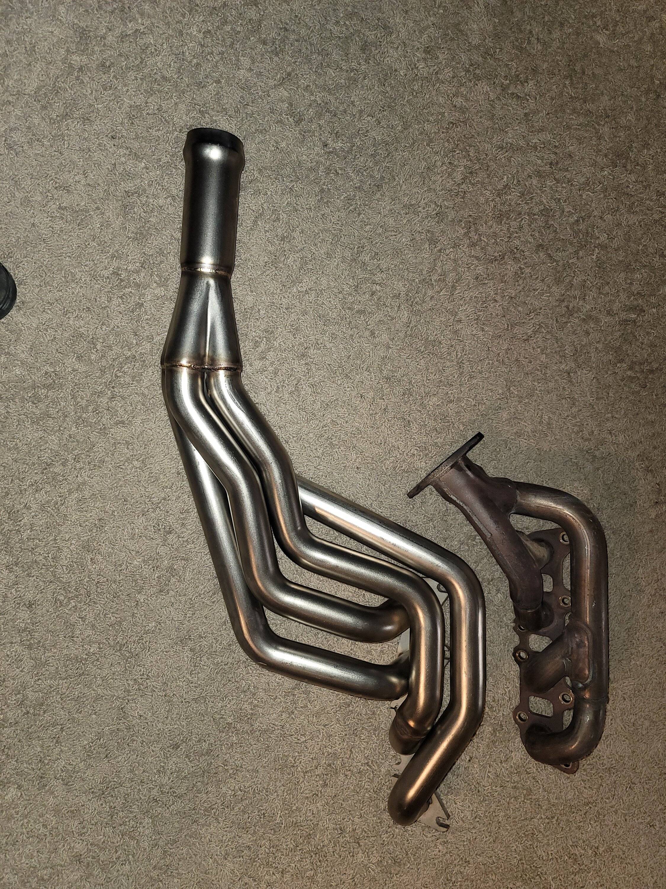

I dont know what everybodys complaining about. My brother in law and I did mine in a weekend on the ground with jack-stands. There are some tight spots but nothing to bad. I do have a pretty good set of tools and an engine support used for holding an engine while doing the motormounts. It sounds way better. The stock arent that bad and are a Tri-Y design. I went with the 2M headers and high flow cats. They also came with catless pipes as well and now that my county just did away with emmision testing, I may install those now. Heres a picture of the stock vs 2M pipes.
