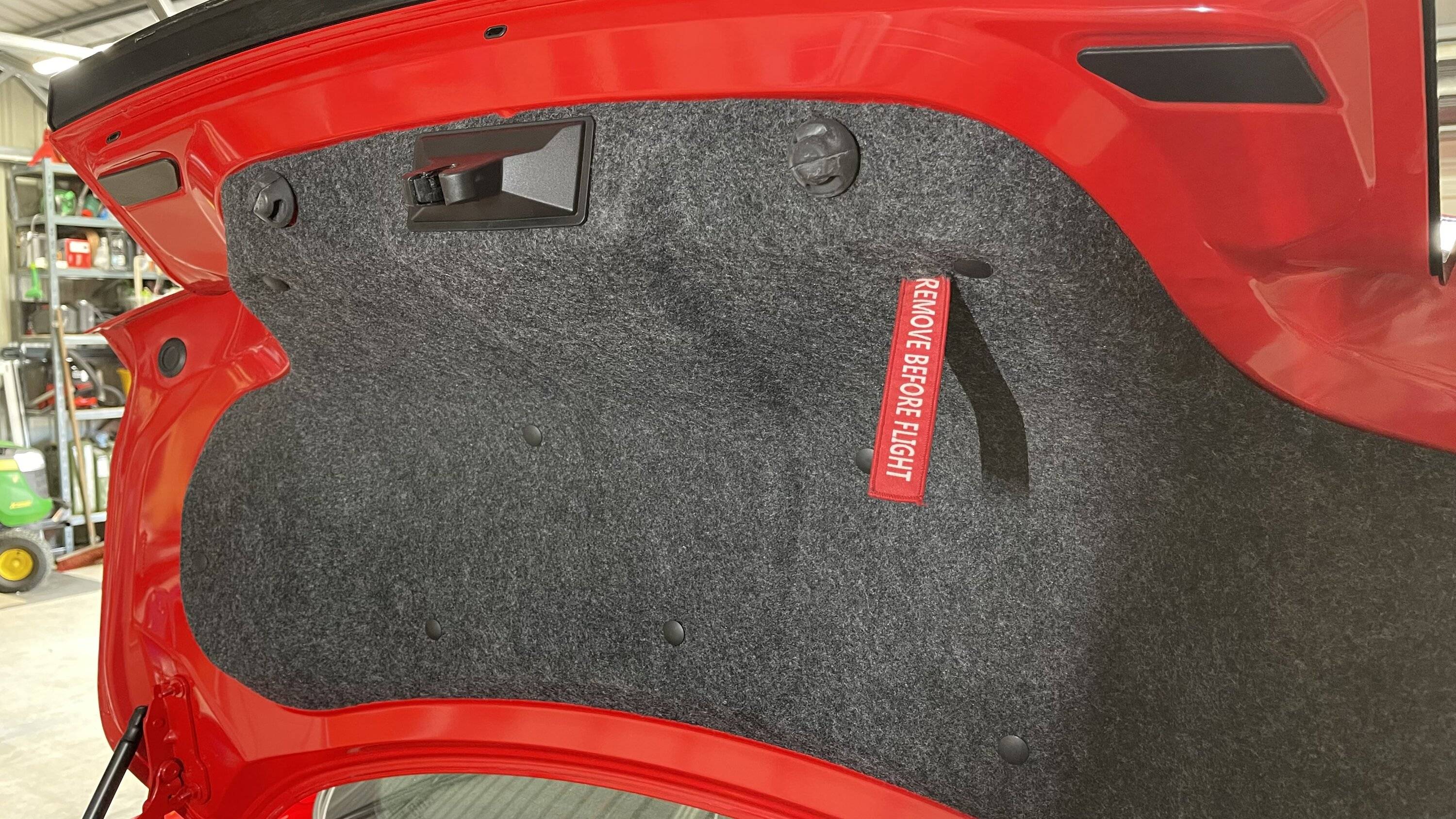

I used this method too. Worked fine until I added the Steeda Trunk pop kit. Now pulling the strap brings down the trunk but I still need to push it closed.
I just installed the Steeda Trunk Pop Kit- I replaced the "Remove Before Flight"- with 550 cord- and still have to touch the truck- I do like that one pulling from the center..

I did this on my 2015 which I sold last year, and when I bought my 2022 I missed the strap I had made.
Small enough to let go when gravity takes over and closes my truck with a PP1 Spoiler with wicker bill no so rough. It’s simply a keychain where I made the bolt hole bigger.
works like a charm.
BTW I was a Blackhawk crew chief, and on preflight I did “pull” on the remove before flight gear. Seam natural to me as I’m closing the truck. lol

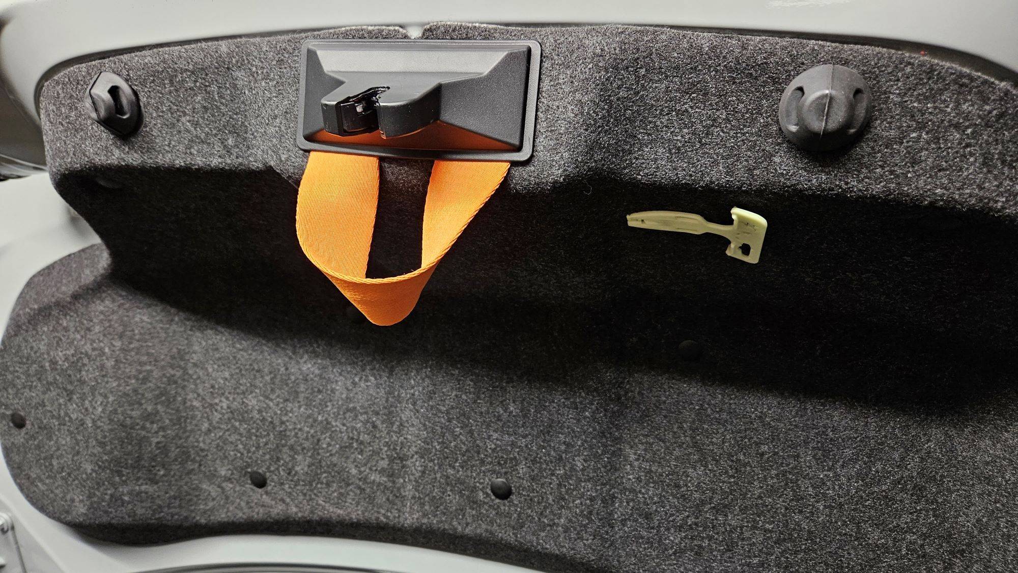

I had a different approach to solve this problem. Trunk lock, behind the black plastic cover already has two screws and nuts. I burned two holes (left and right) to the strap, pop out the plastic cover, remove the nuts, pass the straps newly made holes through the screws, put back and tighten the nuts, put back the plastic cover. This way no hardware needed, only the choice of color strap.

Nice, that's a really neat mod! I reckon this one might be the go for me 👌

Thanks for the heads up! But yea, I agree CYBERDIM's solution is neater with ore scope for personal choice of colour etc. And I like the location of the strap in the middle.

Thanks for the ideas guys, I went the diy way as well. Getting the plastic latch cover off was the hardest part. Used a hot poker from our fire to burn and seal the holes in the strap. Added extra nuts instead of removing the stock ones. Went for the super stealthy strap colour and length. I’m happy with it. Works perfectly.
