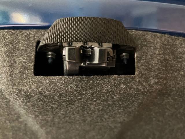

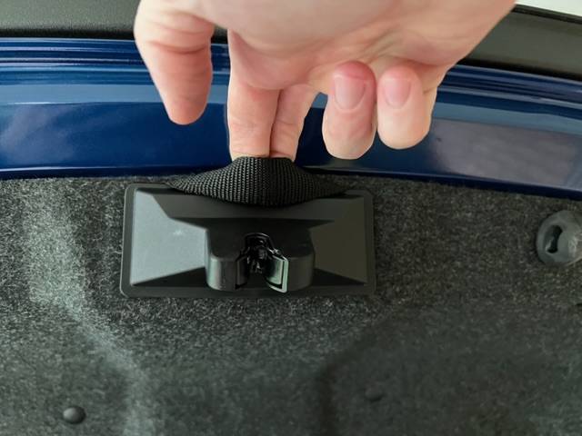

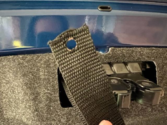

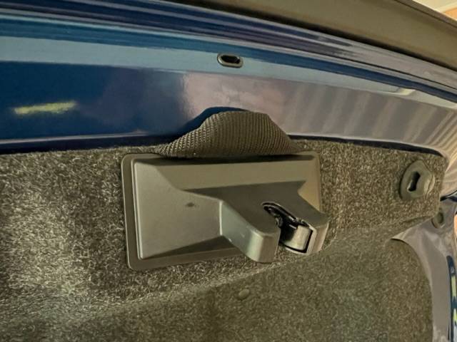

Thanks for the ideas guys, I went the diy way as well. Getting the plastic latch cover off was the hardest part. Used a hot poker from our fire to burn and seal the holes in the strap. Added extra nuts instead of removing the stock ones. Went for the super stealthy strap colour and length. I’m happy with it. Works perfectly.

1- Sorry, not sure. Held it up in place once I’d removed the cover, took a punt and cut it. At a guess, 20 to 30cm
2- Sorry, not sure again. If I had to guess, 10mm. Weird on an American car but I don’t have weird inchy nuts and it worked out just fine :like:
3- Nope. Trim piece was loose enough for the strap to fit under, but tight enough to stay firmly in place during use.
4- None at all. The struggle I had getting it off in the first place convinced me it would stay on through use, and this has proven to be correct.
