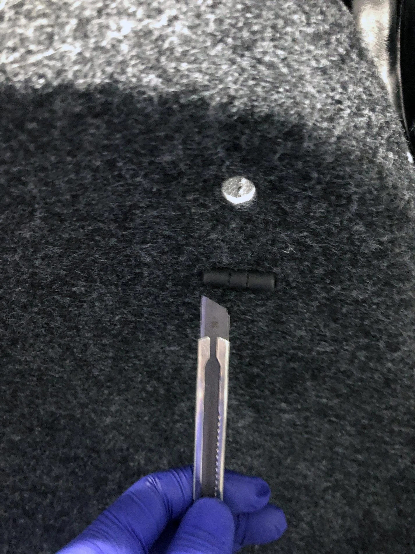

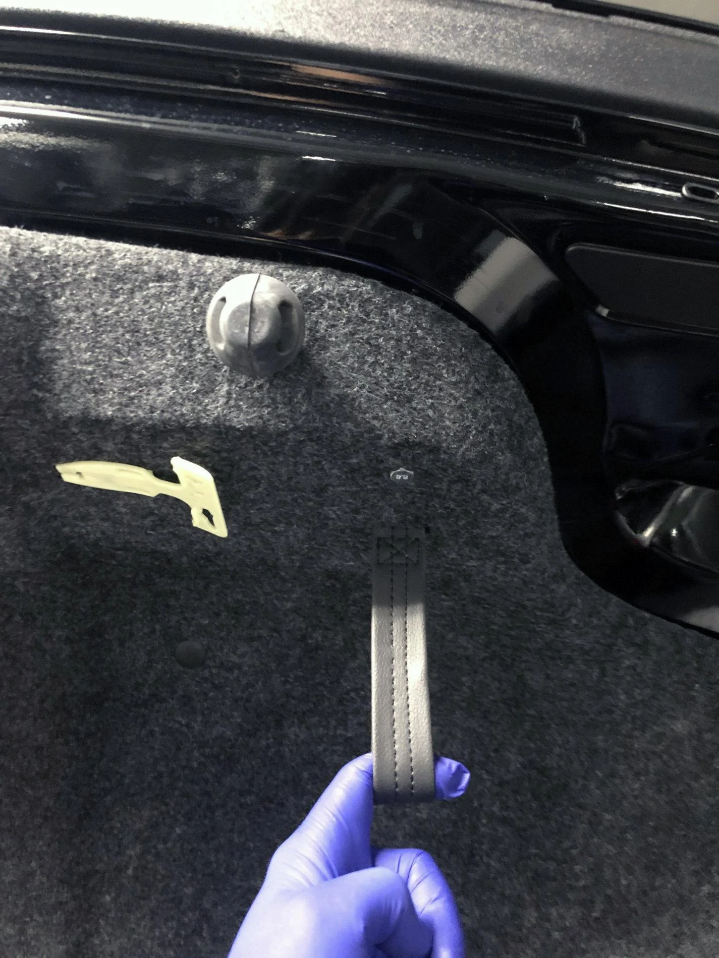

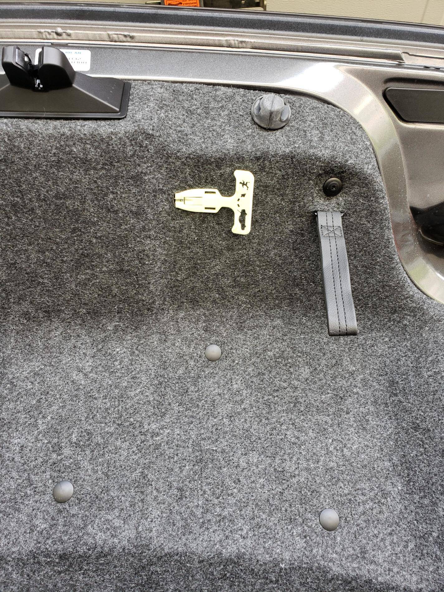

Our Mustangs don't really have a convenient spot to pull the trunk down without leaving fingerprints on the trunk, trunk lid, or spoiler.
I have the PP1 so I used to hold the bottom of the spoiler, but I needed something solid, something that feels like I'm not causing any harm to the car.

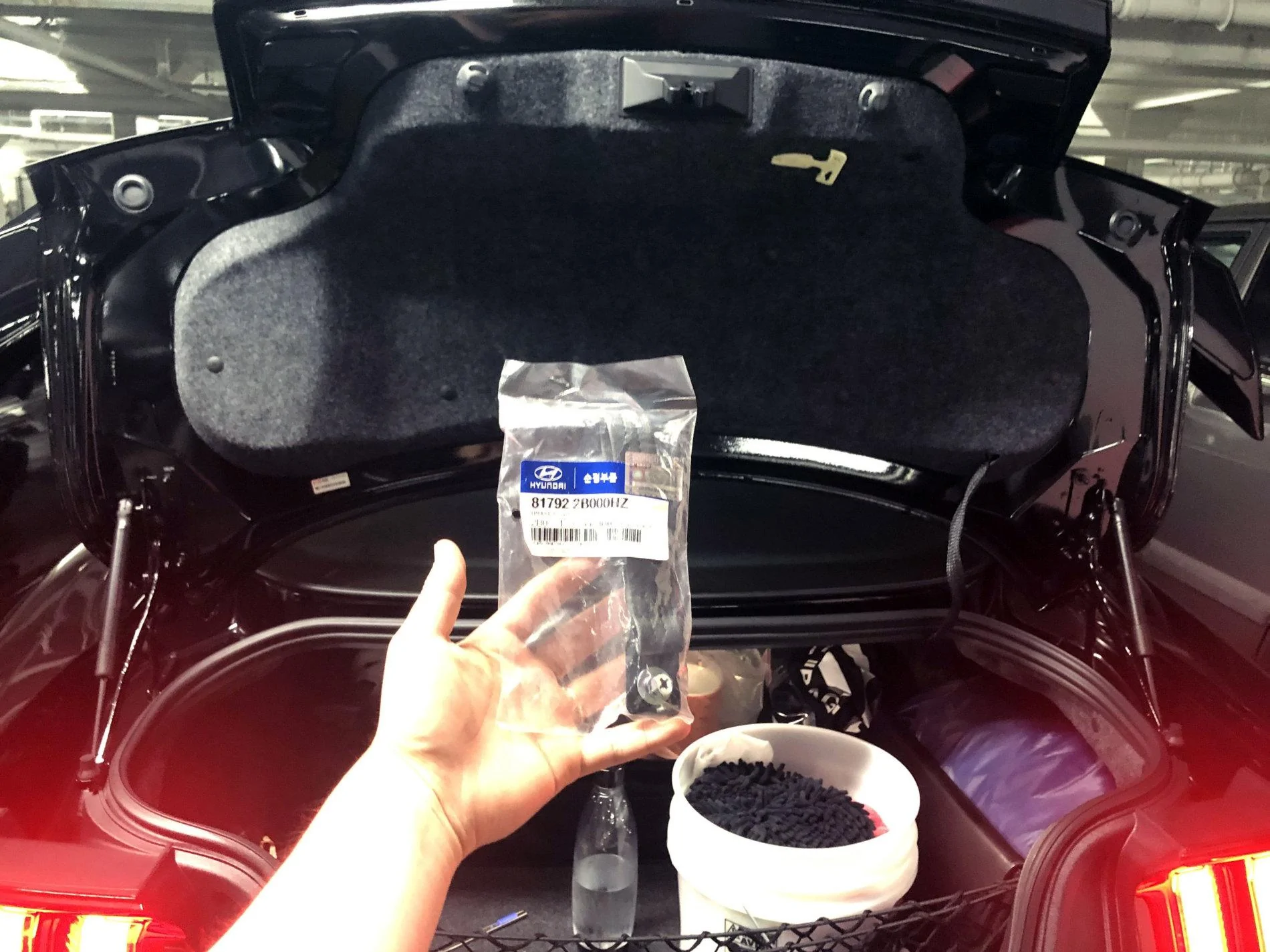

So I bought this part from Hyundai Motors, and the part's number is: 81792 2B000HZ
Luckly, my girlfriend was able to deliver me the part straight from the country of origin, Korea,
but it's still buyable on the internet for relatively cheap price.

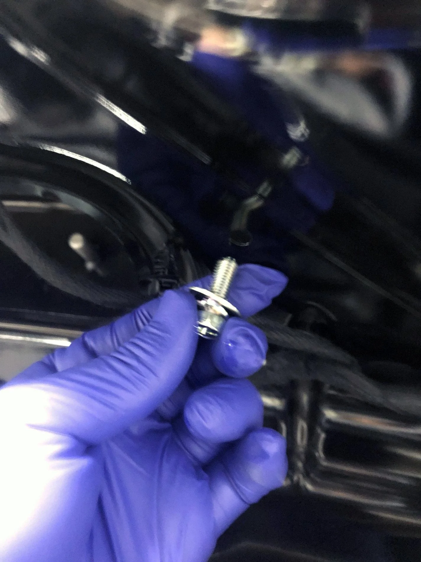

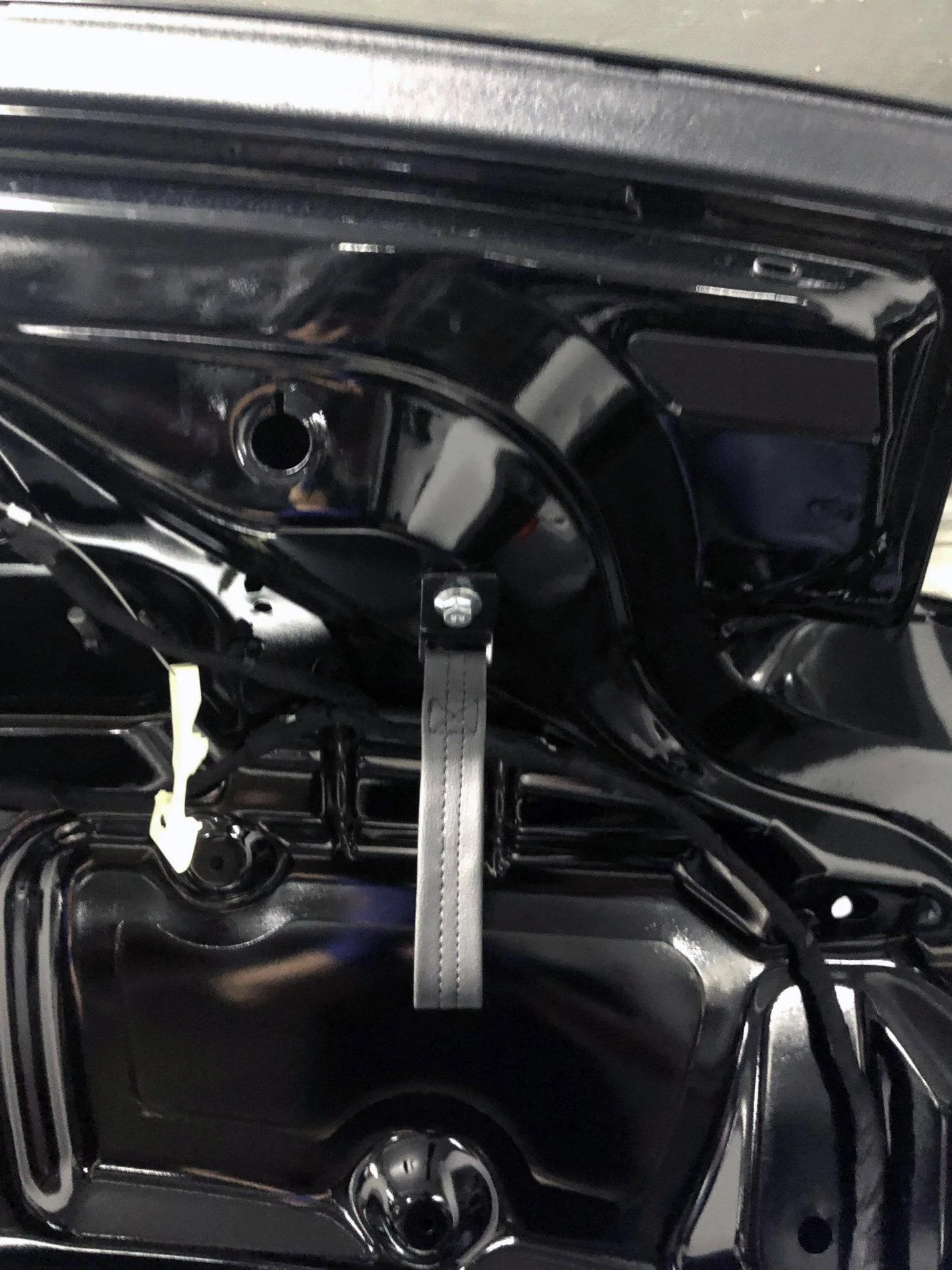

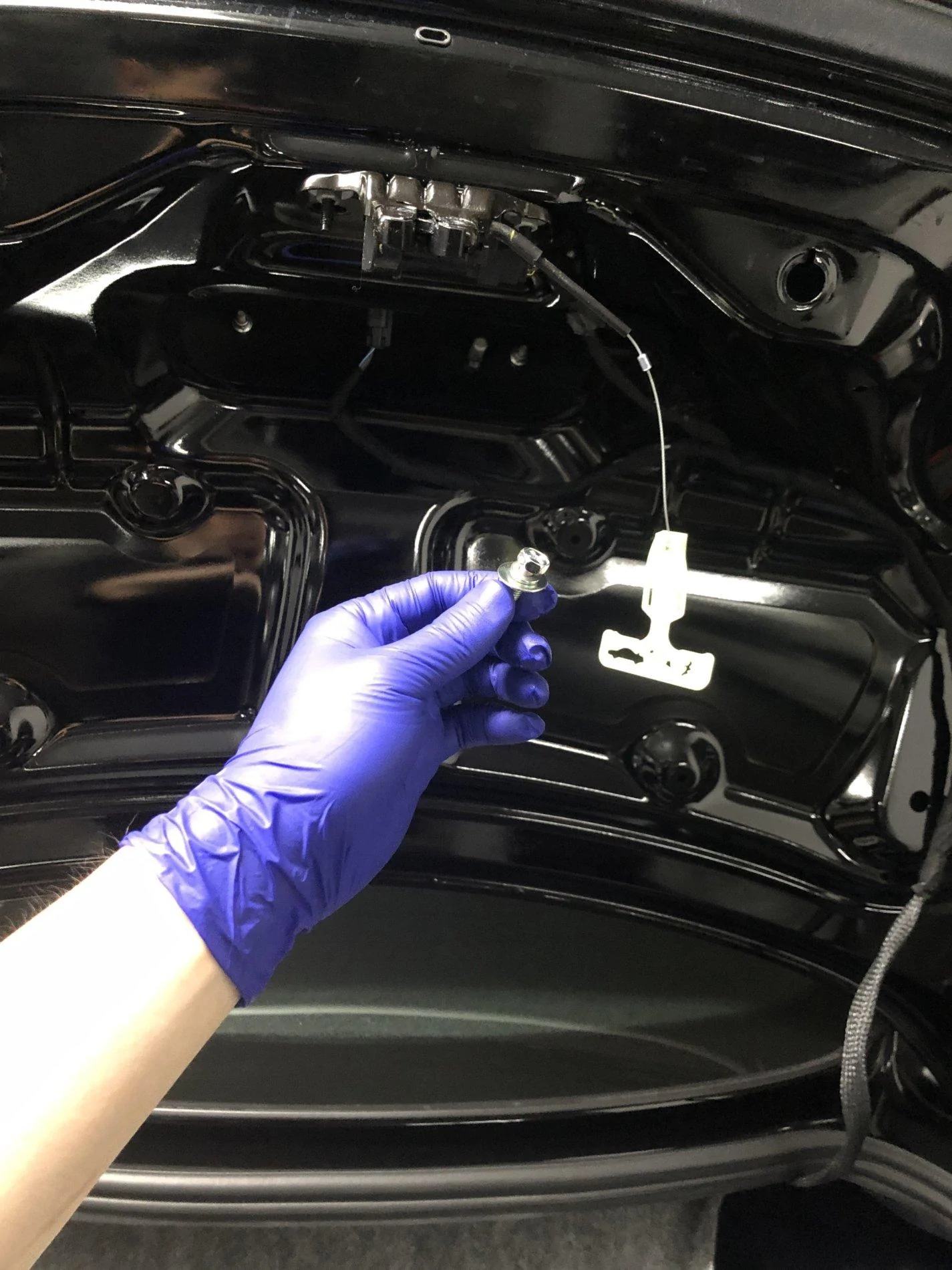

The stock bolt that came with the strap is M6-1.0 size and does not fit the trunk liner tab hole.
I purchased a slightly bigger bolt from Home Depot for about $1.50 and fit great.
This mod requires a small alteration on the trunk liner.
I measured how far apart the bottom of the strap is from the bolt, and cut according to the length.
Ta-da
It took about 5 minutes to save hours of polishing job that would've been required to get rid of the scratches on the trunk or trunk deck lid.
Ironically, the strap feels very OEM and it's definately something that should've been included on the car from the factory.
I hope this helps!

Here's mine. I fished the bolt from the inside. That rubber bumper in the photo is threaded into a big hole.
I may add a small "t" handle at the end of the strap to make the "yank" easier.

@Min Ahn:
I hope you're still following your thread. The Hyundai leatherstrap - can you measure how long it is?
Also since installing it - any wear or tear in the trunk liner as a result of using the strap?
Thanks :)

Hello, I hope you’re doing well given the situation the world’s going thru.
The strap itself is about 14 cm long, and the trunk liner is still in the same condition since the day one.
Thanks.

Thanks and you too!
Great info and thanks a lot! - feared it was too long but it is just perfect!
As a bonus info in case someone else in EU wants to do this DIY install, I can tell you that the European part's number is 81792 2B000KD

Is that hole tapped? If not, did you guys tapped it? I was thinking to tap the hole, and just install the strap from the outside. If the bolt is visible, it wouldn't look any worse IMO. The other option is to use a flat hex/philips bolt and a nut on the inside, and then just the slit on the cover. It'd look cleaner, no?
